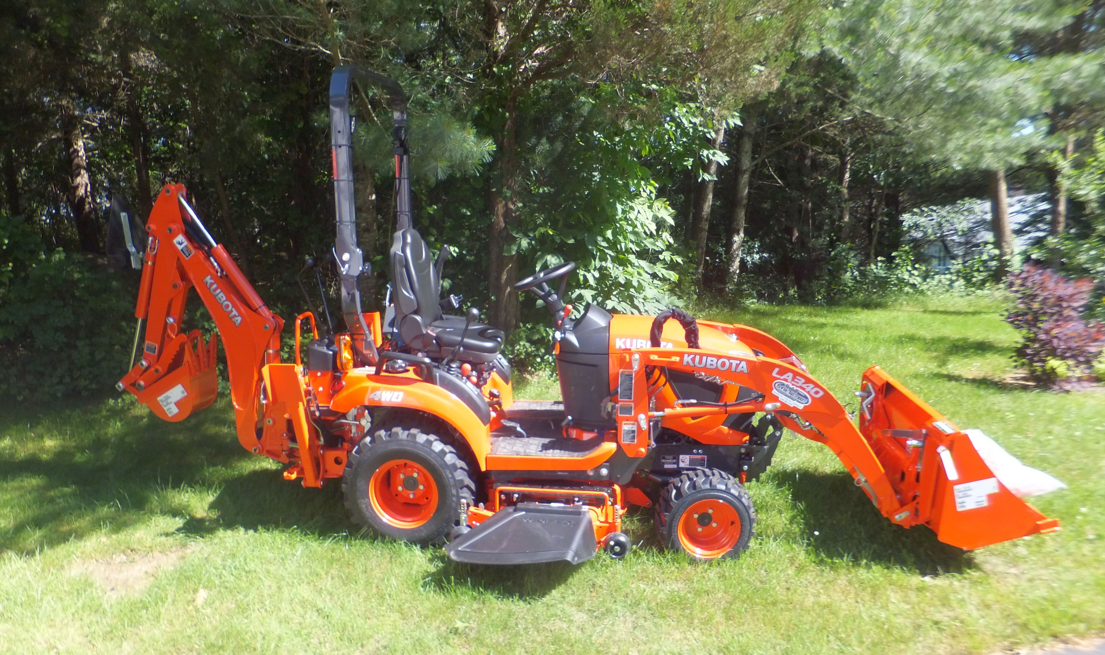

I just took delivery of a brand new Kubota BX-23S, complete with a hydraulic plow and backhoe. So far it sure seems like an excellent machine! When they delivered it, after cutting the lawn, I went down back and tried my hand at experimenting with the backhoe. It's fairly easy to operate, but I can see it's going to take some doing to actually get good at it.
My question is about digging a trench. I need to dig one between two buildings for a footing. I can see how you'd start the trench from each building toward the center, but at some point, you'd be straddling the trench with no way to get out of there, right? Is there some technique for this that I might be missing? What's the right way to do this? Thanks!

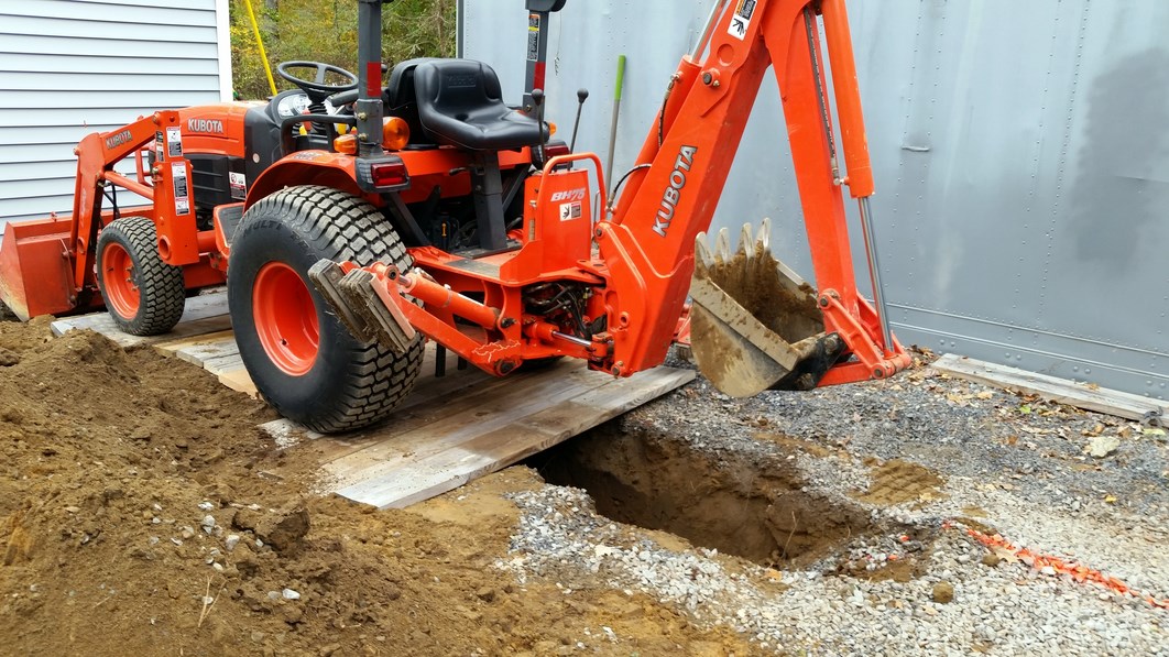

I had to eventually join sections when digging a rectangular foundation for a new building. I also had to contend with an existing 12x12 shed that was coming down after the new building was complete. My BH bucket is 18" which is too wide to drive over so I used 2x10 and 2x12 pressure treated planks to cover a section of the trench. As I moved along digging, I'd take planks from the front and move them to the rear of the tractor.
I like that combo machine and especially the wide turf tires. The plank method is good for straddling the ditch to keep the sides of the trench from falling in - especially when the backhoe bucket is wide in relation to the tire spacing. But I'd be a little bit leary of driving directly across those planks with the full weight of the tractor over the ditch. Especially with a larger machine. Even covered with 3/4" plywood I wouldn't feel confident that any kind of normal building plank would take the weight of a larger tractor for crossing the ditch.
The original poster also needed to know how to cross a ditch he had been straddling to dig. He saw that at some point he was going to end up with one wheel on each side of the ditch. And although the planks work for straddling, maybe they don't for crossing. I've been in the exact same position many times and still haven't worked out a method that I like best. What I usually do is to dig from each end of the ditch towards the middle, and then when I get to the middle I'll cross to the side I'll want to be on when done and back the machine up close to the ditch but set at about 45 degrees to the trench instead of being perpendicular or parallel to it. With that angle I can dig with the backhoe for a ways and then I set up at 45 degrees the other way and finish the ditch. This is safe, but not a perfect solution because sometimes I will end up with a wider trench in the middle than at the ends. No problem; ditches are easier to fill than to dig.
