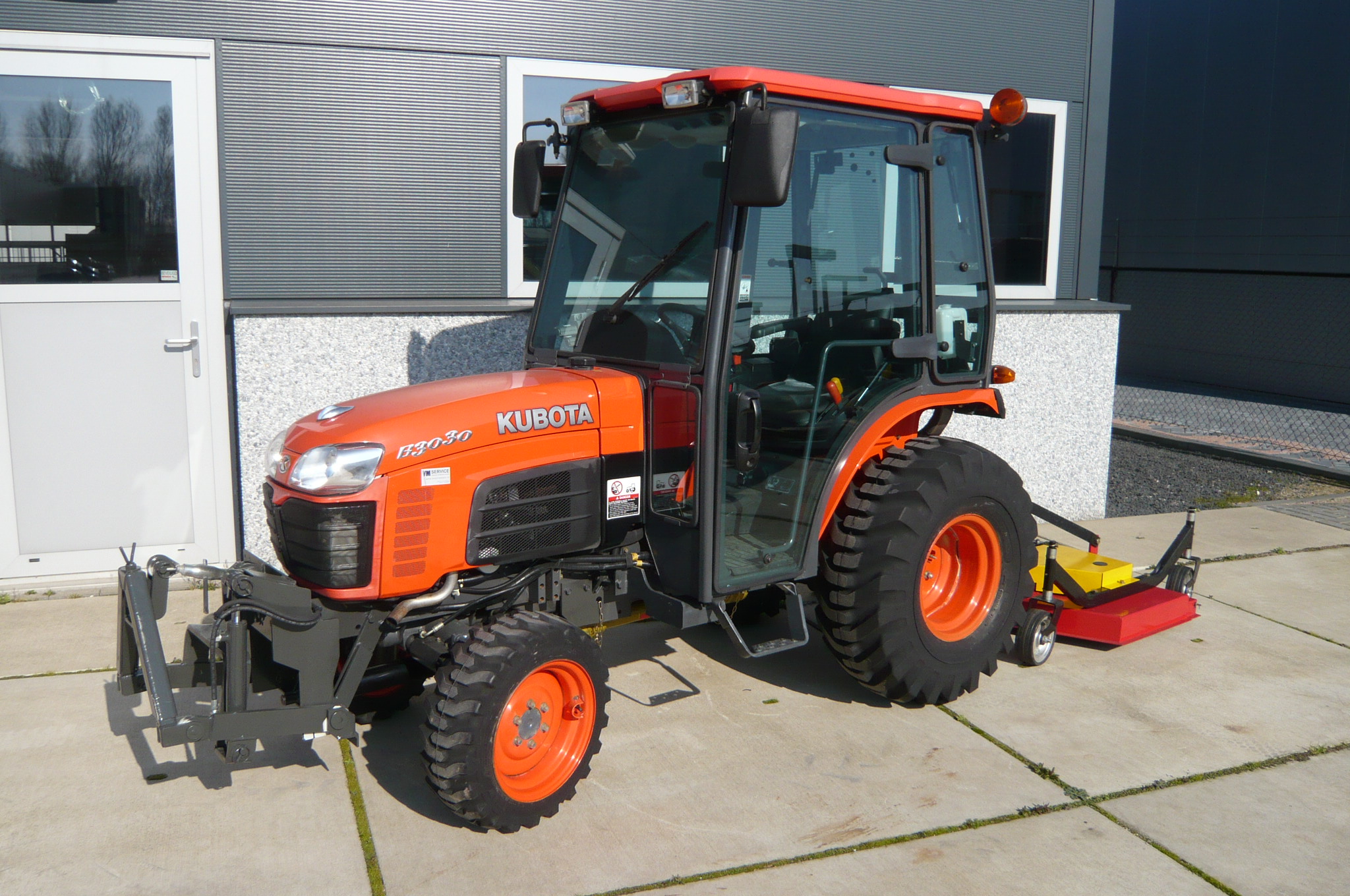

My name is Edward and I live in Norway. I have had a Jonsered hydrostatic lawnmower for several years but this machine is to small for our property.
Last week I have bought a realy nice second hand (65 hours on the clock!) Kubota B3030 HST (hydrostat) with cab, which will arrive at my place on monday 24th/3. Yes, that is tomorrow!
But... a minor problem - there is no user manual! Can somebody help me with a pdf file of the owners manual? I also would be very happy with the pages showing me how to start and drive this thing and how to operate the PTO levers etc.
All your help will be appreciated! Thank you in advance!
Kind regards,
Edward
Attached a picture taken at the dealer.

Edward, if you still need it, I could scan and email some pages from a L3130 manual ( very similar tractor, I believe ) that I am in the process of buying- I have the books, but not the tractor at present. I would be interested to learn how much that tractor costs in Norway- it looks like a wonderful example of a L3030, by the way. My impression of Norway is that cost of living is very high, but I have never visited- yet.

Love the front hitch, we don't have them in the states here, good looking tractor too. Stanley

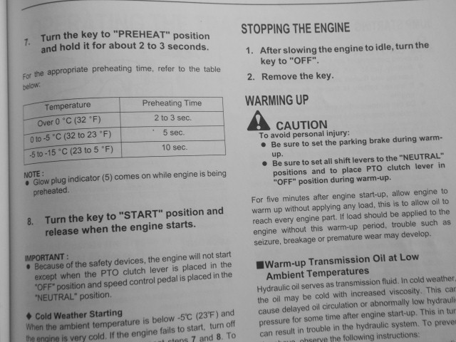

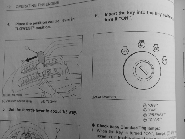

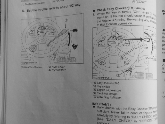

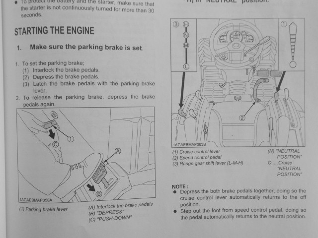

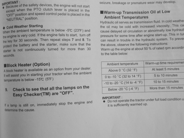

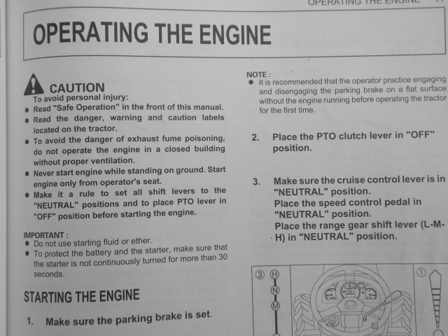

I took some shots of my manual. This will get you started: it's about starting your tractor.
I never start my B3030 in neutral or with the parking brake on. You can start it in gear. I like medium range for most things.
