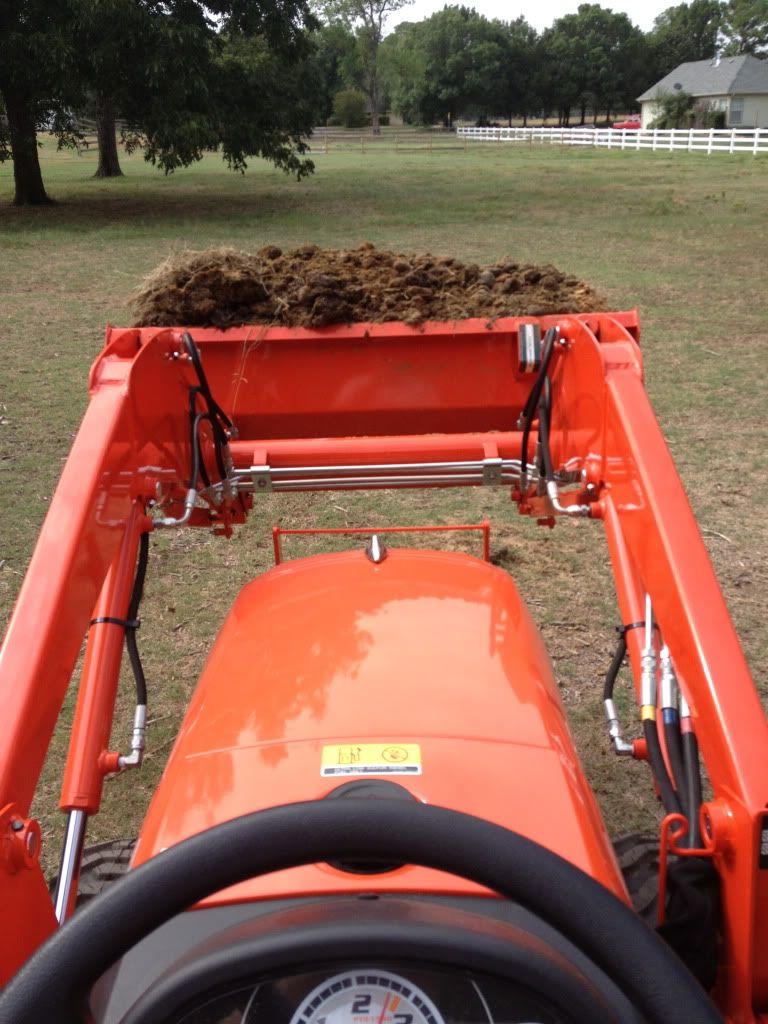

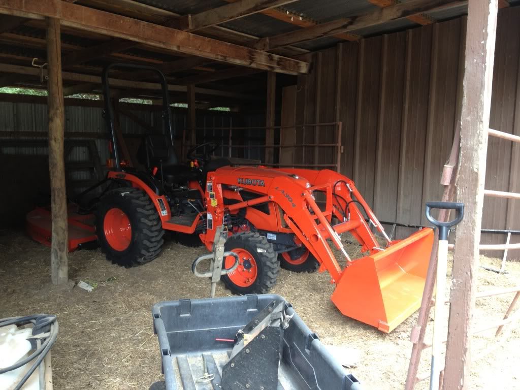

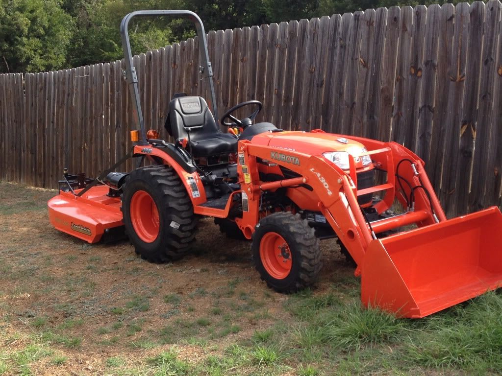

First real tractor showed up this morning!
Put 2 hours moving compost/dirt already
I did have a question about the field mower. It makes a fairly loud vibrating/scraping noise hike running is this normal? Don't have any experience with field mowers just lawn tractors
Also does anyone have a good critter deterrent to keep mice from moving in when not in use?

congrats on the new ride
glad you are putting it through its paces
I don't believe the finish mower should be making any scrapeing sounds at all
I would try to see what might be hitting or binding

Very Nice Rig. Let us know how you like that brush cutter. Is it a LP1548 cutter?
   / New B2320 showed up today! #7
Your Brush Cutter should not make any metalic noises at all. Don't run it that way, investigate to see what's hitting. The ends of the blades will just miss the sides and rear of the deck by an inch or so. Maybe the side has been pushed in too far and being struck by the blade ends. You should be able to look under it and see where it's hitting.
Or maybe it's a problem with the driveline. Kinda hard to tell by your description. Those cutters are smooth as glass when running.
