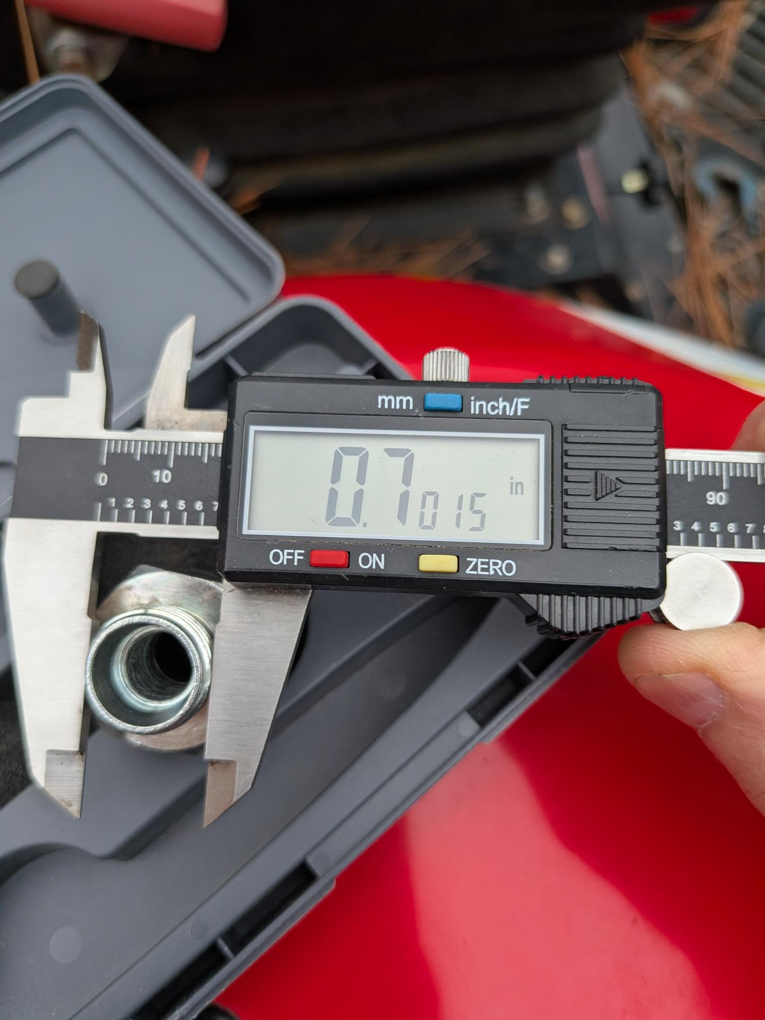

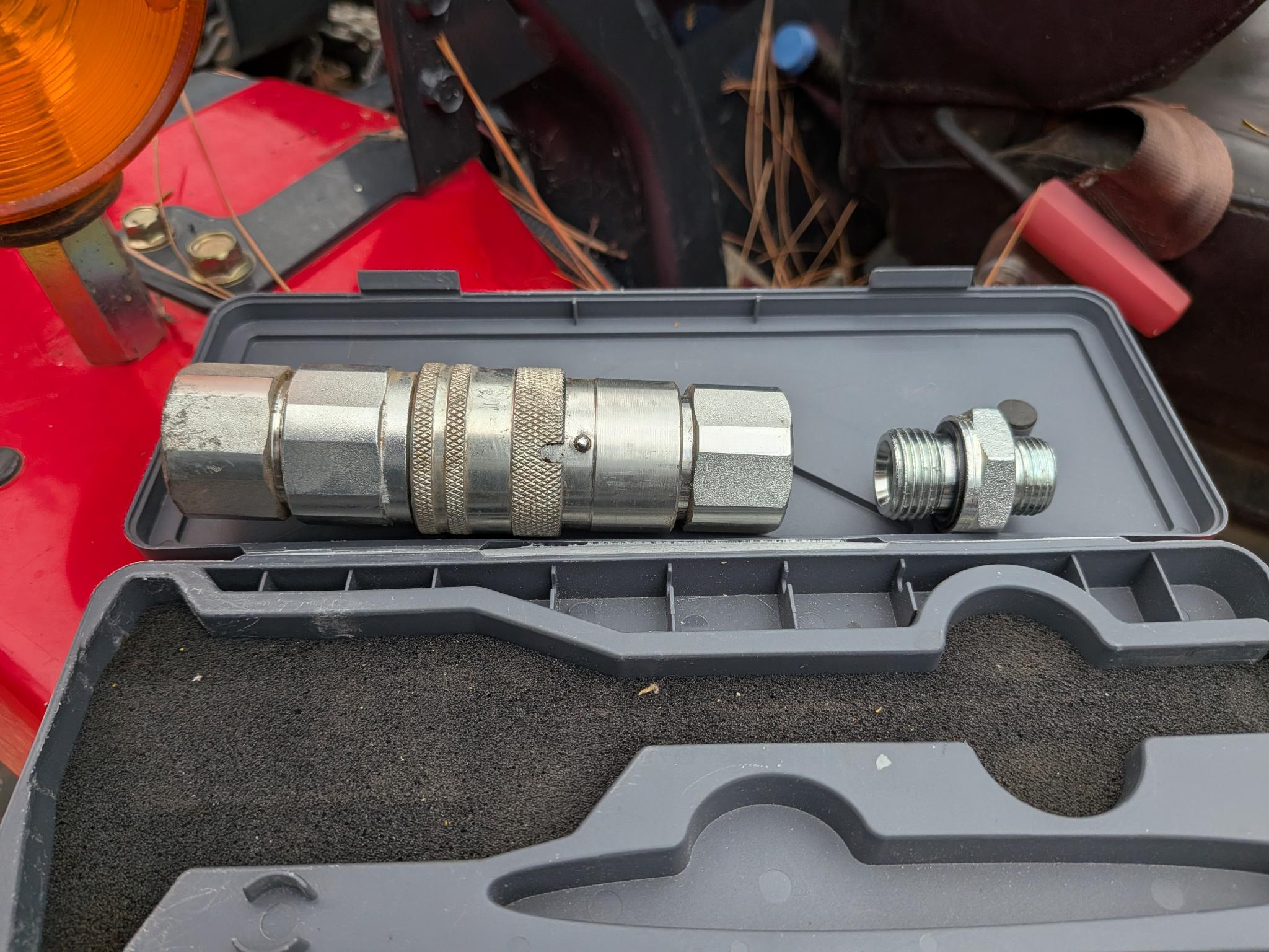

The auction attachment came with 3/8" hoses and flat-face connectors, so I need to swap connectors but I'm unsure of exactly what I need.
Here's what was on the end of one of the hoses:

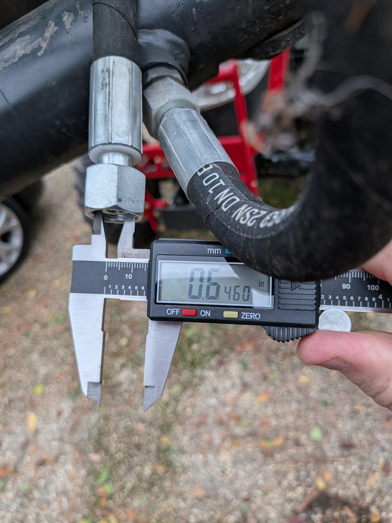

Hose dimension:

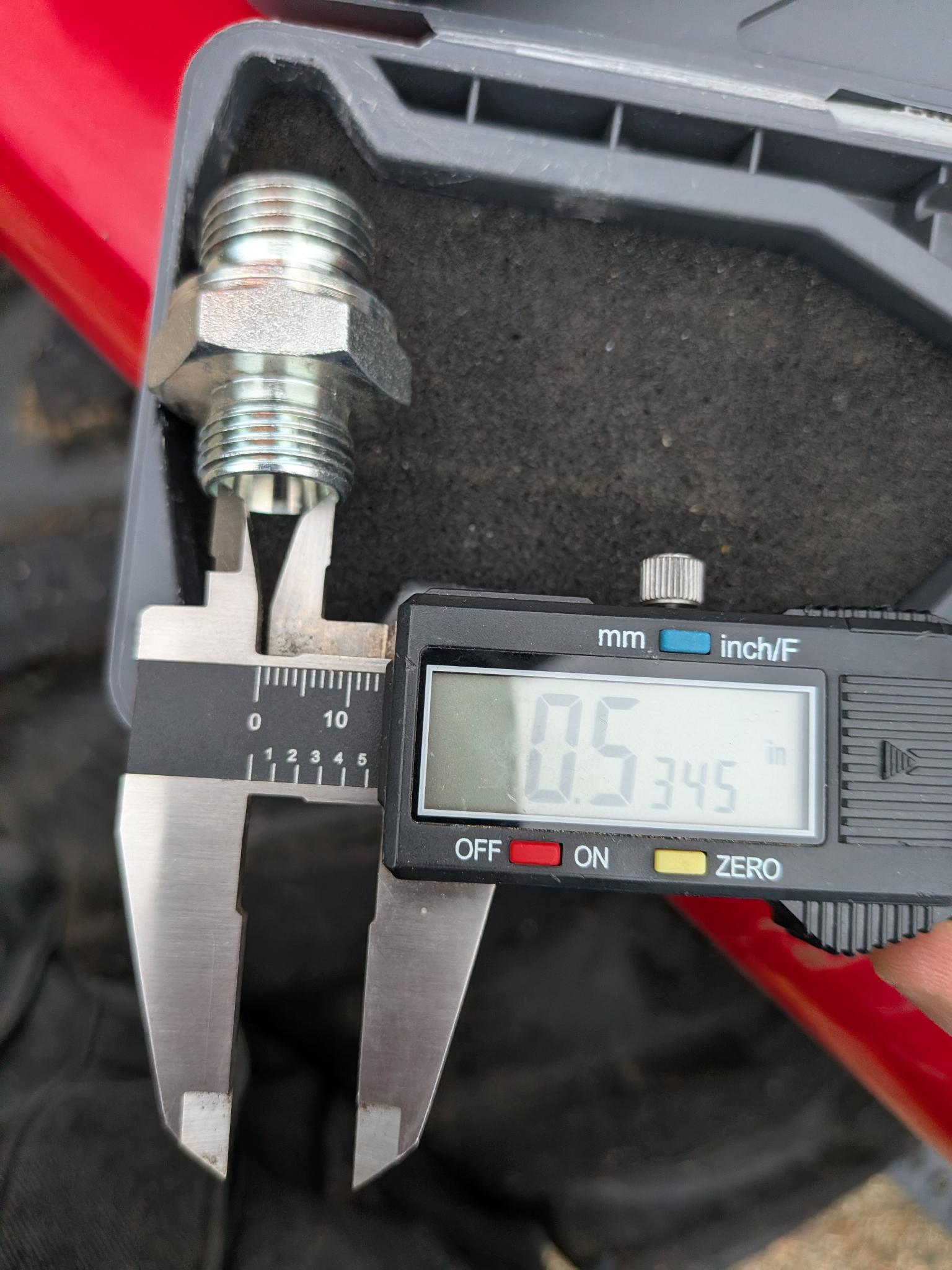

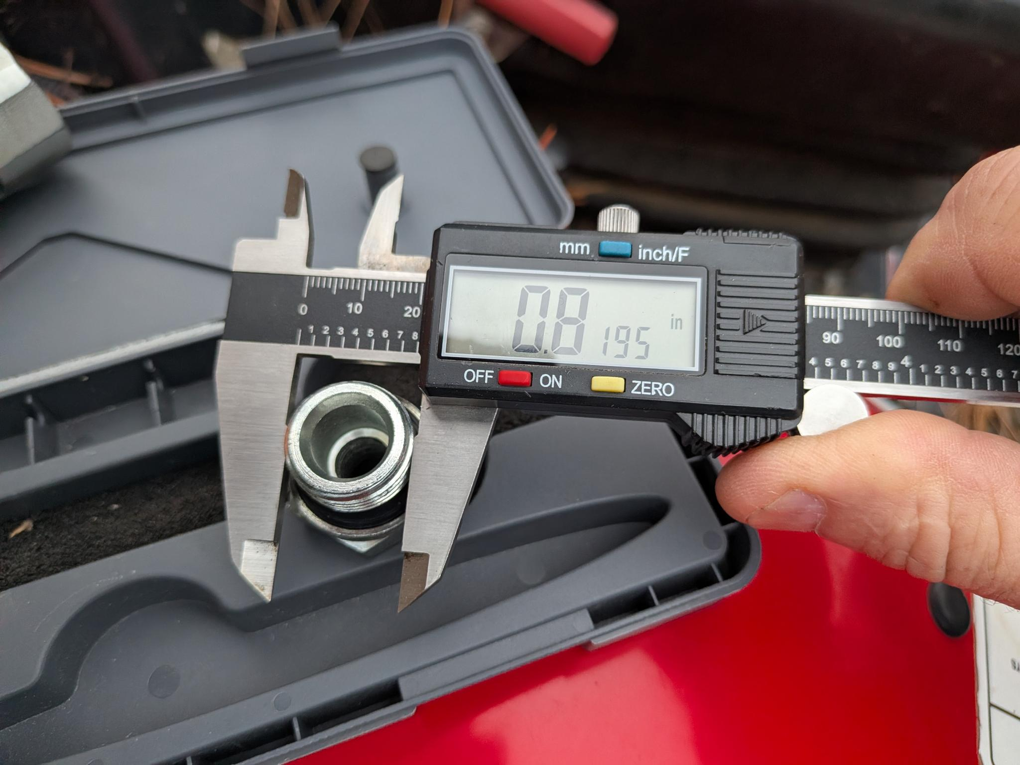

Adapter on the right of the coupler pic:

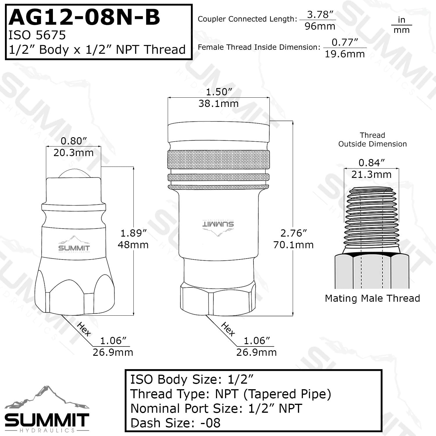

I saw this
Summit Hydraulics 1/2" Ag ISO 5675 Hydraulic Quick Connect Tractor Couplers, Ball Pioneer Style w/Dust Caps, 2 Sets: Amazon.com: Industrial & Scientific
but that's NPT so guessing it won't work.

The end of the hose has a female M18x1.5 DKOL fitting. The adapter in the 3rd and 4th picture is a male M18x1.5 on one side and male 1/2" BSPP on the other.
If you can find a 1/2" Coupler with 1/2" BSPP thread, it would be a matter of simply swap the flat face coupler with the new one, using the same adapter it already came with.

The adapter has an o-ring on the coupler side, are you sure it's BSPP?
   / New attachment... not certain of necessary coupler parts #5
Yes. That's what seals against the face of the flat face coupler (in this case) or a port on a cylinder or valve block.
Right, I confused it with BSPT, thanks!
