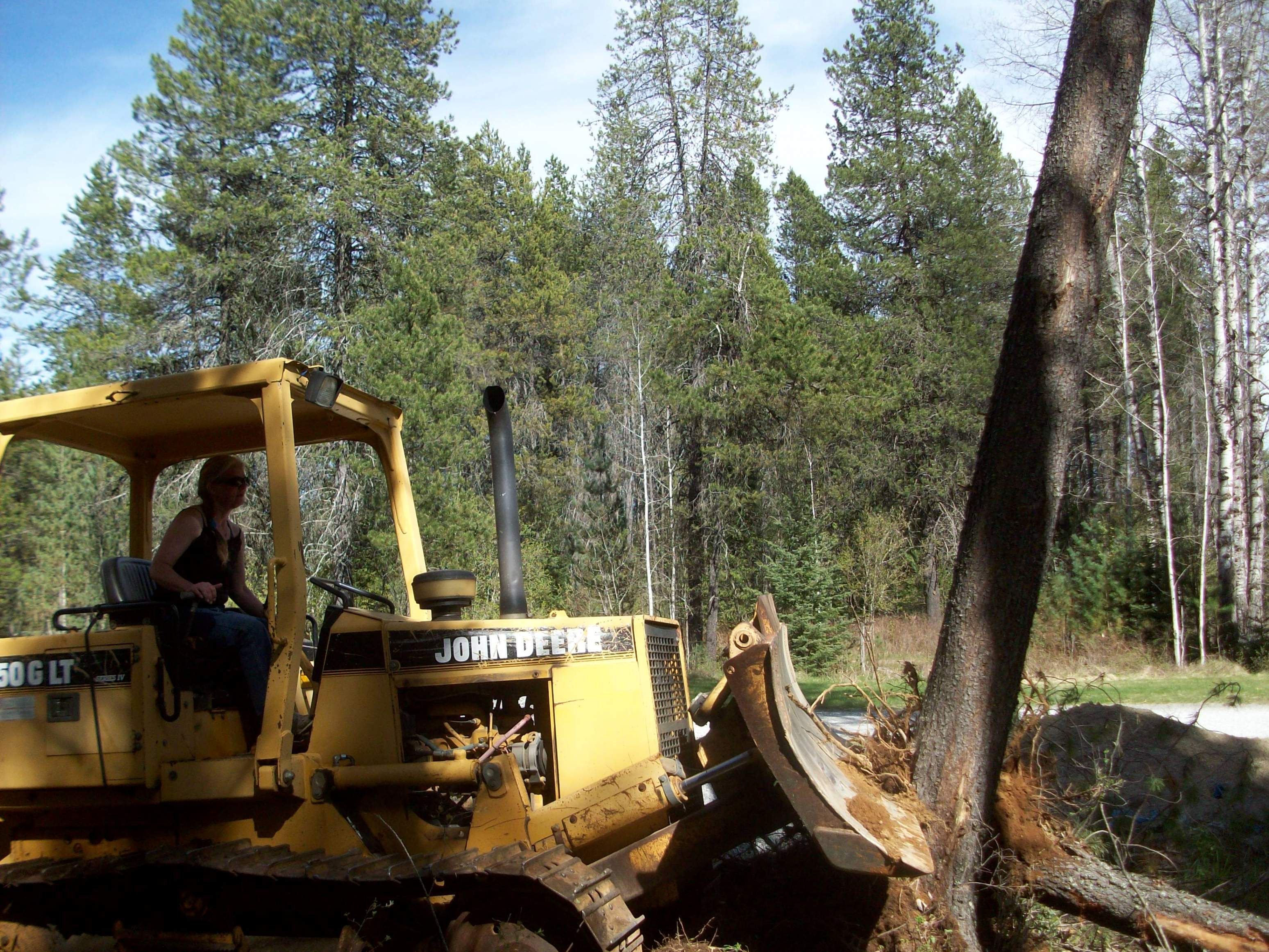

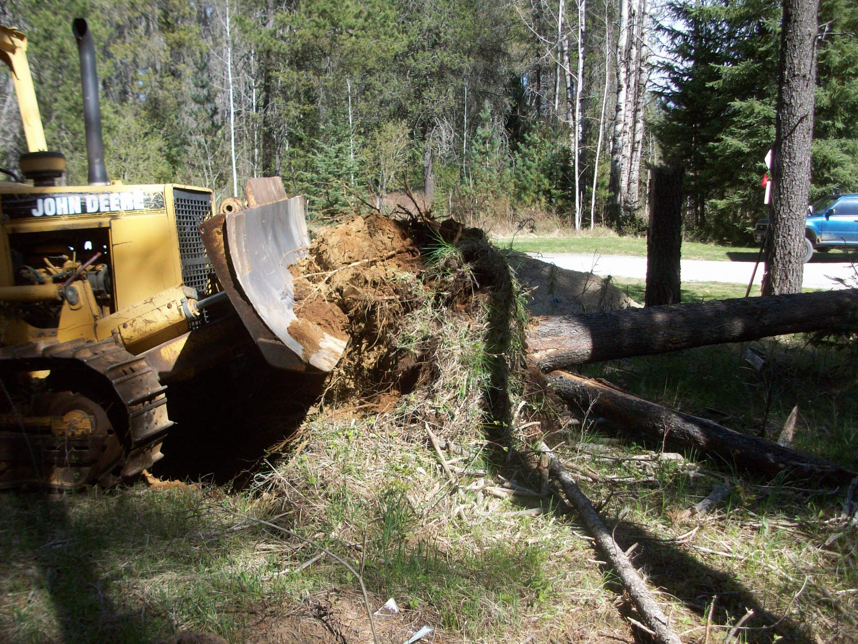

I made a deal with the wife- since we needed to warm up the engine before the oil change.
She could learn to drive it and pop out a stump or push over a tree.

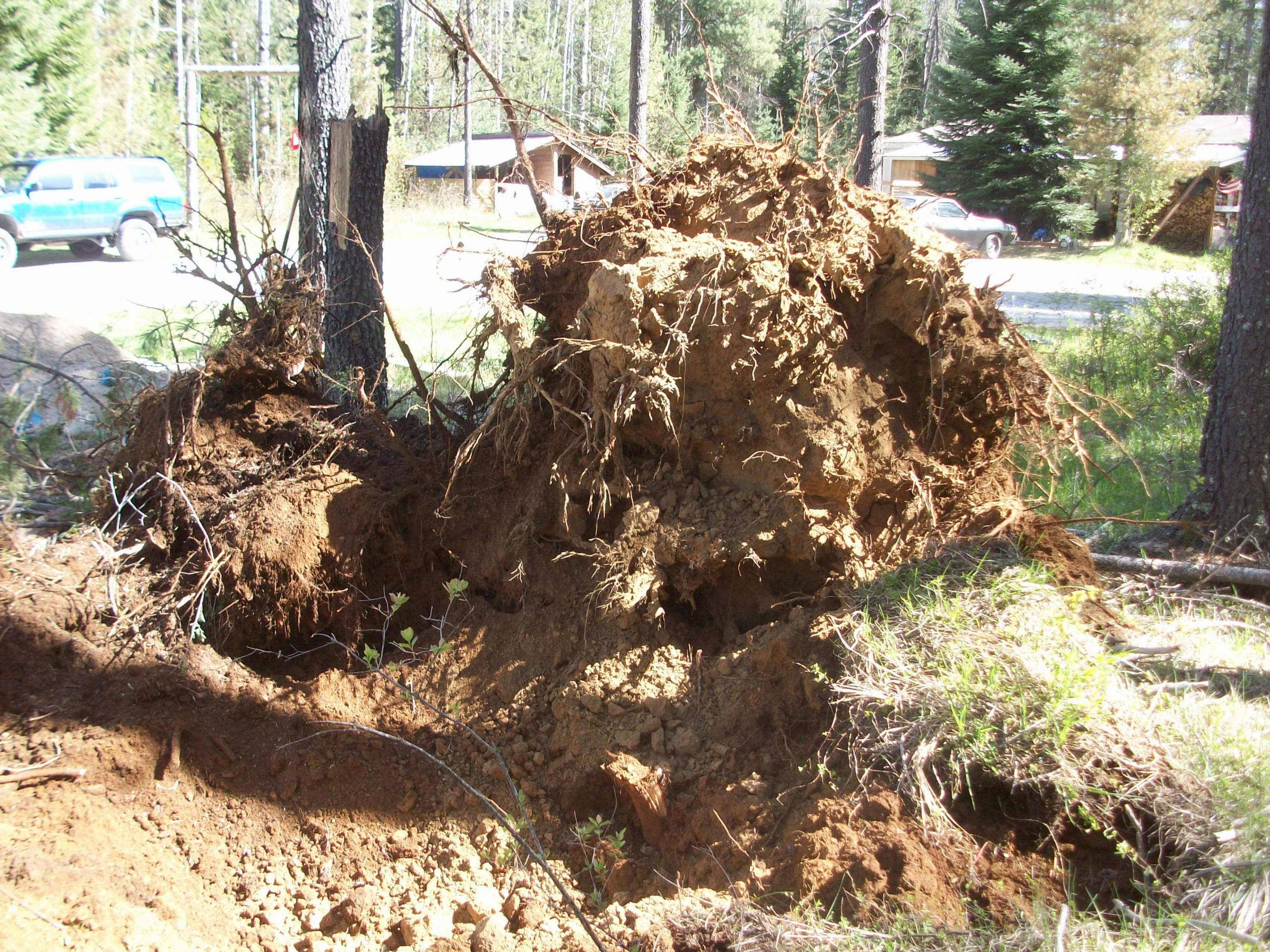

This one lost a top during a violent storm last year.
View attachment 422650 View attachment 422651 View attachment 422652
I think she did very well.
Oils changed and took out 3 more trees and grappled them out with the Rhino for fire wood-
the stumps and dirt are my only real problem now?!..(getting them out of the ground) was only part of the job.
But we are having fun.:)

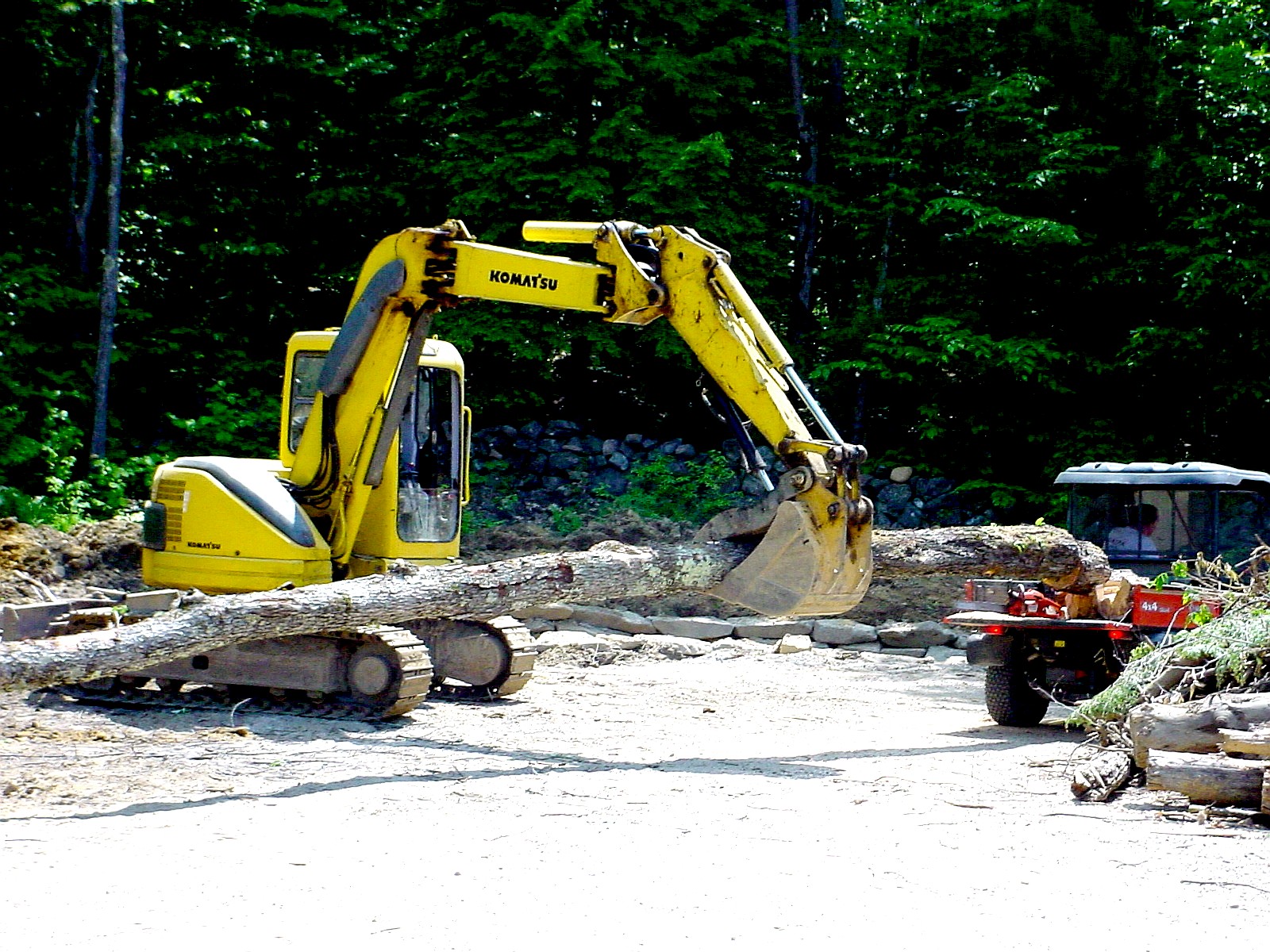

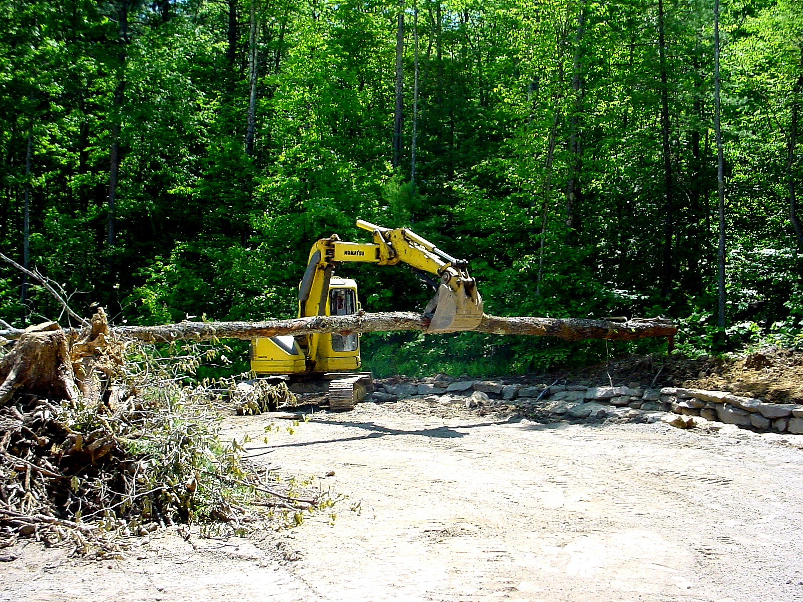

Stump removal with my Komatsu_1997 PC75UU2
It is a small Excavator, 18,000 Lbs, really only about as strong as a commercial backhoe.

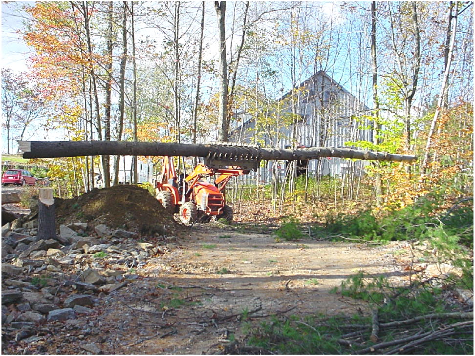

This is my technique for surgical removal of trees. It works with hardwoods 6" to 8" diameter and birch and pine to 10" diameter or a bit larger.
1. Decide which way I want tree to fall.
2. Dig to break roots right next to trunk 220 degrees around the tree OPPISITE the side that you will fall the tree.
3. Get bucket under the root ball and lift. The roots still in the ground will make the tree tilt in the direction you wanted it to fall.
4. As I have now loosened the tree, and it is leaning a bit, I grab it with the thumb and rip it out.
5. Watch out swinging the tree, it is like a 30 to 40 foot baseball bat.
6. Move tree to where you want to cut it, buck it and cut up for firewood holding tree off ground at a comfortable working position.
7. Take a break.
8. Repeat.
A large excavator (+30T) with a thumb could log really well and handle large trees, but few larger machines have thumbs, plus bad things could happen quick.
For large trees. I wrap a strong chain as high as I can reach with a 24 ladder then cut them and pull them with a 100 foot cable. When the tree starts to go, I swing the boom to pull fast as I知 backing up. I have had the tops of the tree brush the cab. A good scare, but the branches are small at the top. Around here, 90 to 100 Ft tall is a big tree. 99.99% of old growth has been cut.
She could learn to drive it and pop out a stump or push over a tree. I think she did very well.
That's awesome!

thanks she is wanting to get rid of a bunch of small diameter trees from her horses field so we are going to take turns doing some of this tree/stump removal.
And the best part is -we should have lots of new fire wood.:thumbsup:
