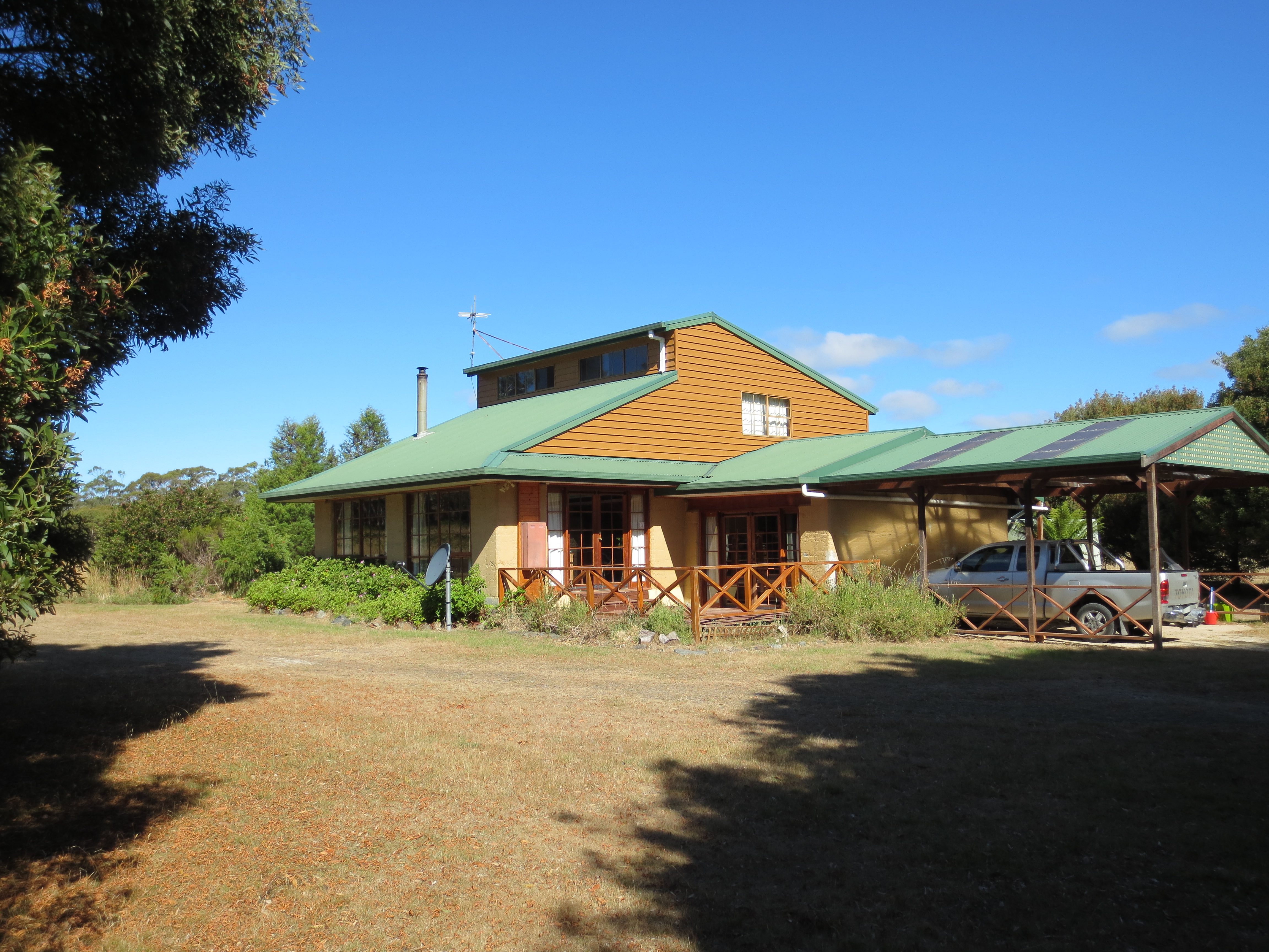

Especially if, after all these years, you're getting rust. Times & technology have advanced... the typical metal roof here in Aus is a "colorbond' steel (usually corrugated, but not always so - I had to Google "5v" to see what you were referring to), the coating of which really makes it last.
Heck, the "colorbond" colours are so standard here that house paints are matched to the same shades.
25 year roof on my house. No leaks or loose panels:

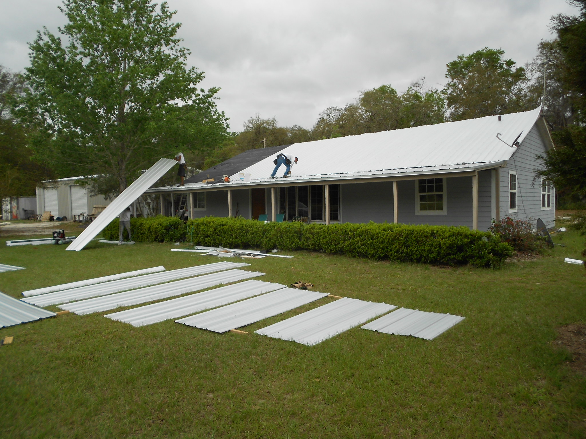

If you want the building to last I would remove the old roof.
I just got my home roof replaced with 29 ga. metal roof.
I priced the metal before I had the roofer do it and this metal is called "Galvalume" and costs $1.44 a linear foot (1' X 3').
It is much better than 5V.
Also they screwed it down in the rib not the flat and he said the engineers approved of this.
My roof is permitted and inspected. Roofer has his own machine to make the panels!
