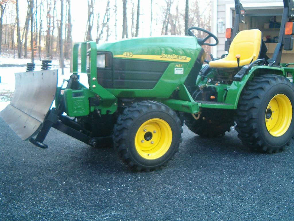

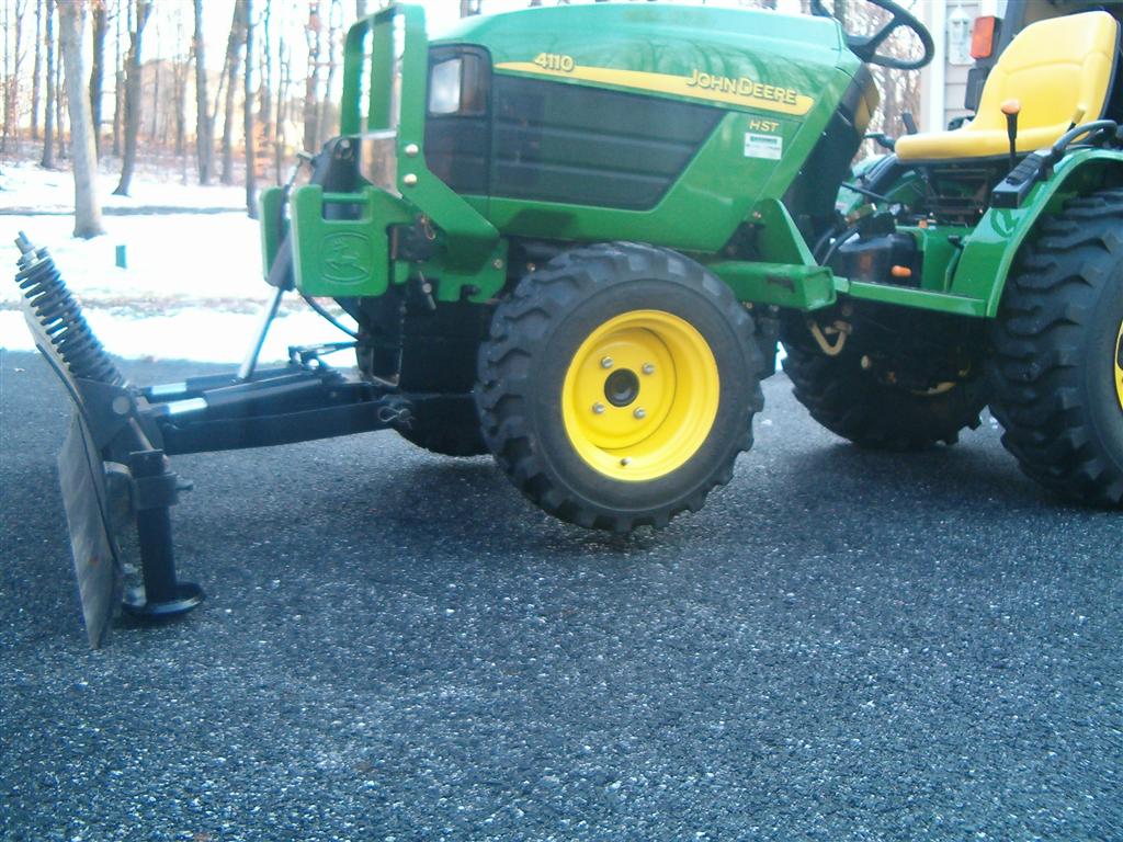

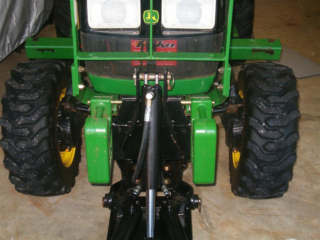

OK, Now that makes sense... They are not for the QA for the blade and blower. They are to hang on the front bumper. The terminology is confusing to say the least.
On my 4110 I can hang 5 of them on without the FEL attached, and can get 2 of them on with the 380 plow I adapted to my machine. They are mainly used by people without FEL's to balance the tractor when running very heavy rear implements. They sell for $1.00 a pound also.
I am pretty sure you can't use them and the Quick Hitch at the same time, hopefully someone else can confirm this?

Looking at the size of those weights and the amount of room in front of the bumper with the Quick Hitch on I would have to say that those weights will not fit when the Quick Hitch is mounted.
This should not discourage you though because the 2210 will plow just fine without them. You'll have to experiment with the rear weight or maybe loaded tires or wheel weights but you'll find a setup that works best for you. My biggest gripe with the front blade is that you can't raise it up high enough in my opinion but it's not the end of the world. I was used to plowing with a 4115 and you can raise the blade up approx. 4" higher so I was spoiled.

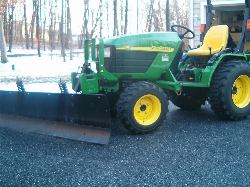

Fair price for the 54" front blade.{$1150} Paid that price in July of 2004.
Included complete plow, mounting brackets and hoses. I have since made
a 6ft. plow out of it by putting a 3/16" skin on the front. Works great.
Plow will work fine on your 2210. Don't need weights on 4110.
Rear tires are loaded with wheel weights.
