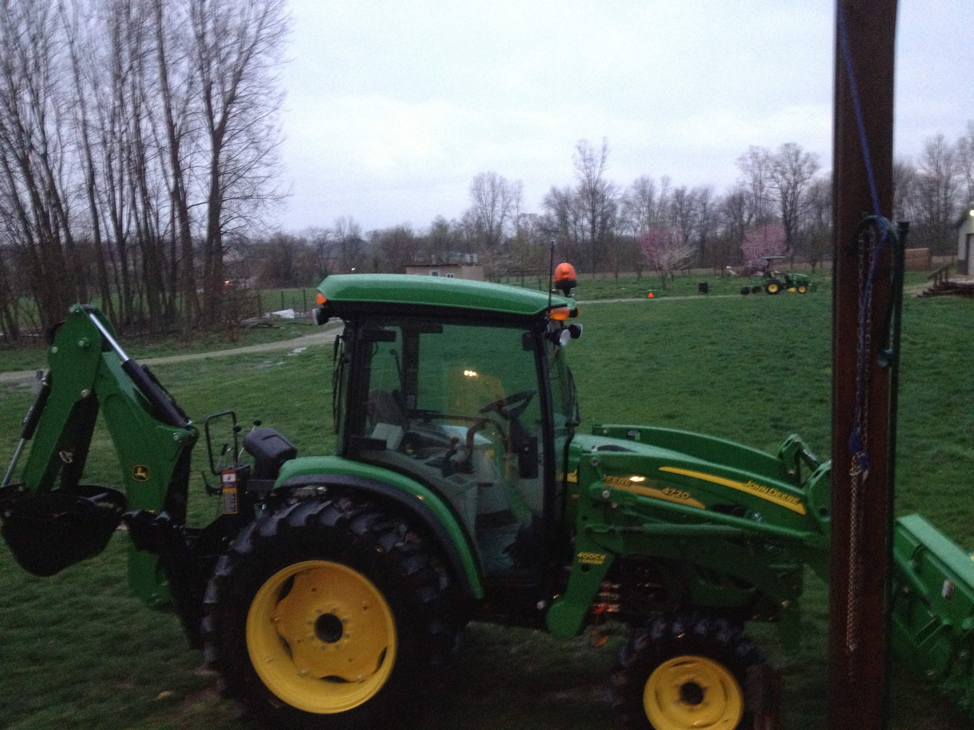

The new 4720 showed up yesterday. Got a little seat time in. One option I picked up was the creeper kit that lets you move forward and reverse and change idle speeds from the back seat on the hoe. I spent some time playing and I would highly recommend it. I like it much better than pushing/pulling with bucket or getting off and going around. I can't wait for it to dry out some to put it to some real work.
Sorry the picture is not so great, weather just isn't cooperating......

Very nice.. lot's of green there! Didn't realize that Deere offered the creep to re-position feature on the new 4x20 series with a backhoe - sweet! Congrats on your new tractor and thanks for the pic.
Maybe more later.. with the sun out! :thumbsup:

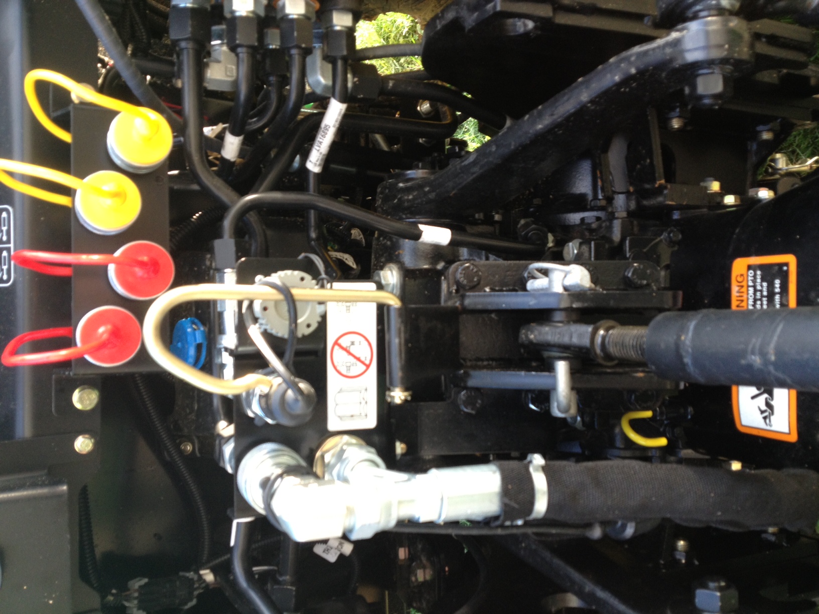

Yes, next to the power beyond hydraulic connect is a plug similiar to a trailer plug tge connecrs the creeper. I will try to get some better pics tommorrow

The plug goes into the gray plstic plug seen behind the hook here to the right of the power beyond.

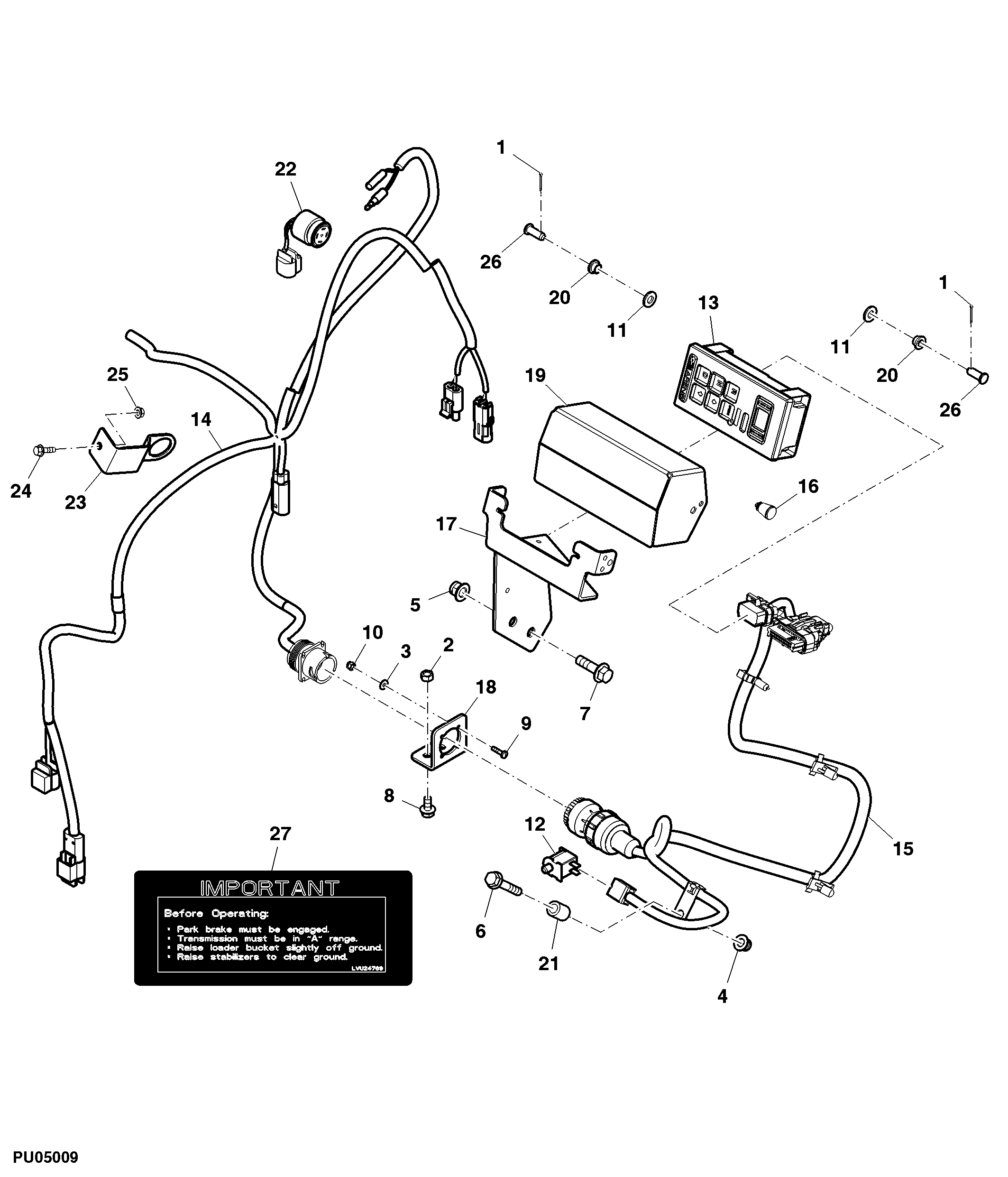

Bringing back an old thread but I need some assistance on this subject. Just added a used creep to position to my backhoe and 4720 tractor. I plugged the connector from the backhoe to the gray connector on the tractor. The creep to position control lights up, turns on, but then does nothing. I have the tractor in A range but no motion and no throttle control. Service light seems to be on. Does anyone have any ideas? Also, does anyone have any documentation on this device. I cannot find anything in the tractors operator manual and I didn't get any documentation with the creep controller. I bought it off a person who added a 485 backhoe to a 3000 series tractor and could not use it.

The seat switch is working properly. Upon a further inspection, the wiring is wrong on the tractor. There is a harness that goes to the battery and is fused on both wires. These wires power the controller. At the rear of the tractor in the same harness is the round plug that fits the cable from the creep controller. There is another 10 pin rectangular plug that is just hanging from the harness that has to get connected back to the tractor somewhere but that is the mystery. I do not see any plug that will match it anywhere. Where does this connection go?
/ New 4720 w/ creeper #18
I am assuming this is kit LVB26039. What I found online states: Only compatible with 4520 and 4720 model year 2011 and up with software LVA16028P or later.
You might want to see if a JD dealer will print out the install instructions for LVB26039

Yes this is the kit. I had a dealer send me the instructions and also figured out that I needed the LVA16807 part ( wiring harness for tractor). I ordered it today and will install this coming weekend. According to diagram this should be all I need. Just have to figure out how cable connects to tractor. Instructions are not very clear. Thanks for the help
