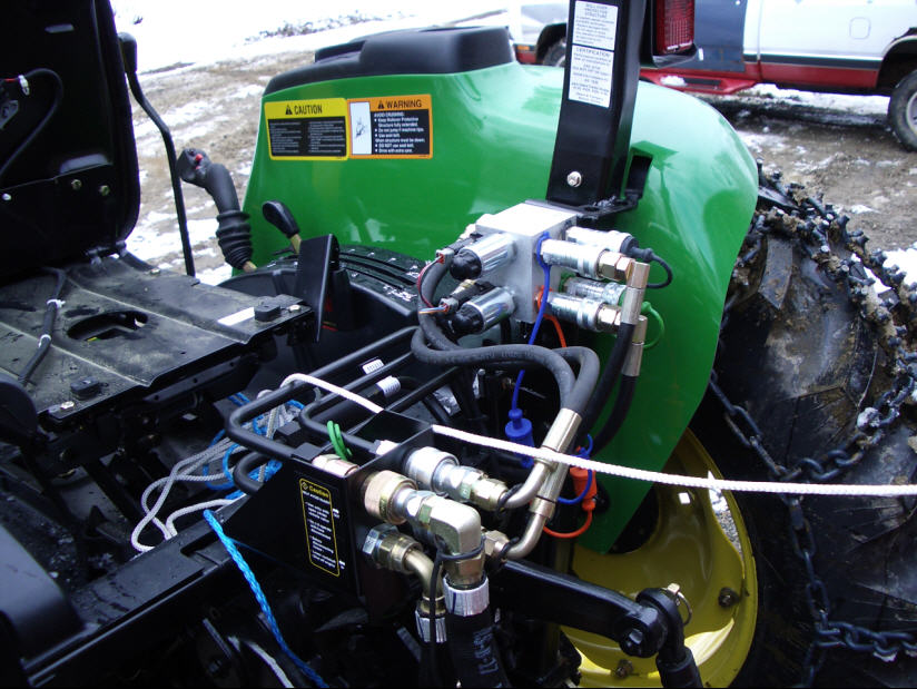

boatermark said:
Wow! Didn't know that existed on the 4x20 series. I was originally looking into the WR Long system like you are describing, decided against it, and settled on running the 3rd function off the regular SCV lever. I am however getting a Fasse valve so that I have two remotes in the rear, and can swap from one to the next with a button. This way either would be run off the SCV lever. A cheaper way to have the ability to run Top 'N Tilt someday and not have to shell out for JD's electric diverter. I'll post some pics of that someday...whenever the tractor finally arrives.
What did you end up getting for your tractor.......
/ New 4720 cab owner #42
Mark thanks for your help, I think I am going with Fasse....Anyway here is Mark's setup......

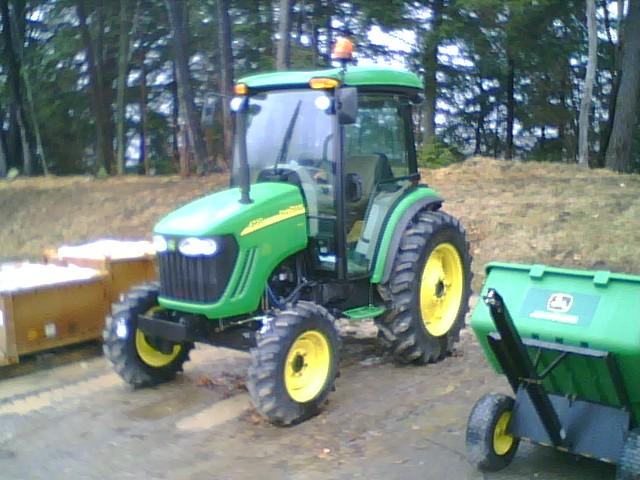

Mine is on order from 3 weeks ago.....Still waiting.....I ordered once zero for 36 came back out....Will post pics
/ New 4720 cab owner #45
Just got word that my 4720 came in....Dealer sent me pic....Waiting on getting tires loaded and plumbing the rear valves for 4n1....Maybe will pick up next Saturday and will post pics....Thanks everyone for the help!
