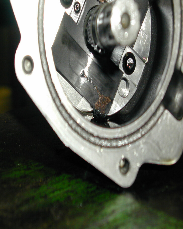

This sounds like the same problem I had on my 4700. The squealing sound is from the pressure relief valves. After several tries to solve the problem, The JD dealer replaced the complete HST. The cause was found to be a failed quash plate bearing. I posted pictures of this on the JD4000 club on YAHOO under Tony's Toys.

You are correct John. I have tried to reduce a photo of the cause of the HST problem which is the squash plate bearing.
Here Goes.
Tony
