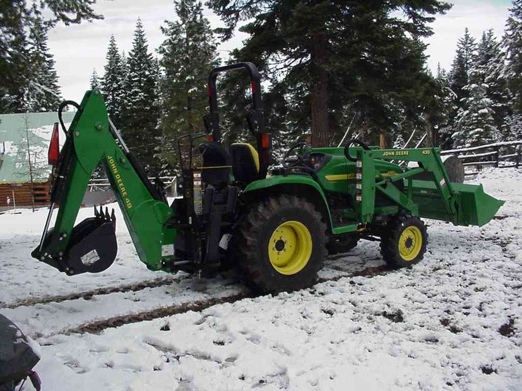

Removed the BH today for the first time. Was a pain because the rockshaft arms didn't hold the hoe up. I had to use the outriggers to lift up the BH to remove the pins but when I lowered the outriggers, the BH started to lower. Went back and forth but finally got the rockshaft arms to lift up the hoe. I guess they hadn't been exercised in awhile and they finally worked. /forums/images/graemlins/crazy.gif I removed the rockshaft filter and cleaned it and installed a Frontier RB1072 rear blade for snow removal.
Will the rockshaft arms lift with the hoses hooked up for the BH? /forums/images/graemlins/confused.gif
Thanks again for the help and I attached a pic of my new toy! /forums/images/graemlins/grin.gif

The rockshaft arms will not lift until the hoses are changed from backhoe operation to 3PH operation. You might have to make an adjustment to the rockshaft arm height if it doesn't have enough travel to lift the 48. Not a big deal to make this adjustment. If you need the procedure, I can copy from my manual for you. Great pic, a real nice baby, wish I could've got a deal like you did.
