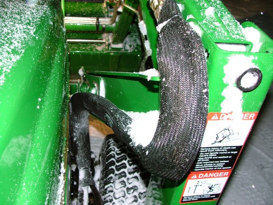

I don't have a backhoe on my 4010; so I don't have the left hand problem. Don't have the right hand one either. My hoses are nicely gathered and protected by like a black mesh netting. I'd think the 4010 and 4110 are almost identical except for 2 more hp in the engine and sep. power steering pump and about 20% higher rate hydraulics. Think I maybe should shoot a pic of my right side stuff.
Will go out there and do so.

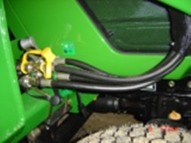

Tombo,
I don't have my backhoe yet, so I can't comment on that problem, but I don't have the problem with the front tire rubbing against the hydraulic lines either. I took a photo of the fabric around the hydraulic lines on my 4110. All the rubber lines are nicely tucked in the loader's support arm.
Hypernix

Hypermix beat me to it. That's exactly what my 4010 with 410 loader looks like. Someone must have bent a bundle of lines on your 4110.
Ralph

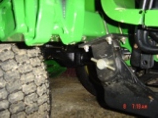

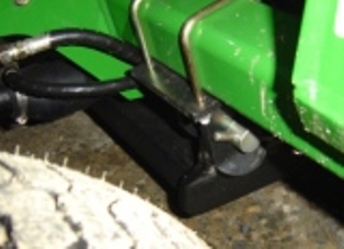

Tombo,
I have the 4110 with BH & FEL, I don't have either issue, it sounds like your install might not be correct. This photo is from just above the front left tire looking into the BH subframe mounting bracket - it attaches to the FEL support. Nothing extends in front of the FEL mounting frame. There's easily a couple of inches between the tire and mount when fully turned to the left. 2 more pics to follow.
-Norm

This is from behind the left front tire looking into the BH subframe mount.
-N

And this is of the right front tire looking at the hydraulic lines. Not even close to the tire. As Hypernix said, they're snaked thru a sleeve (looks like snake skin) and then tucked thru the loader arms. Sorry the pics are a little fuzzy, first time trying to compress them to fit within the TBN file size requirements.
-Norm
