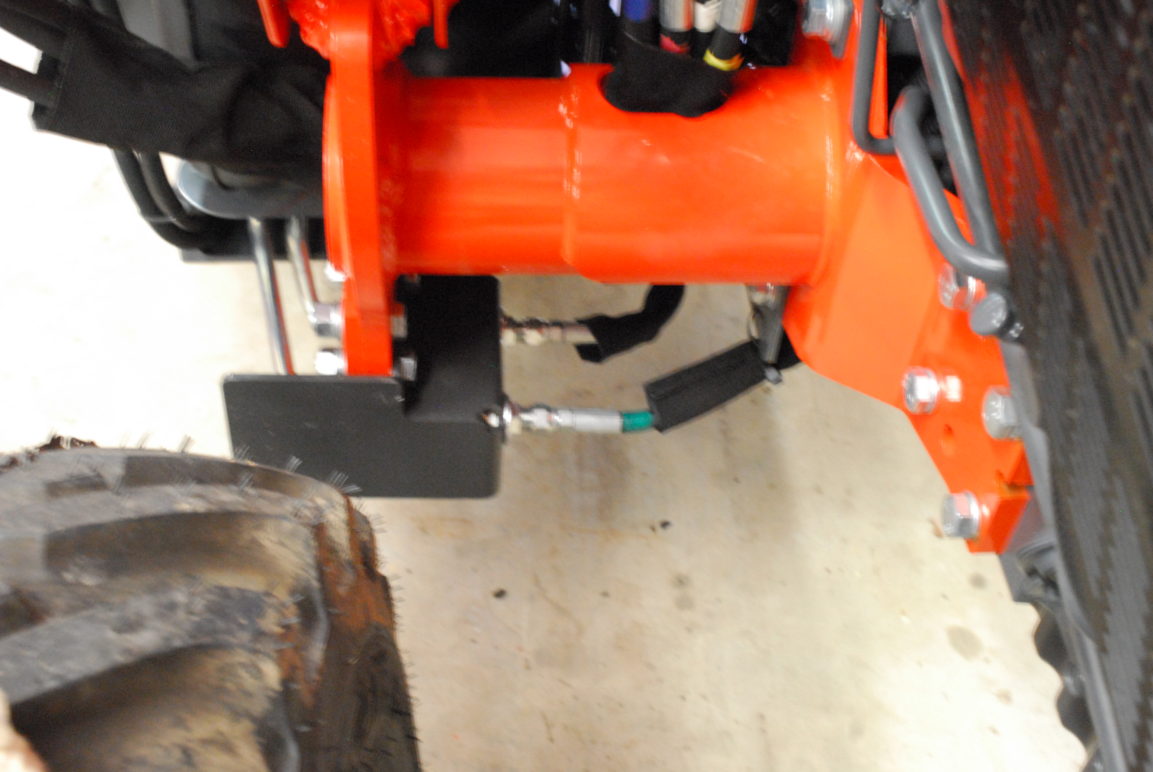

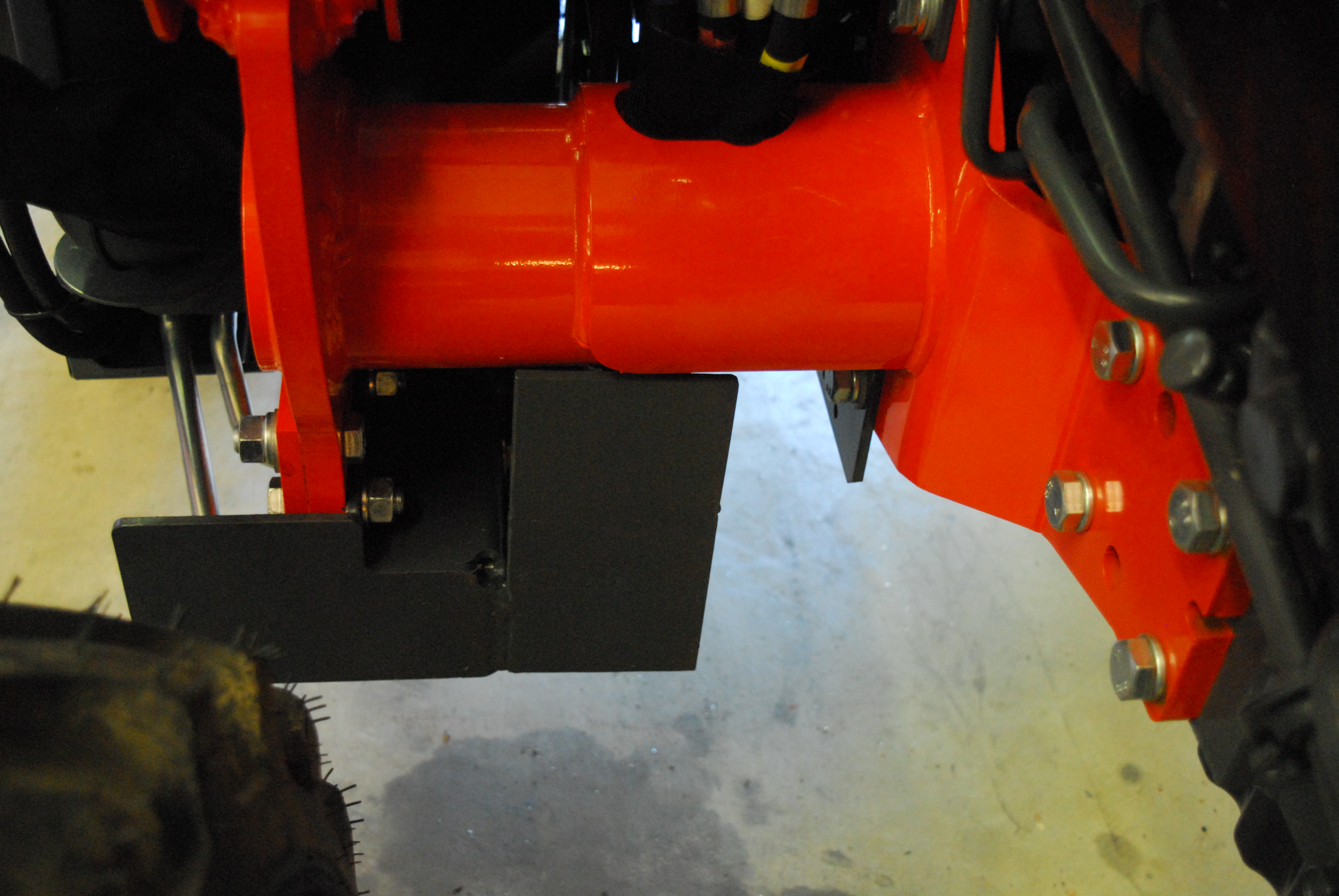

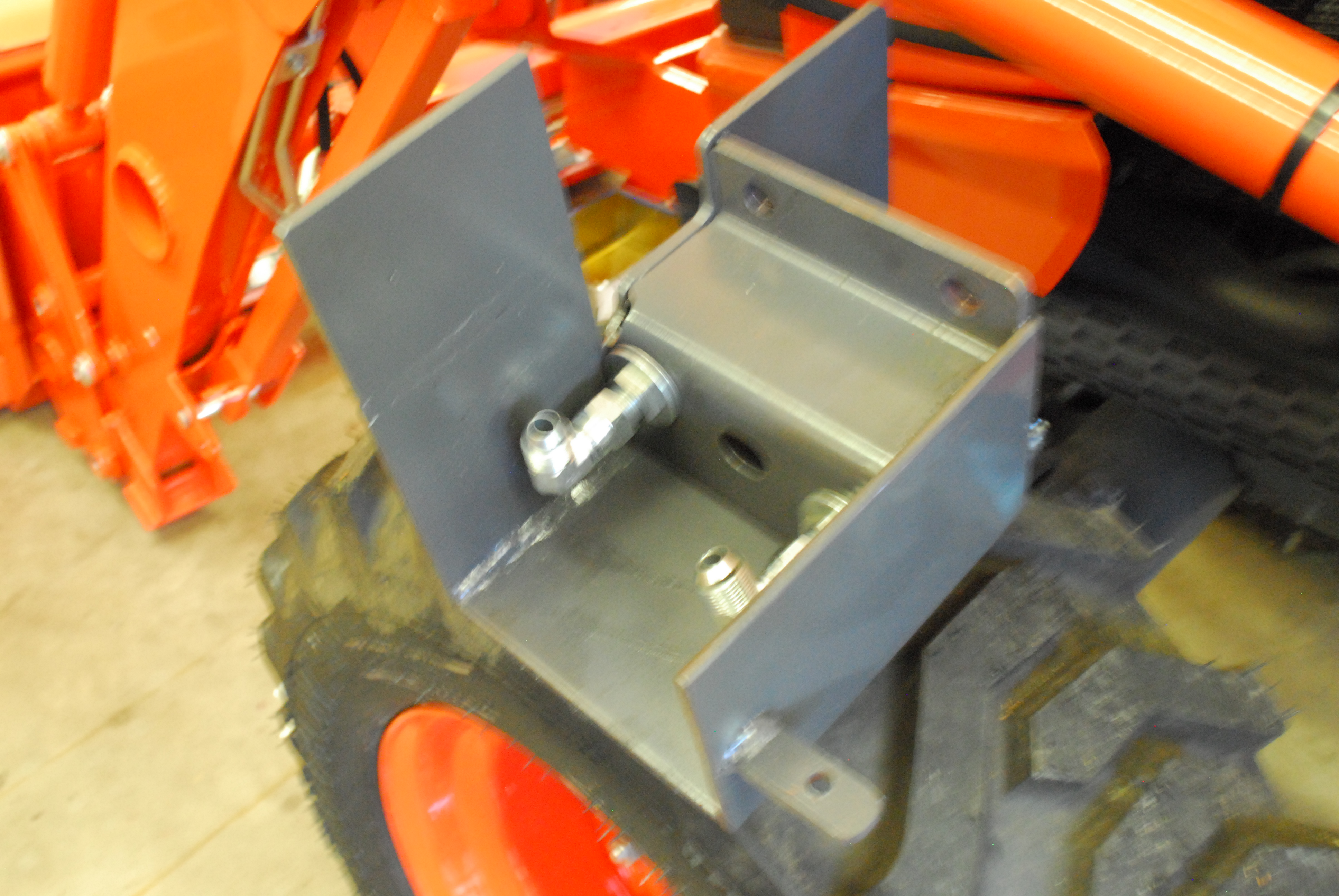

After spending the day fuming over what a crappy design/install the third function valve was and calling the dealer to let him know how thrilled I was that they couldn't even deliver it with a full fuel tank as well, I figured out a work around for the hoses.
I welded up a shield to cover the hose connection on the inside of the frame and by adding a couple of elbows I can change the hose routing to above the fuel tank. It took me less than an hour to do and costs around $10.00. I will also add a cover over the couplers on the loader frame to keep dirt from contaminating them. Once again, a detail that seemed to have escaped kubota.
What really frosts me is that a second year engineering student could have figured this out for kubota so it could be made right from the beginning. Plus it really pisses me off that I decided to let the dealer do it for an additional cost instead of doing it myself, only for me to have to go back and fix what they didn't do right.
I'll post some pics when I finish it.

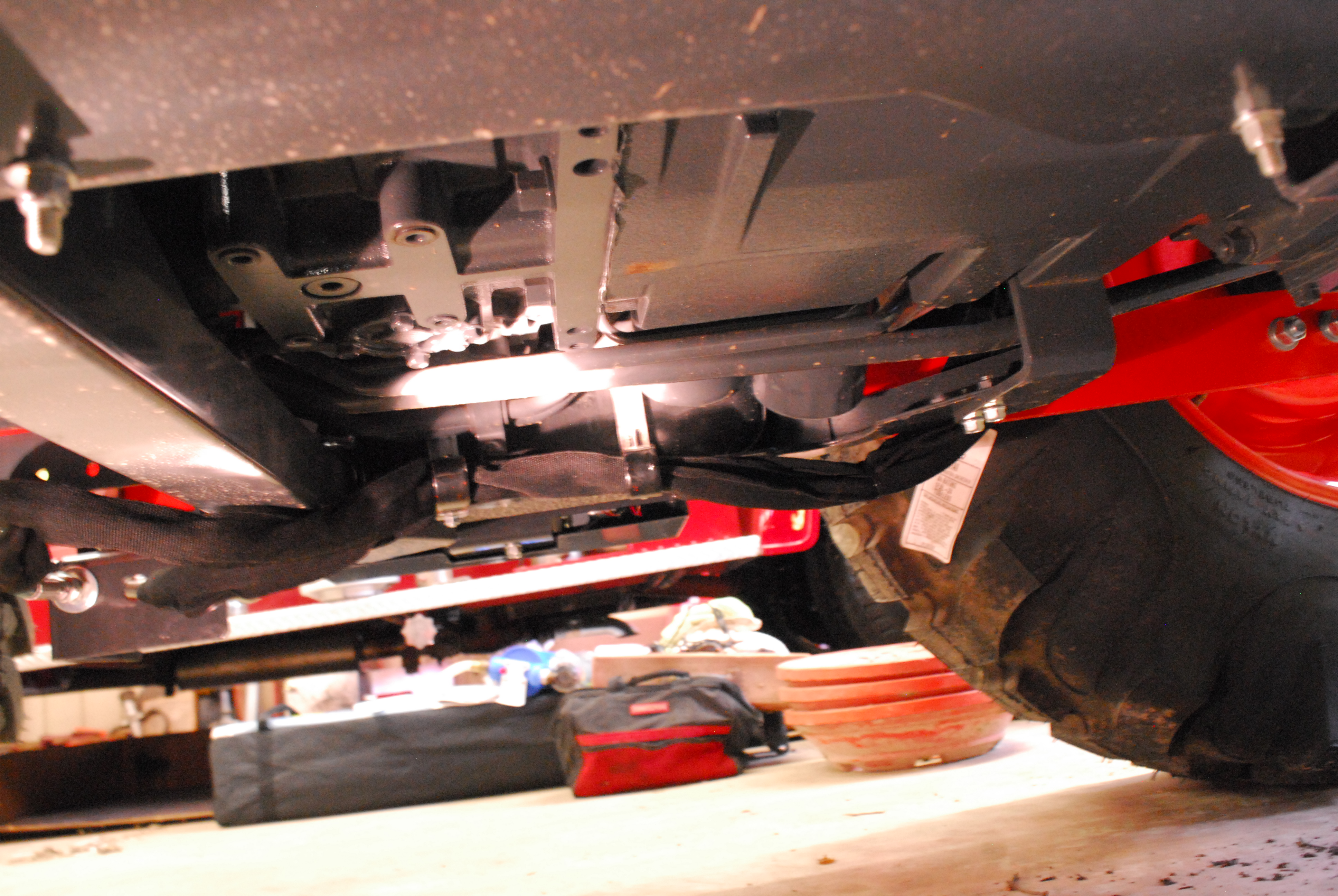

The first is what the underside looks like before the modification. The second is a before picture of the hoses sticking out of the valve box under the cab taken from the front of the tractor. The third is a picture of the finished shield in what will be it's position of function with the elbows in place. The fourth picture is the same view as pic 2, but the hoses are now shielded and run up and over the fuel tank. Picture five is what it looks like now; no hoses!
I did find it a bit ironic that kubota shielded the steel lines, but not the hoses.
If you need to do this keep a couple of things in mind; you need to be able to attach the hoses when you are done; hence the open side. Same for the mounting bolts. I used 1/4" plate because that is what I had on hand. This is rugged, but also heavy so I welded a small tab on the rear of the guard to bolt it up to a fuel tank brace. There was plenty of room to run the hoses up and over the fixed hydraulic lines on my rig; I'd check yours first before going to the trouble of welding up the shield. The hydraulic connections are 37 degree 1/2" fittings; all you need are two elbows. It is easier to hook everything up before you tighten down the mounting bolts and I found that if I tilted the elbows a bit to the center it was easier to get the hoses started.

Thanks for sharing this. I have an open 4060 and noticed the same thing. My dealer did a poor job running the hoses and they were hanging way low. I'll have to look at running them over the tank - that makes a lot more sense.
That shield looks great too. We're doing a lot of work in the woods with the grapple and the tractor has a very soft underbelly.
