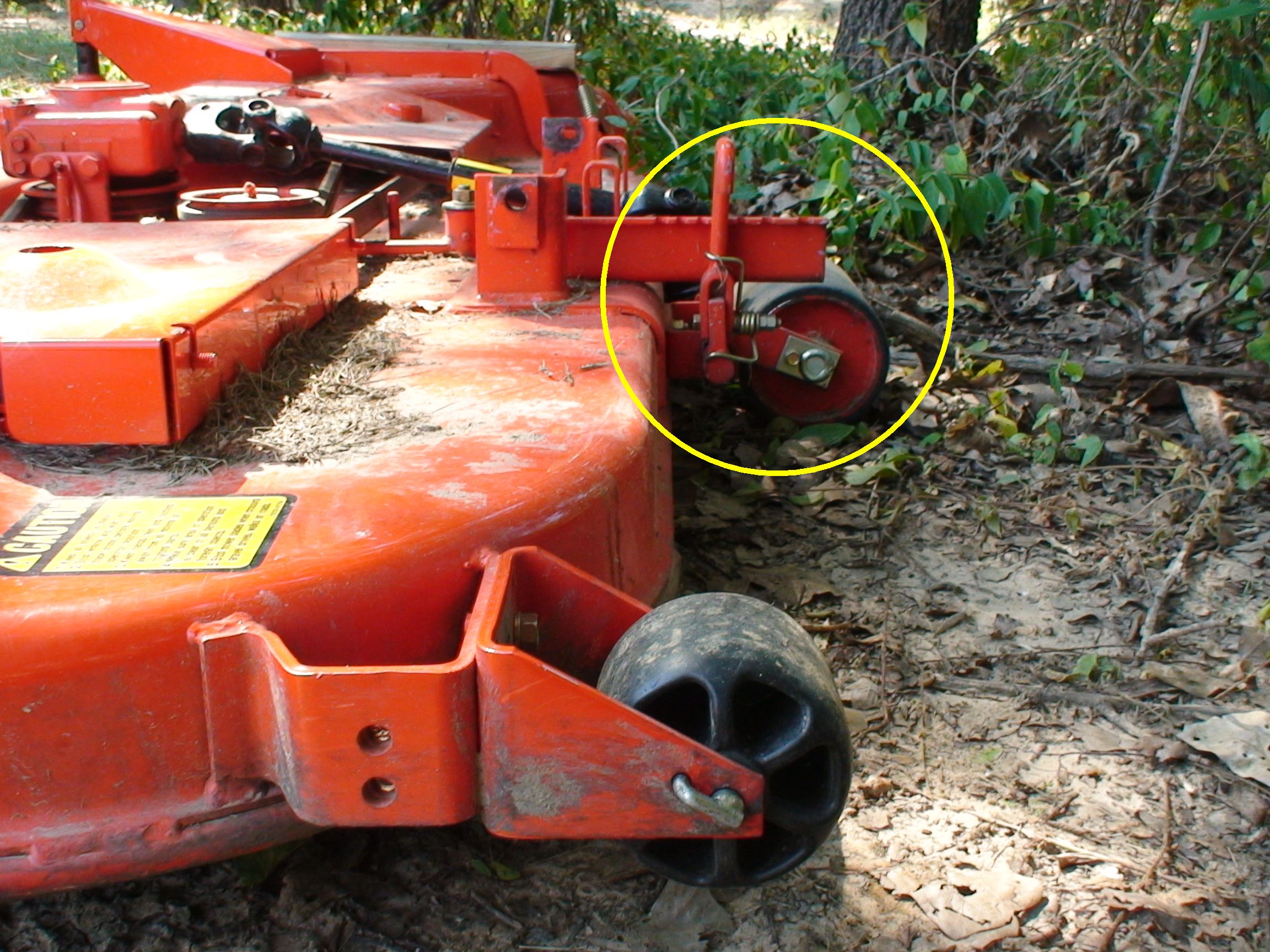

Hey John, the tractor just posted the 400 hour service notice. I have only had a couple problems with the mower. The rear center height adjustment wheel has bent just a little from all the bouncing around. I hate to say it but Kubota should have built it a little heavier. Ill post a photo of it. Another problem that I have had was that I burned a belt off, I think it was the second week of ownership. There is allot of horsepower for that size of deck.
It will mow thick bermuda grass that is half the height of the front tires with no problem. You almost have to mow with a faster tractor speed to keep the chute clear. the reason i burned the belt off was i ran over an old bois d誕rk fence post that was laying in the ditch that I was mowing, the tractor didn稚 even bog down, the post just wedged between the center blade and the mower deck itself. It didn稚 take long, not even a second and the belt was history. Luckily my local dealer had it in stock. The hydrostat noise in the cab was a little annoying at first, but I think I知 used to it now.

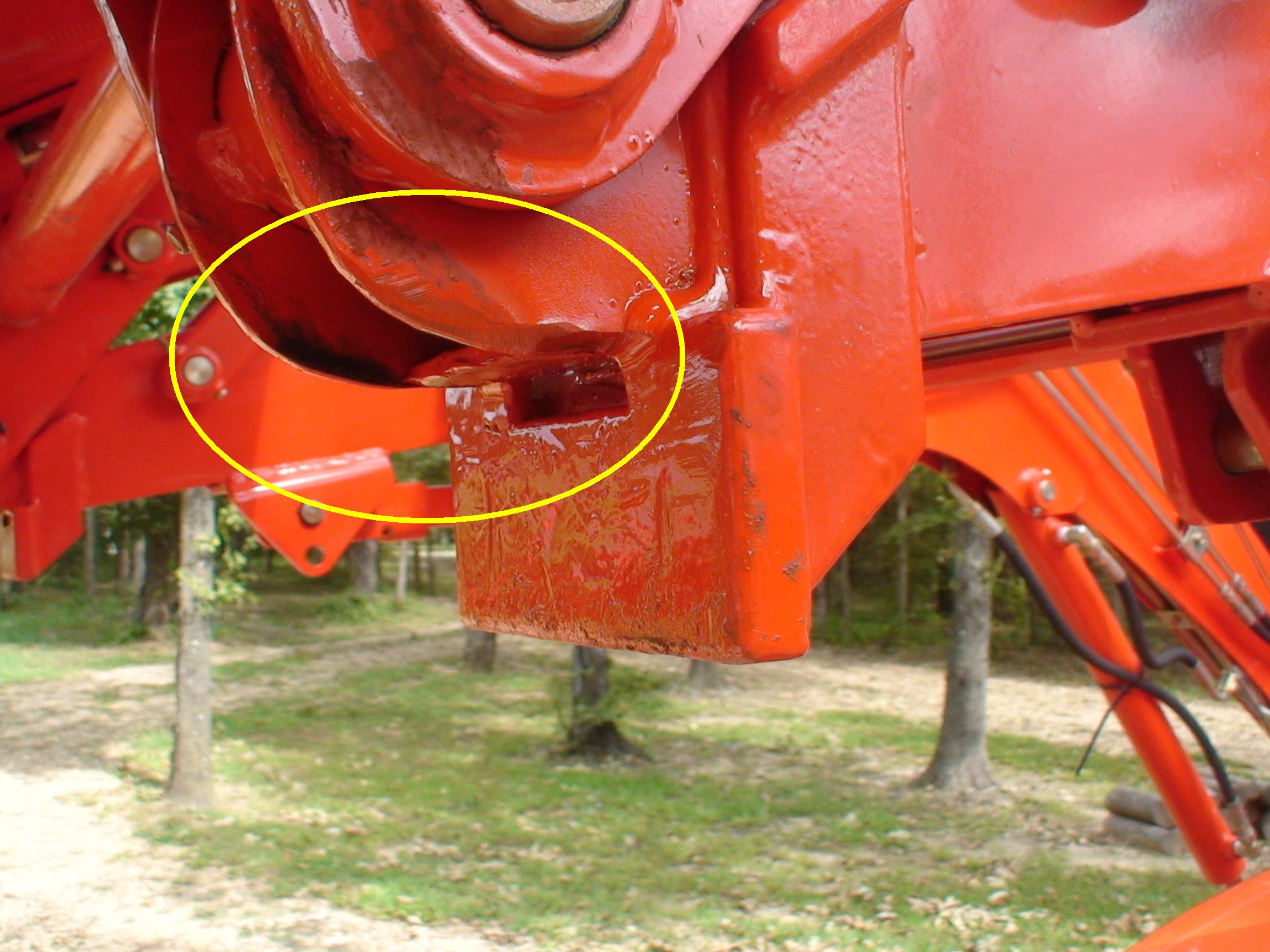

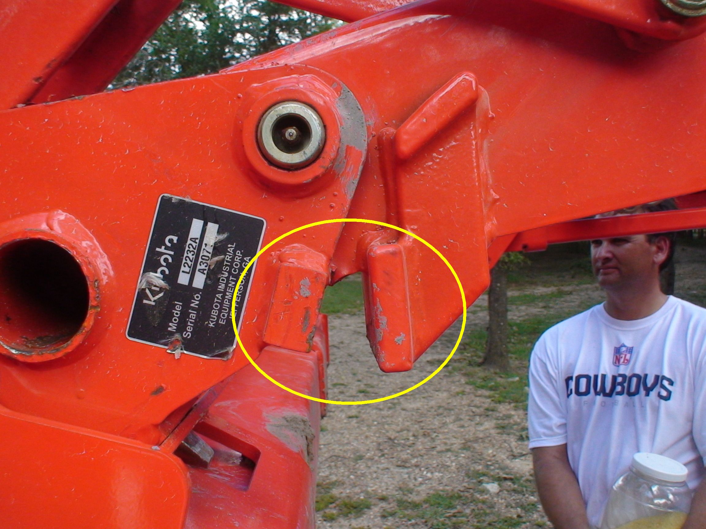

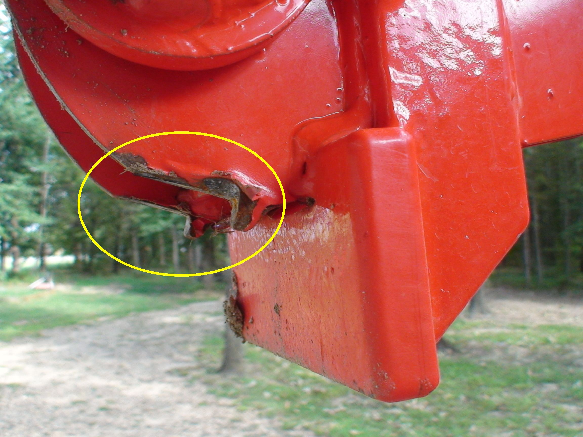

here is a photo of the rear height wheel. And I forgot to mention the loader bucket would not dump all the way, for some reason the geometry was wrong from pivot pin, so I had to grind some metal off to make it work properly. The bucket actually wanted to stick in the dump position until I ground it down a bit.
