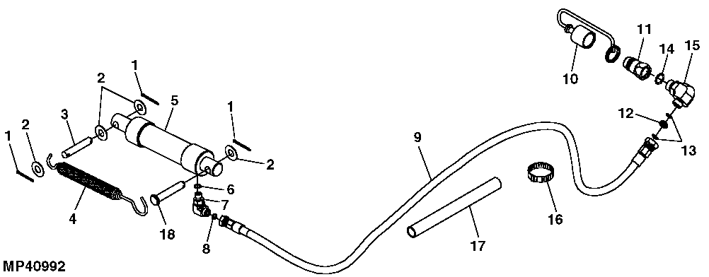

If I recall there is a post on here somewhere about using a washer with an orifice at the hydraulic cylinder for the mower deck to slow the speed down.
Is your tractor a ehydro or auto hst
   / New 3320 Jerks & Lunges #22
Here's a picture of the orifice for the lift cylinder. Its #12 part #N275799
After re-reading your original post you probably do have something out of calibration. I'm out of warranty anyway but would rather try to at least find the problem myself too. I bought a tech manual when trying figure out my loadmatch- tps issue.
