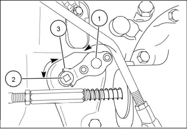

Four days after my last post on "New 3050 CVT" and a little over 16 hours on the tractor the Hydraulic pump let go while I was pushing manure up in the manure pit blowing oil out the side. Not a problem I figured these things happen. The owners manual says not to tow the tractor without disengaging the transmission. So I blocked the wheels and following the instructions in the operators manual I reached up behind the left rear tire to the front of the axle and felt for the bolt I needed to back out to the stop or Flange "see attached picture" (not much room to get there and more difficult in the dark) and backed out the bolt but the flange or stop was not there and so it came all the way out. First major problem! Then it says to turn the other bolt 13 degrees counterclockwise using 60 foot lbs of force until the internal stop is contacted to release the transmission then screw the other bolt back in to lock it disengaged. Using a 3/8" ratchet with a 13mm socket and definitely not 60 ft pounds it turned all of a sudden approx. 180 degrees feeling like something internal let go. Second major problem! But it was now disengaged and we were able to move it. The dealer came and got it on Wednesday replaced the pump and we found out that the trans had to come apart to repair the transmission disconnect shaft along with a parts order. So a week and a half later on Monday it returned. The dealer was great he agreed that the proper flange was not on the side of the trans (the correct one is there now) that there were upgraded parts internally and it would all be covered under warranty.
So the moral of the story is if you have a 2013 3050 CVT make sure the correct stop/flange(Item 3 in Picture) is on the side of your tractor before using the owners manual (that comes with the tractor)instructions for Recovery Transport Preparation for towing.

My dealer said they had to update parts inside the trans also so it would work as described. Not just change that outside flange and locking bolt. They also suggested that if I need to tow the tractor in the future that I should jack one wheel off the ground and rock the wheel back and forth to help disengage the transmission. Seems that an internal roll pin broke on the disengage shaft causing the tear down of my trans to repair. The instructions say you need 60 ft lbs of force to disengage, there is no way I had that much force on a short 3/8" ratchet especially lying on my back twisted around and squeezed up in there to get to it. It was hinted that there might be a different set of instructions for the disengage setup that came with the tractor. That is strange why was a supplement not sent from NH with the tractor and why when they ordered the new replacement parts and installed them it is now the same as in the manual? Makes me wonder if the transmission that is in the tractor was a left over from earlier model and the newer ones will have that upgraded disengage system as described in the Operators Manual?? Bottom line though the dealer has been great and took care of things.

My dealer is checking with New Holland on my lack of external parts for the transmission disconnect but so far they seem baffled. The newer 3050 Boomer they received that is on the lot does in fact have the correct external parts so I am in a holding pattern at the present time. It's hard to believe that New Holland does not know what is going on but so far they are keeping my dealer in the dark....

I finally heard back from my salesman at the dealership by email. He stated that they had been contacted by the Mother Ship and the "updated" parts for my Boomer 3050 CVT transmission "engage/disengage system" were on the way and would be installed once they arrived. This sure has taken a long time but at least I see some great effort on the part of my local dealership. I wonder how many Boomers are missing these parts and why NH is being so quiet about replacing them? Maybe their lawyers and accountants figure it's cheaper just to replace units when a customer complains rather than make a wholesale recall on a ton of Boomers. As we all know the bottom line is always the dollar.....;)
