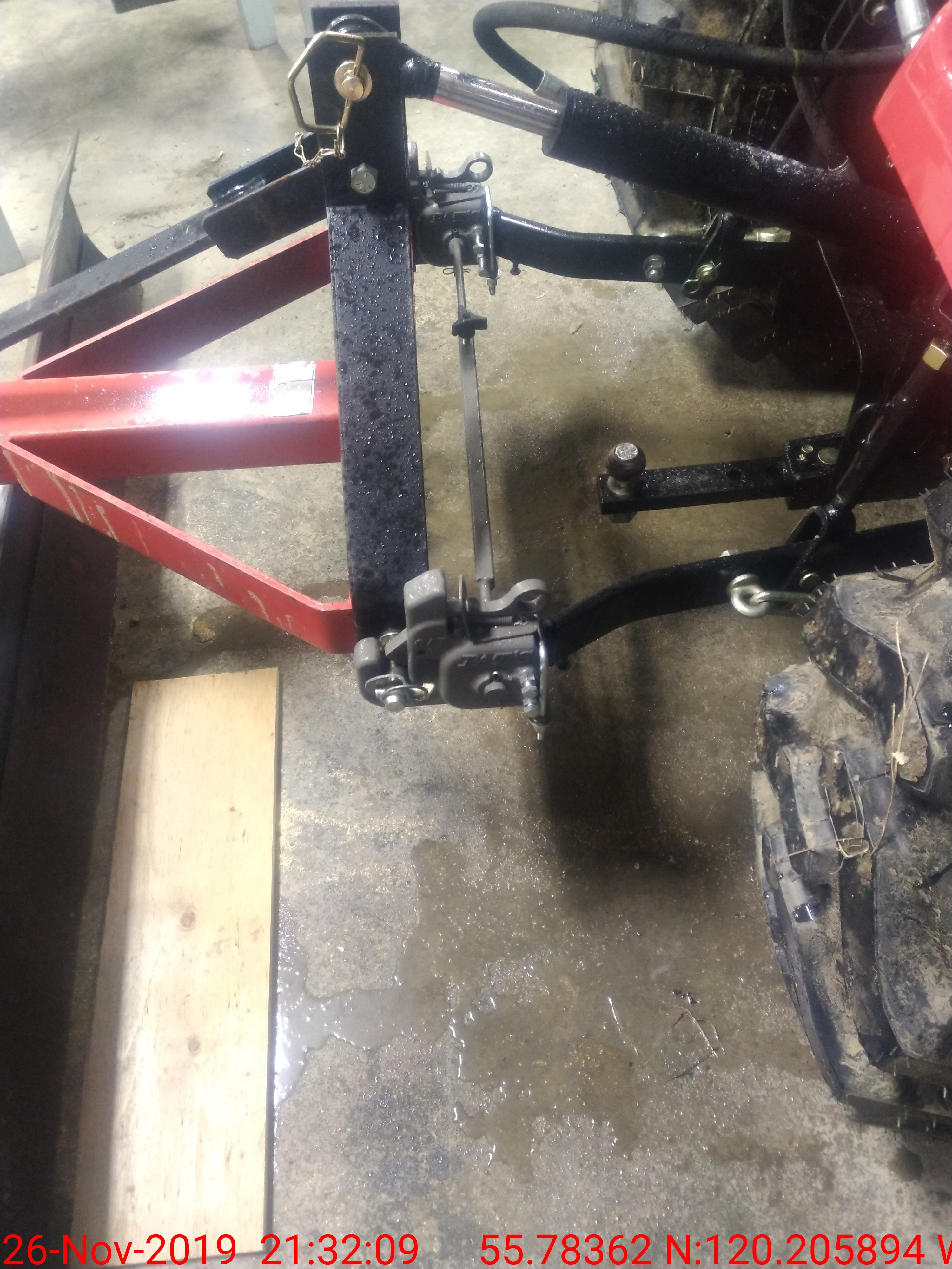

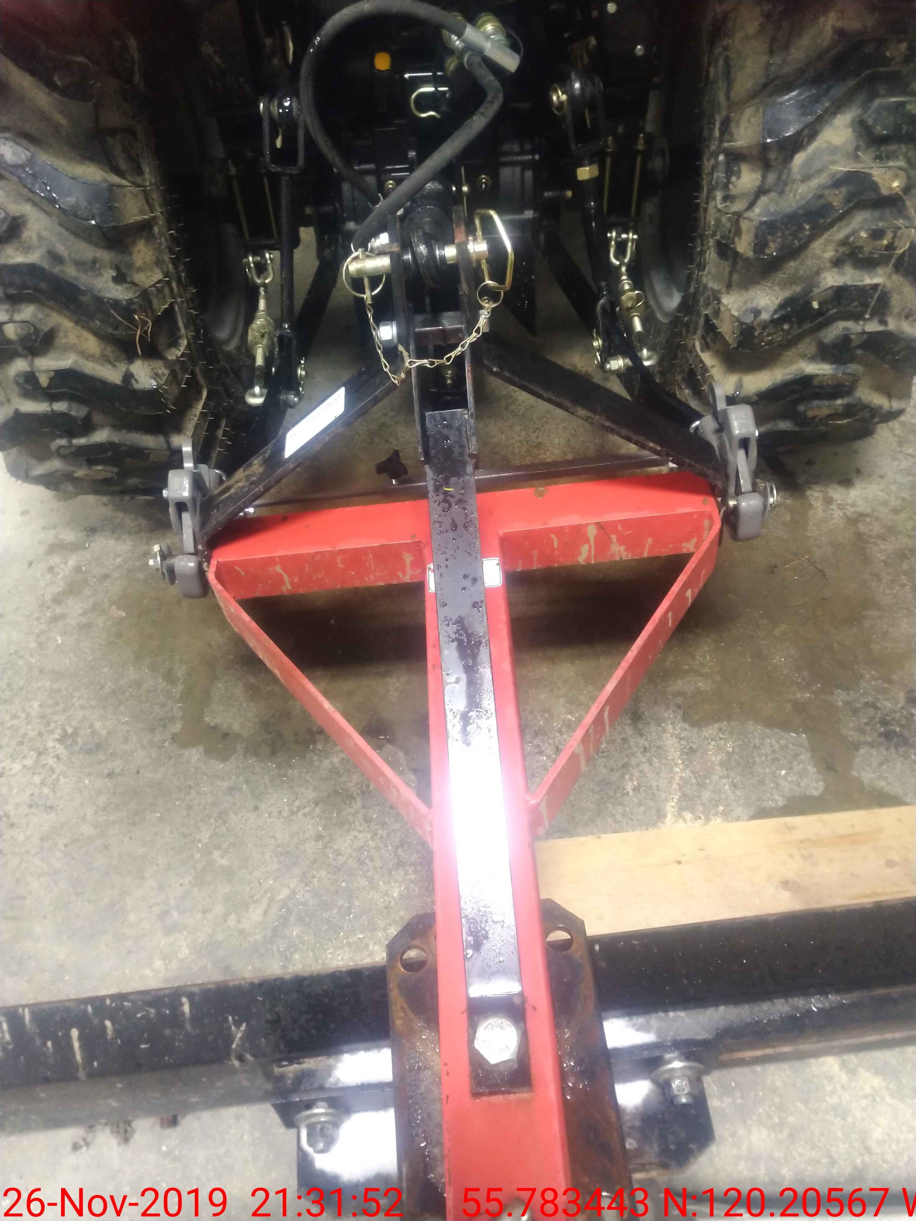

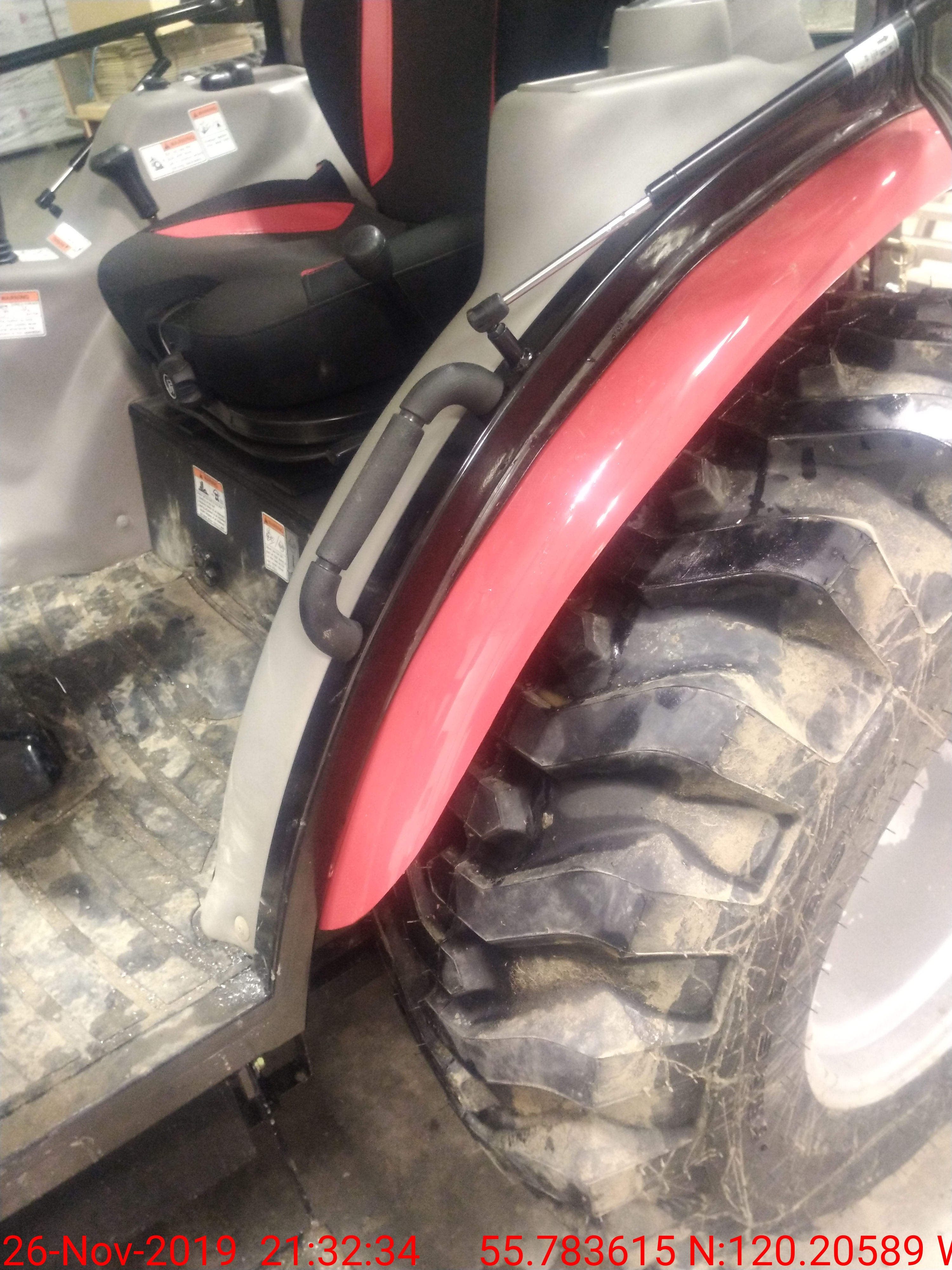

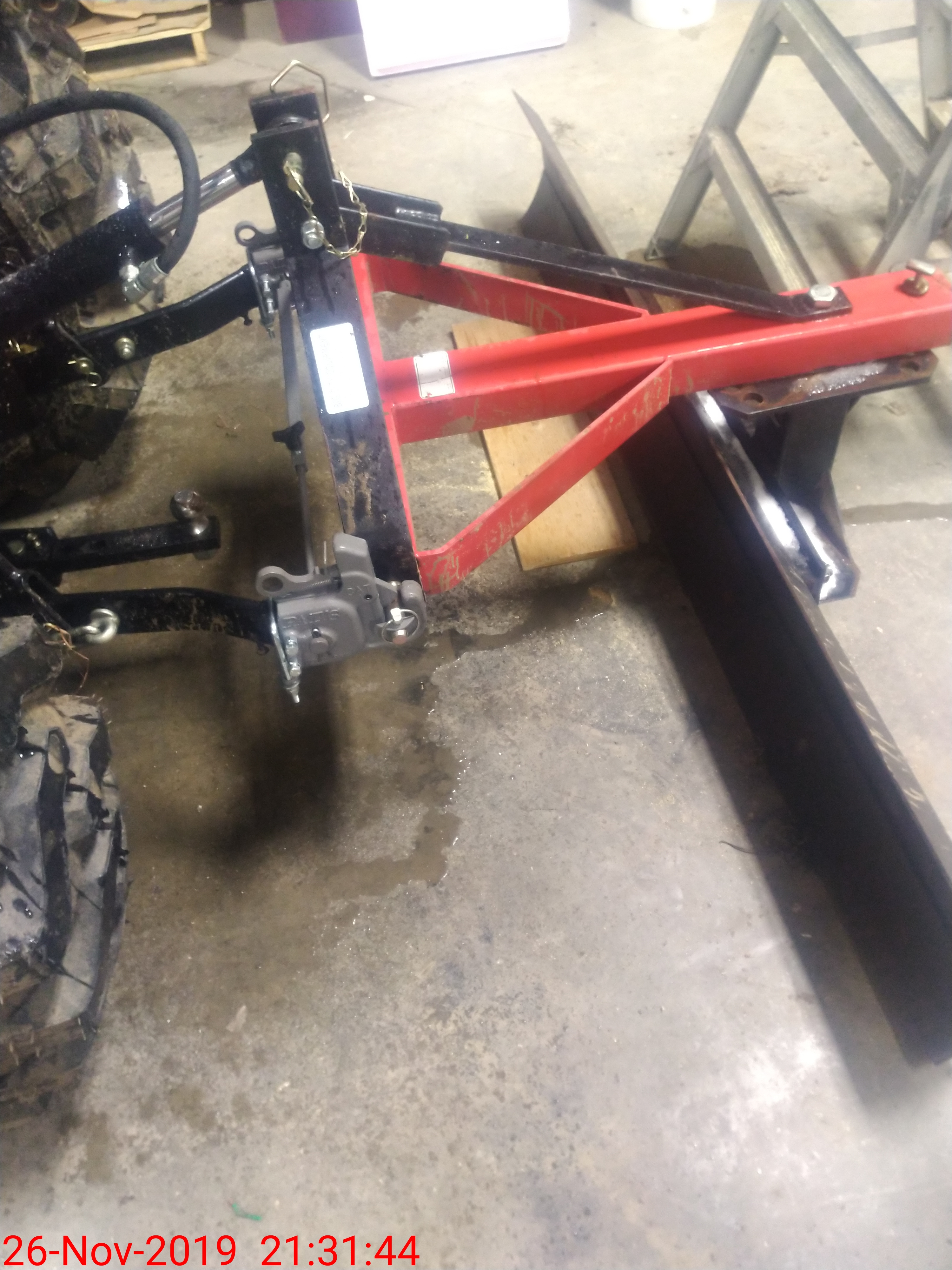

Here are the last pics with my new Pats Easy Change and a handle in the cab for easy exit imo.
should have bought Pats years ago...:mur:
IMG_20191126_213144.jpgIMG_20191126_213151.jpgIMG_20191126_213209.jpgIMG_20191126_213233.jpg

The handle is from the 2638 open station model. Drilling holes are a bit tricky with the curve in the fender.... had to buy 8mm coupling nuts as the handle is molded with bolts. Then a 8mm x 25mm bolt from the underside. Used blue locktite on all threads. Easier for me to get out of the cab now 👍
