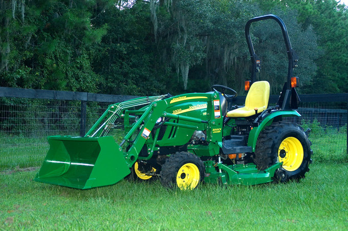

Howdy everyone. My wife and I just bought a new 2320 w/ 200cx FEL and 62d MMM last week. With much help from the posts we read here we feel we bought the right tractor. So, I wanted to share a pic with everyone and say hello as a new member. It has been working great. I agree with others, this is a grass mowing monster :D We have had a couple issues though...
While the wife was mowing a pasture the other day, the tractor started to overheat and we had to wait 'till it cooled before starting again. We had to blow out the front grille screens twice before finishing as they were full of grass. Since then, at the recommendation of the dealer, I lowered the front of the deck just a tad and this seems to have reduced the amount of dust being thrown out of the deck. I saw in a previous post about someone having the same problem with the front grille screens filling up with dirt and grass causing the overheating. I can't find that thread again. Is this a common issue and if so, what was the solution?
Also, the manual isn't really clear about whether to leave the engine at idle speed for long times. Is it OK to leave the engine at idle while working off the tractor, or should we shut it off every time?

Is that what my 2320 looked like brand new??? Wow, not a scratch on it!
