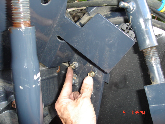

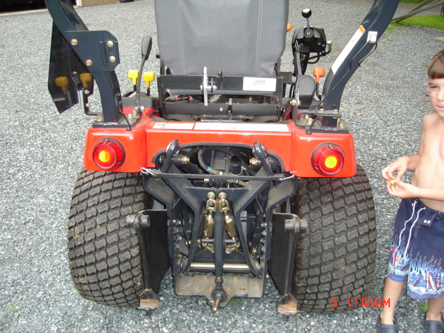

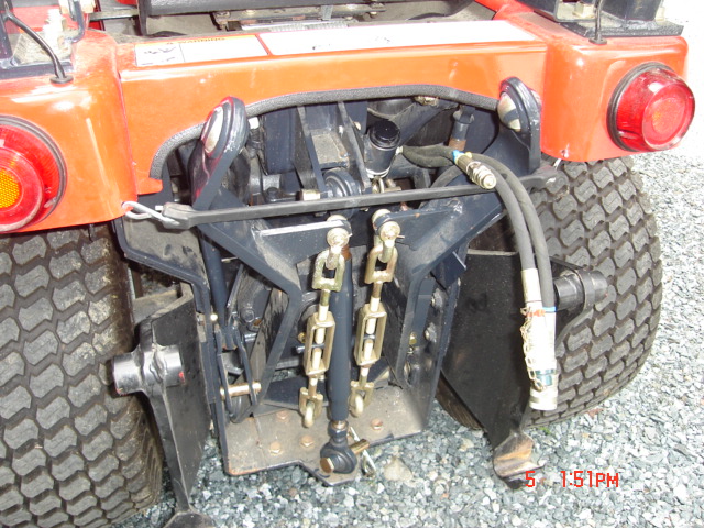

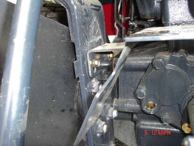

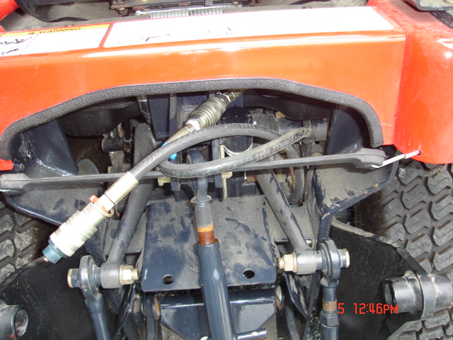

Paystar-- last summer when I had mine off, I took some shots of the set-up.
After BH is removed, there is the rubber bungee cord that holds the 3PH arms up, which will drop down immediately (as Jaybrad discovered...:D).
There's also a PTO cover which is held on with 4 bolts, but, for storage/BH installation, 2 are removed, the other 2 loosened, the cover rotated upward, the first two tightened to hold the cover up, and the pulled 2 replaced to keep track of 'em. Hope the photos are clear enough to figure it out--!
The only real PITA is the PTO cover.... but I wouldn't consider not placing it in the down position when using the 3PH.
First 2 shots are what you see after the BH is removed; one extra pic of the hydraulic fluid sight glass (oops!); the last picture is with everything down & ready to use 3PH.

Jay- hope you could read my margin notes, but remember to NOT remove all those bolts at the same time on the rear PTO cover-- there's a loose plate behind the frame that those bolts go in to on each side, and if both bolts on one side are removed, the plate will drop --and (most likely) immediately cause a string of expletives to emanate from one's mouth. As they say, don't ask me how I know!:D:D

That's it. Pull 2 clips, remove the pins and the trailing links swing up - all held nicely in place by the rubber bungy cord. Then you hook two of the hydraulic hoses together (a cap goes on the 3rd) and you're good to go. It is a whole lot easier than what those orange tractor people have to do.
