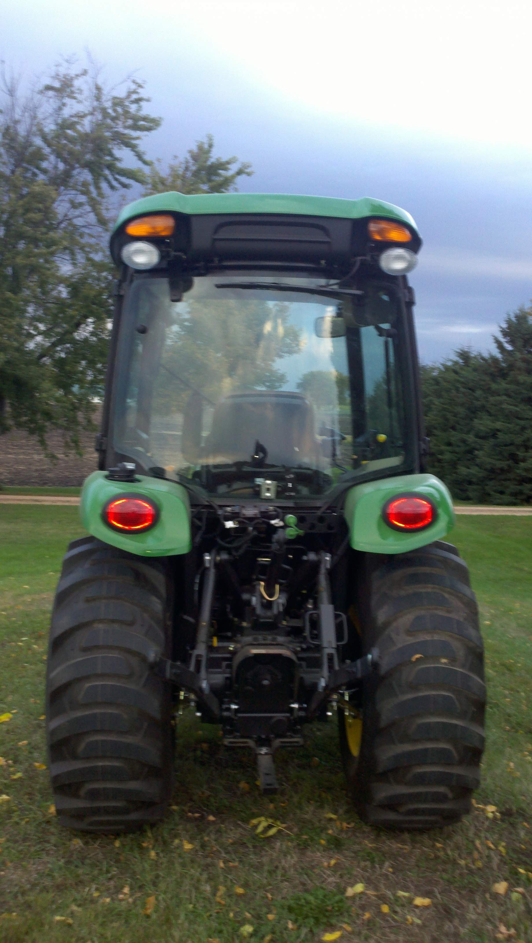

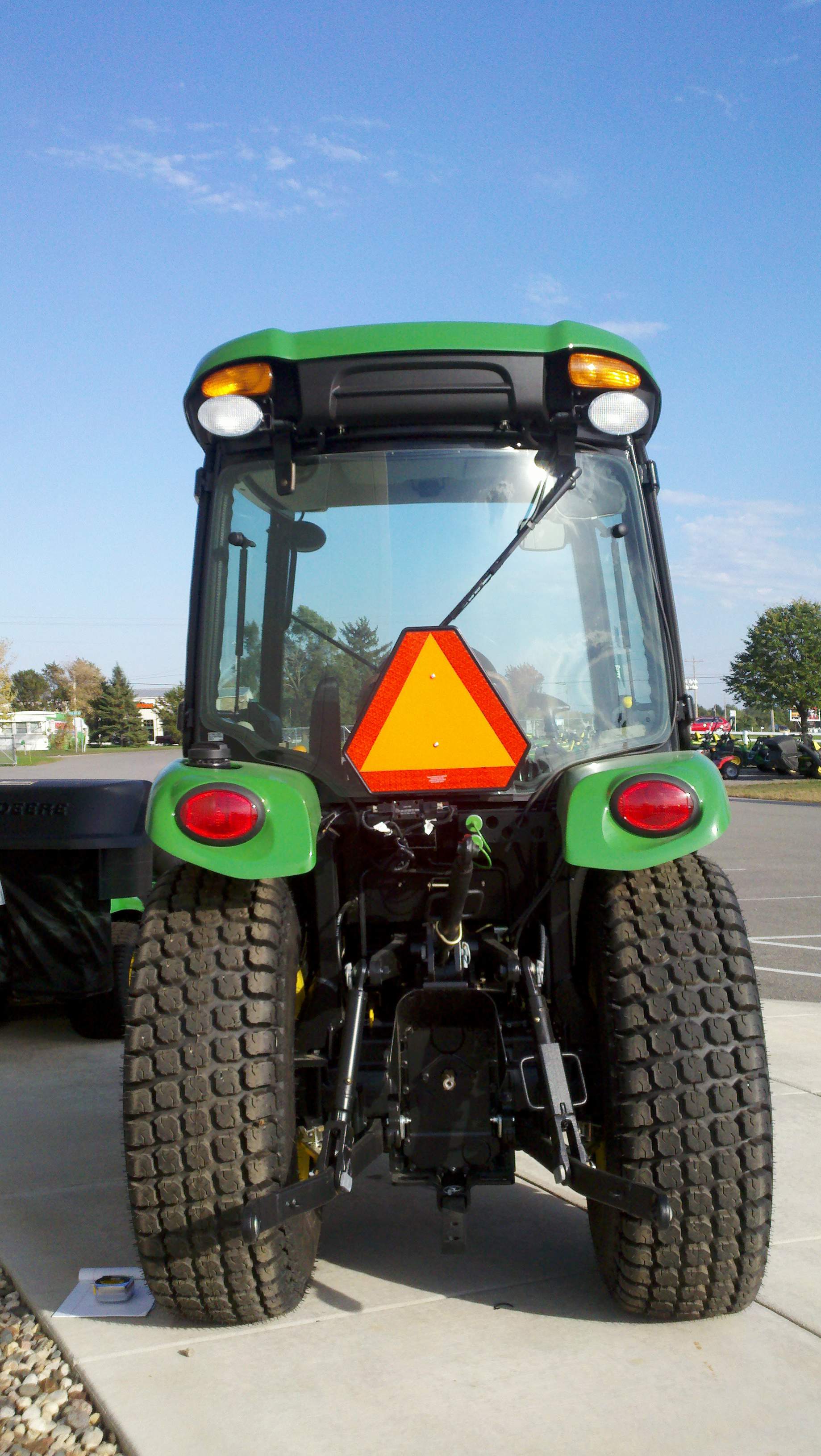

I struggled a little over the tire choice, turfs or R4's. I was going to go with turfs, they had one tractor with each on hand (the tractor with turfs was at one of their locations an hour away). So, I grabbed a tape measure & made the trip, that was the tractor I wanted (with turfs). I am NOT going to be doing dirtwork with it. Primarily snow moving, with light duty work around the place during the summer including tilling the garden and other misc. things that require going across the lawn. I was surprised by this.
Overall tractor width, to outside edge of tires:
3720 w/ R4's = 59" wide
3720 w/ turfs = 55" wide
Rear tire (tread contact area) width:
R4's = 16 1/2"
turfs = 14 1/2"
Rear tire overall height & rim diameter = same
Front tread width:
R4's = 8 1/4"
turfs = 7"
So, turfs have more surface contact area when the footprint is identical, that is obvious, but in real life you have to factor in the fact that the R4's they use are wider. Not making imprints in the lawn is important to me, even though I'm not going to mow with it. I decided to go with the R4's; the deciding factor for me was overall width, you get 4" more of overall tractor width / tractor stability with R4's. You can see this by just looking at the two, the R4's stick out of the fender wells further. Looks meaner too...

Fyi, If the turfs are only at 55" wide in the rear it's because they're set in the narrow position. If you flip them to the wide position you'll get the same 59" as the R-4s.

Thanks! I was wondering if that wasn't the case, dishing them out would add a few inches of width. I probably would have gone the other way if I had known that but hopefully it's not a big deal either way. I'm more worried about the R4's not being good in snow than anything. Most people seem to have R4's on this size tractor so they must work OK in snow.

I don't really like my R4's in snow...I get by, but the fronts don't have much lateral traction. Turfs would be better. Steering brakes help. I thought about getting some chains.

It really is how you'll most use your machine. I use mine all winter snow blowing (front mount) and all spring, summer, fall, finish mowing, R-4's would not be an option for me. I might use the loader 10% of the time. That said the turfs work very well. I just stay out of the mud ;)
I think the upgrade to turfs is around $300. Not bad imo..
