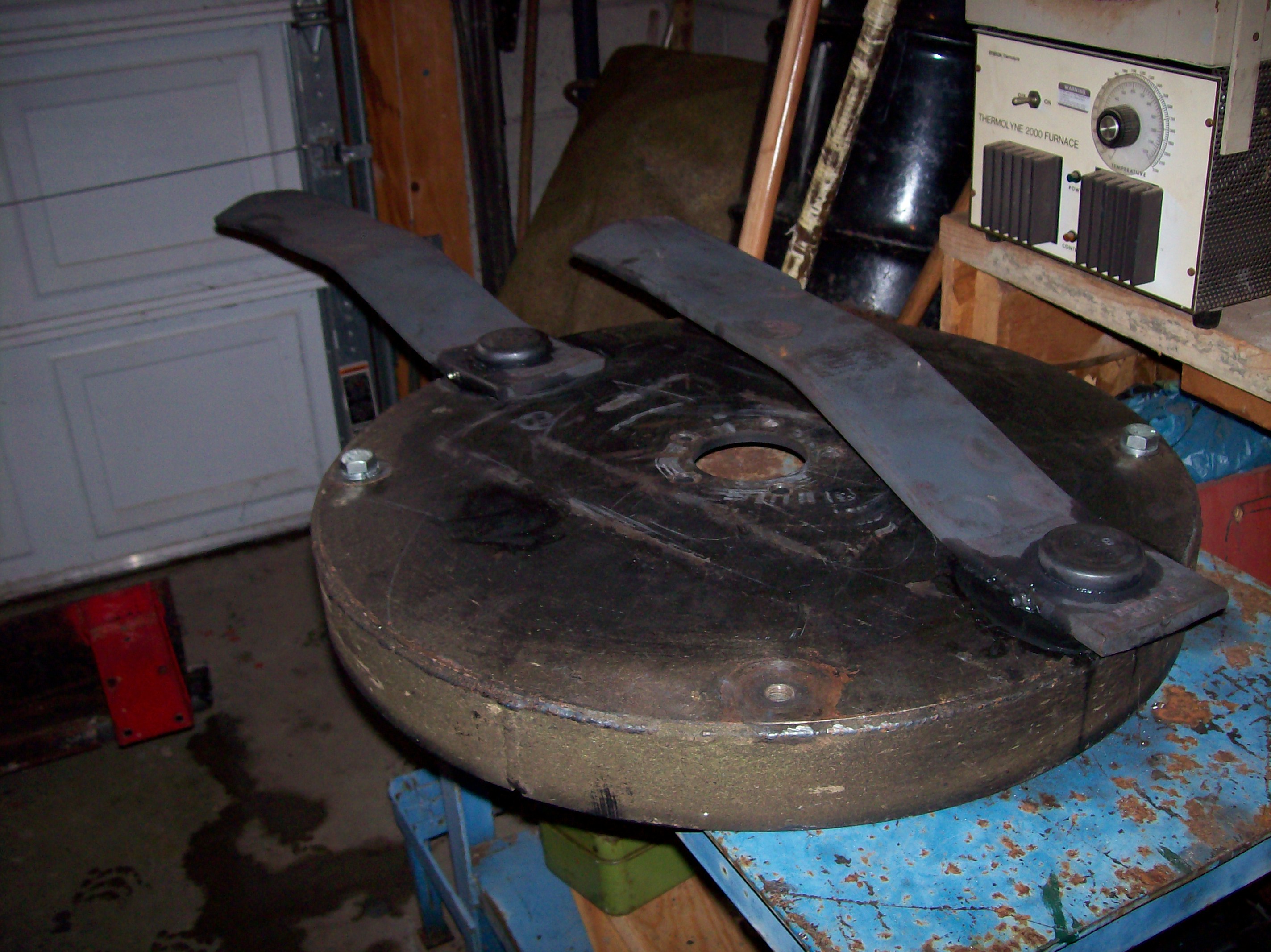

The main reason that I bought the 1445 was for mowing 20 acres of over grown hay fields. Mowing grass and weeds 5 + feet tall to 6 inches did not pose a problem for the machine, routinely mowing for 2 or 3 hours at a time in 80 to 90 degree temps. I usually blow out the engine cooling fins with compressed air when ever I take a break. A habit I aquired from mowing with my Farmall H, the radiator would always get plugged up while mowing. I did have problems with the mower flials ( blades) . The 5/8" mounting bolts and bushings wore out very quickly, I had to replace them twice. The secomd time I replaced them I installed grease fittings to grease the bolts and bushings this stopped the wear problem as I regreased every few hours. I broke a few 'stop bolts' while cutting brush so I decided to make a few changes.
I removed the old blades and stop bolts and welded 3/4" thick x 2 1/2" reinforcement to the inside of the stumpjumper. Drilling through the stumpjumper and reinforcement I mounted two new 4" x 25" - 2" offset flails
with 1 1/16" bolts. ( This is basically the same setup that was on the Bush Hog mower that I used with the Farmall.) The offset allows one flail to pass over the others mounting bolt with out hitting it. The new flails weigh 15 lbs
each ( about two times the weight of the old ones ) which will allow them to more easily cut through thick tall grass. I have also installed grease fittings on the new flails...just in case. I got the new flails and bolts from Flail Master on the web. I will need to modify the wheel mounts on the mower to raise it about 2" because of the offset on the new flails. I will be trying out the new setup this spring.

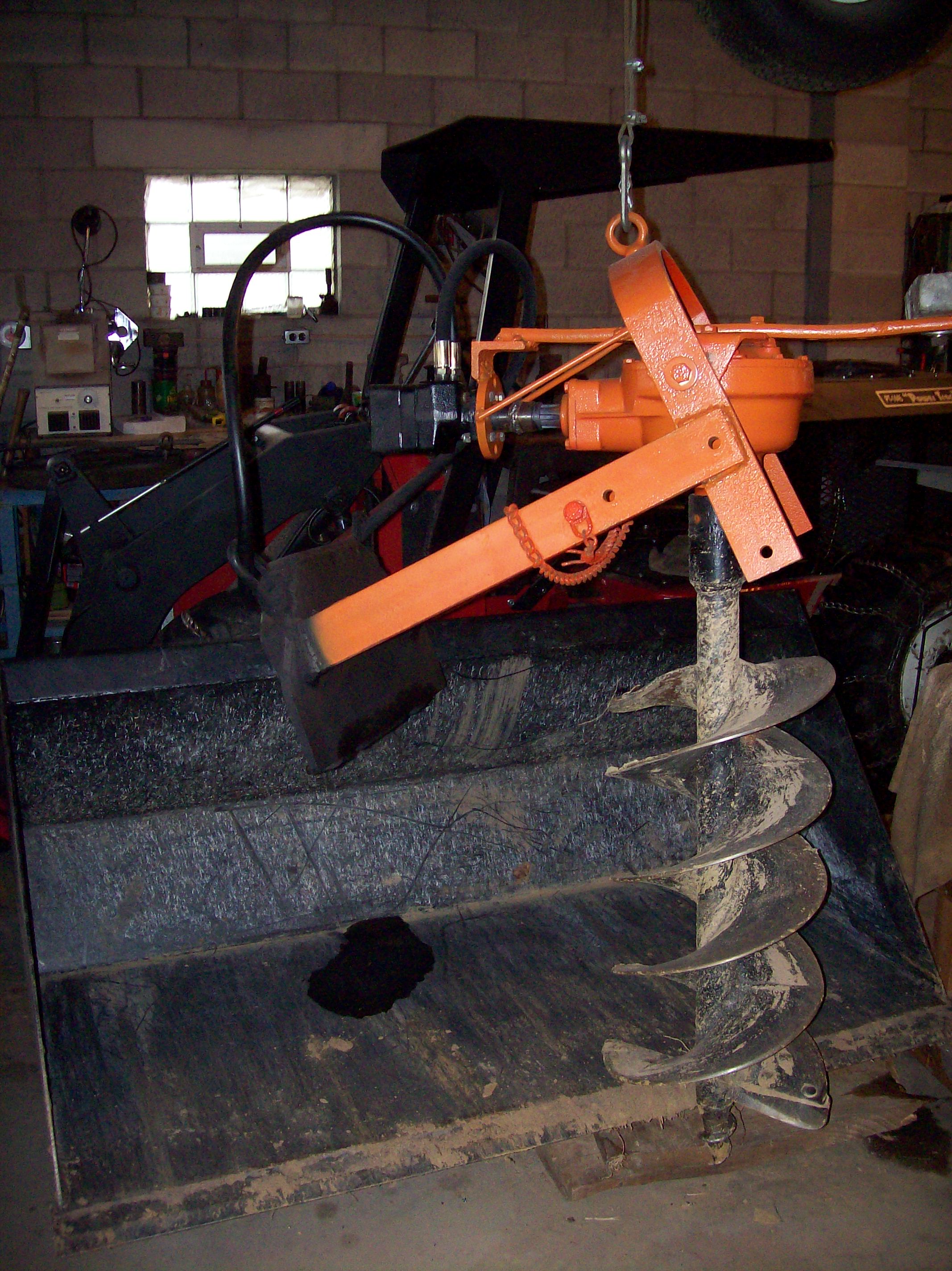

I have put together a posthole auger using an old gear driven auger and mounting a 6.5 cu.in. hydraulic motor ( Surplus Center ) as a drive unit.
This motor is rated at 534 rpm at 15 gpm pretty close to the 540 rpm rating of the gear unit. This is not lacking in power I only stalled it once when I hit a very large root, bent the top of the 12" auger flite - it is 1/4" thick.

Nice review of your machine. Your posthole auger project turned out well. I am glad you like your machine. Thanks for sharing your project pictures.

I did have problems with the mower flails ( blades) . The 5/8" mounting bolts and bushings wore out very quickly, I had to replace them twice. The second time I replaced them I installed grease fittings to grease the bolts and bushings this stopped the wear problem as I regreased every few hours. I broke a few 'stop bolts' while cutting brush so I decided to make a few changes.
Awesome job! I have the exact same problem with my brush mower. Did you actually drill the holes for the zerk fittings? Wow! How did you do that? Drill press? Cobalt bits? Please tell us!
-Rob :)
/ New 1445
#15
The flails are not as hard as you may think. I drilled them on a drill press with a regular steel drill bit. I used 3/32" to make the passage then drilled a pocket about 3/8"deep which I tapped 1/4-28 for the grease fitting. Use plenty of oil and go slow.
