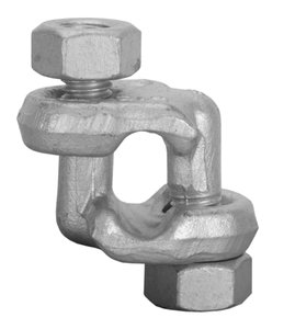

/ Never saddle a dead horse #5
And for those who can't tell if the horse is dead:
5/16" Cable Size HDG Double Saddle Wire Rope Clip | Fastenal

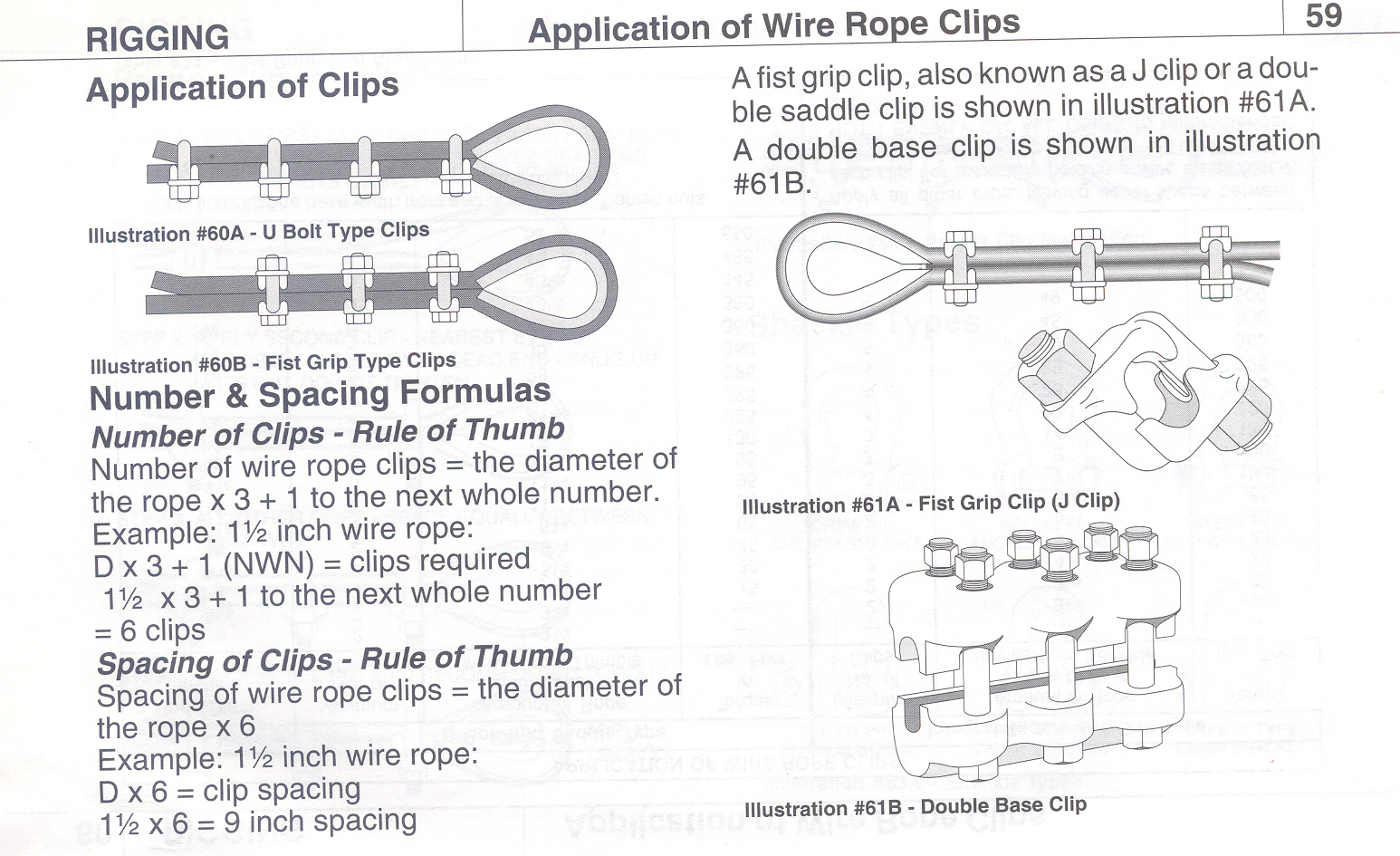

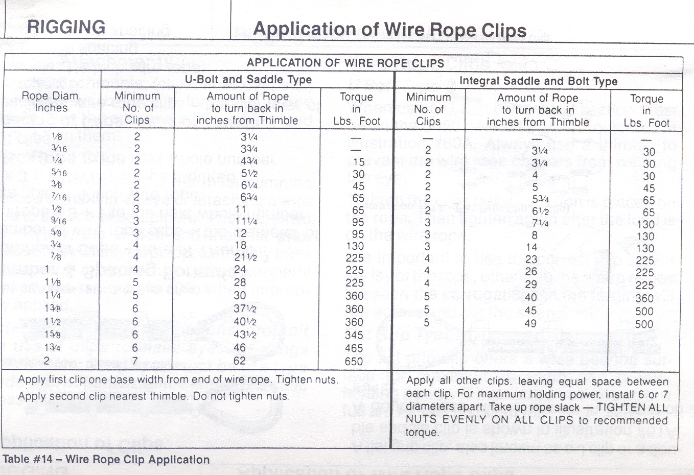

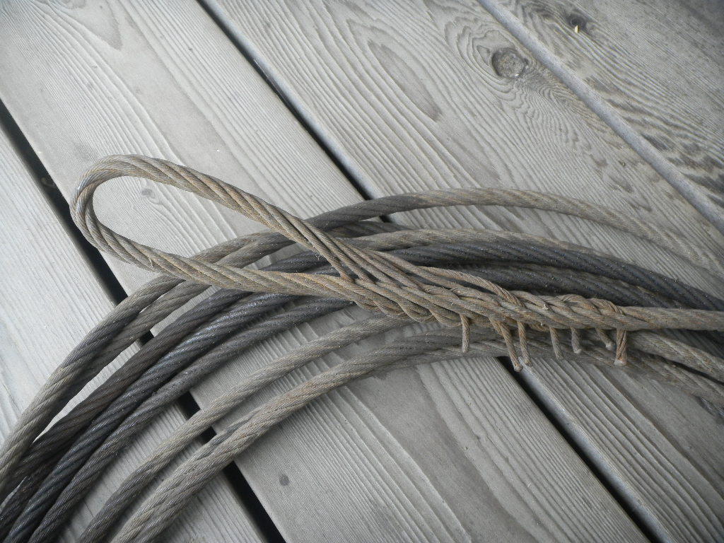

/ Never saddle a dead horse #7

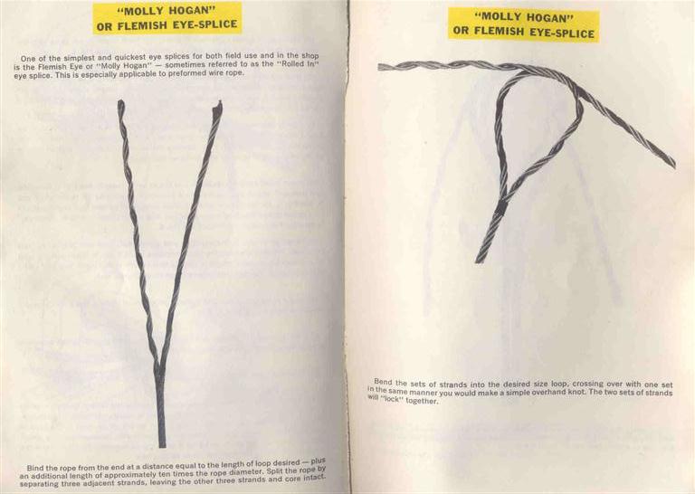

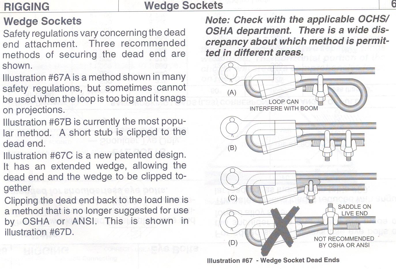

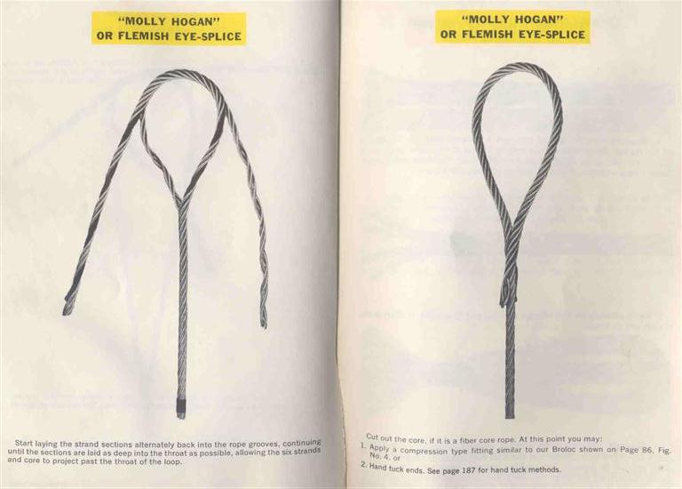

There is more to installing cable clamps, than the proper rotation, a lot more. Proper spacing, and torque.
Personally I try to avoid making eyes where you have to depend on the cable clamps. I'd much rather roll a Molly Hogan, and leave a long tail and wrap with electrical tape. Or if I'm really going to max out the wire rope I'll make a logger's splice.
There is a reason OSHA out lawed attaching a cable clamp to the main line after a wedge socket on a crane. The cable clamps break the small wires in the strands of the wire rope.:eek:

The one thing to watch out for on the Molly Hogan/ hand splice/flemish eye splice is if when lifting the load starts to spin, its possible for it spin enough to cause the splice let loose/come apart. We use the Flemish splice with a swaged sleeve pressed in a shop setting. Not practical to install in the field I know, just giving those a heads up if they try the molly hogan/hand splice/ Flemish eye splice and lift with it.
The one thing I have ran across is that the hand splice is a lot more popular up north/Canada than here in the south
/ Never saddle a dead horse #11

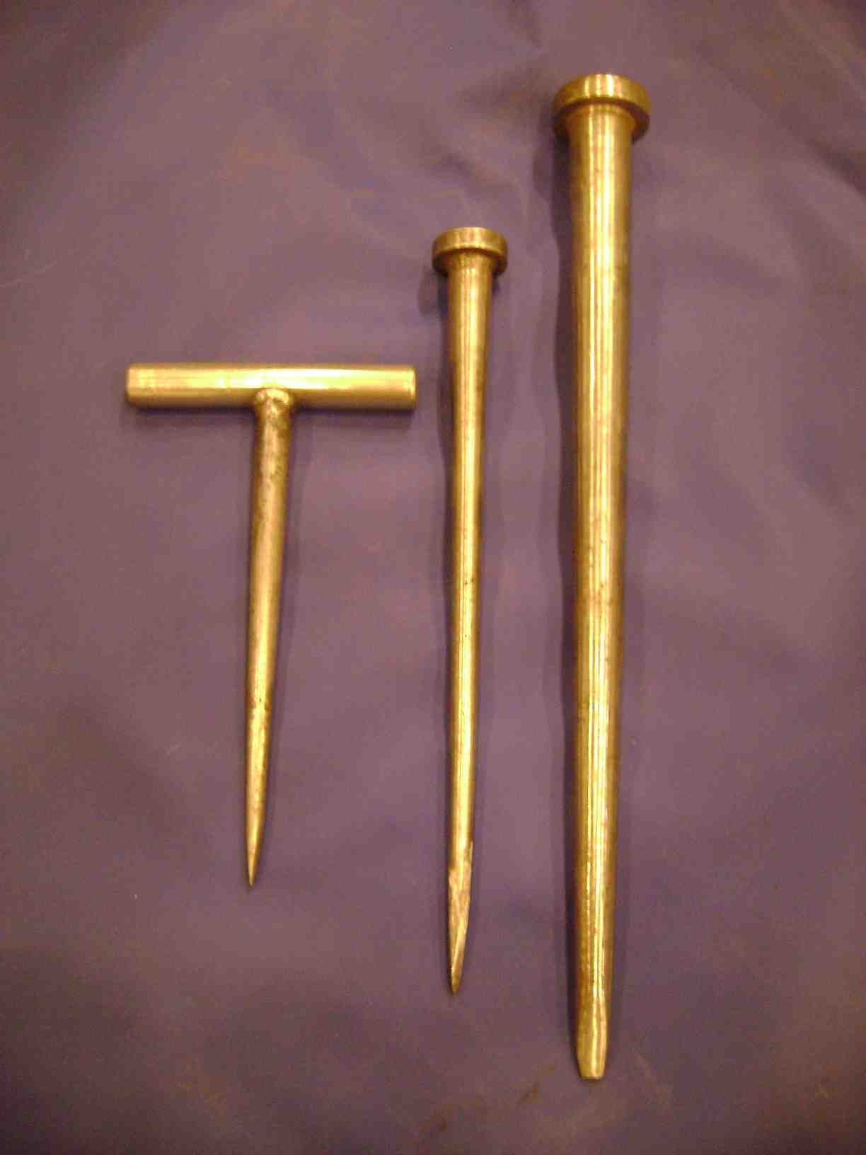

Actually the Molly Hogan, and eyes made with cable clamps are illegal for over head lifting. I'm sure by now the logger's splice is too. For years we all carried Marlin spikes in our tool boxes, and made all our rigging right on site. Sometime in the 1990's our safety department / insurance company put a stop to it. They wanted a third party to sue if anything happened to us.
I've never seen a Molly Hogan or logger's splice spin out, a Marine splice yes!

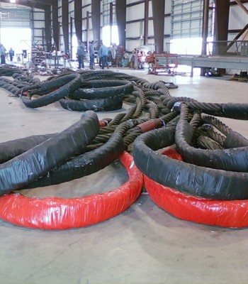

No doubt! The biggest cable we splice and press is 3-1/2", usually atleast 4 guys on an eye to splice it.. Check these braids out, 2" wire rope, braided

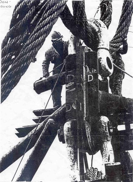

Here is some 4-inch, we used for 300-ton picks.

Now those are shackles.Nice to see a big pick rigged. What were they lifting? As Paul said,'the rest of the story".
