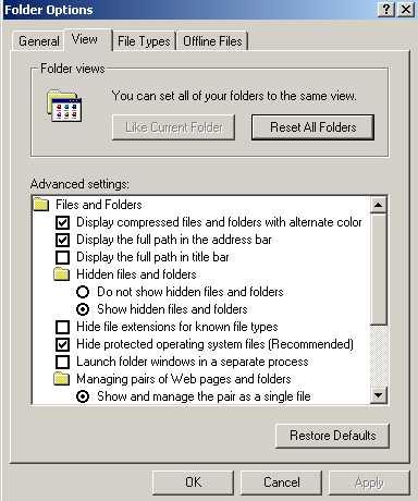

Mike and Peter, I went into folder options and changed the defaults. 'Show hidden files and folders' is now 'on' and 'hide protected os files' is off. I can now view the 'program files' folder from the win2000 machine without clicking through the 'idiot' warning. I thought this would be the ticket and allow me to see those files across the network when seated at the win98 machine. No such luck, I still get a script error when trying to open the 'program files' folder on the win2000 from the networked win98 machine. I don't really have any good reason to pursue this problem, other than it's a curiosity at this point.

Jerry, can you post the full text, and perhaps a screenshot, of the error message you're seeing?
