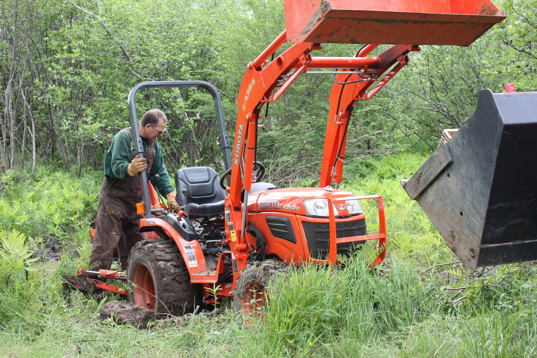

Did the neighbourly thing today. A new neighbour(actually friend) bought the property next to me and to fulfil his dreams bought a new Kubota tractor to play with. 20-25 hp thing... He has managed to get it stuck and unstuck without embarrassment... until today.
So I get the call and drive down the lane and road to his property and Yes! He is stuck.
I hook on and pull... at least I think I did... didn't feel like it.
Pics to follow... we shared a laugh... all in good fun. He is rethinking the size of tractor.
I told him not to sell this unit but to buy an additional one. Always good to have a second tractor... just to pull the other one out!

No... not at all. I gut stuck and managed to get unstuck several times. At some point your luck runs out. His did and mine may at some point.
And he may have got stuck due to the size. He even acknowledges that. He now realizes that his tractor is undersized for the things he wants to do. Like he says "I now have a very expensive lawn mower" - he does have a mower deck for the unit too... and a chipper, BH etc... and I am jealous. Would love to have it as a mower!

I would get a set of R1 tires and rims to use in those conditions and the winter.

Now, he got stuck for 2 reasons - a bit of inexperience, and the wrong choice in tires.
A lot of those small tractors are sold with the wrong tires. Those construction type are not made for traction, they are made to wear well on highway use.
Get good tires on that little tractor, and it will be a whole different animal.
With more experience and proper tires, it would be very hard to stick a light tractor with a loader & backhoe - it should be able to work itself out of 95% of the stuff it can get itself into.
Lot of small tractor owners have no experience in using the things, and they make poor choices on the accessories - like tires. I see that on here all the time, questionable recommendations on tires or properly weighting a loader tractor.

I can easily understand getting stuck but I don't understand how a light tractor with both FEL and BH cannot self rescue. He should have been able to use the BH to lift up the rears and push or then stick some logs or rocks underneath. Likewise with using the FEL to crawl out by dumping the bucket while on the ground.

I can easily believe that but looking at the photo in this case the tractor looks more like it doesn't have traction rather than being sucked into a mud pit. There looks to be 5-6 inches of space between the operator platform and ground so the tires couldn't be sunk much more than up to the wheel itself.
Maybe the new tractor owner has never been taught how to self rescue.

A combination of both... behind the tractor was a soupy mud hole. He did have some logs in place. He didn't have enough reach on the BH to push himself out. Also it is a HST tractor and he couldn't use the front bucket to pull himself out. I questioned him on this - and not knowing HST tractors took his word for it. If you or others could fill me in I will certainly pass it along to him for the next time. It seemed to be a challenge to get the revs correct and the ability to use the bucket at the same time.
A buried mine to the frame with the backhoe on. I was in such a muddy/soupy area that the BH could not push me and the bucket could not pull me out when curling it. What I did in the end was to put it in low range, 1st gear, set the revs up a bit and got off the tractor. It took a while but actually crawled out of the hole. I promptly took it home and parked it for the day - figuring I got off easy!
