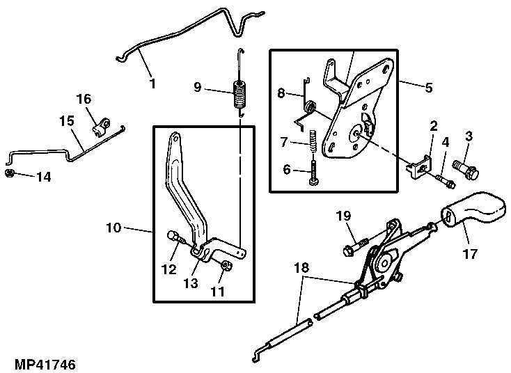

My neighbor had his JD stored in a shed and mice made a home in it and it wouldn't start. After removing the mouses home I repaired the ground wire to the coil that they ate. The throttle was also seized. To loosen it up I removed the two hold down screws and the linkage popped off. I lubed up the pivot and got it working well but when I went to put it back together I couldn't figure out where the two actuator springs went as they also came loose. I'm hoping that someone might have, or wouldn't mine taking, a good picture of the linkage and their spring attachment locations so I can give the mower back to my neighbor to use. Thanks in advance for any help!!!

Take a pic or three and post so we can see what you are having as the problem. May be able to point you to the right attachment locations.

There is a picture in John Deere parts catalog showing the springs. You might try to find it here entering LT155 in the top left window of the pars search.
John Deere - Parts Catalog Will try to upload the picture but have had problems with the forum working right lately.
