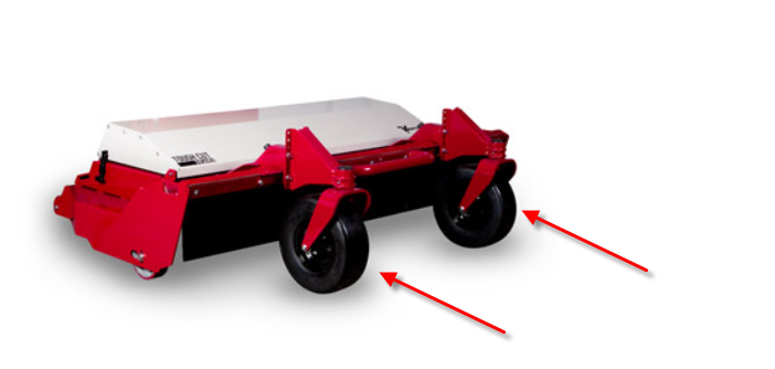

Do you have the front mounted caster wheels that allow the deck to be operated much higher than the built-in wheels? Those should have always been standard equipment, which it seems they now are, not an optional extra.
   / Needs tips on using rough cut
I do and I run at highest level. I have just slowed my speed down and allowing ok. Sometimes I will edge in slowly to a thick shrub with it raised and do one pass and then run it in float and that seems to be a good balance.
