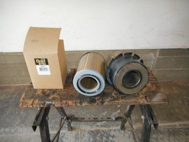

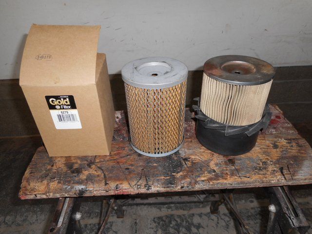

As for air filter I just find recently something that fit with only a minor modification. On my tractor the air filter canister is a Baldwind and I could not a filter replacement here . But at Napa they find by measuring the OEM element a filter Napa 6279 and the guy tell me it is made by Wix and their no. is 546279. The new filter have a softer rubber seal that can seal better.
As for the mod it was simple, I made a washer of thin aluminum the diameter of the filter and a old bearing cup to center the filter in the bottom opening than glued all this with red silicone in the canister.
