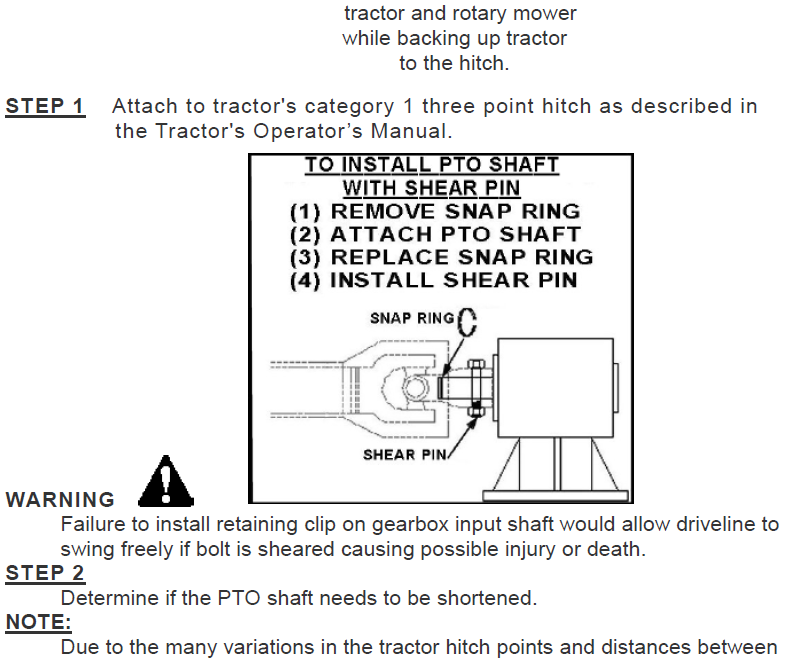

Boggen, I think I understood Snowman say that he is using grade 2 bolts and his tractor is marginally underpowered for the size of the mower he has. His problem is that the bolts are not shearing before his tractor stalls when he hits obstacles.
Given that, sticking with the grade 2 bolt will not protect his tractor since it is already proven to shear at a higher level than necessary.
I concede that cutting a bolt does not provide accurate shear specifications, but then is that necessary or is getting in the ballpark good enough? Sure it might shear too soon from time to time, but that is better than not shearing at all as is the case with the unmodified bolt. Without an engineering analysis of his load and tractor capabilities it is impossible to know the exact shear strength required, so best guess is the best approach I can think of to keep working and dial in an adequate protection comfort level. It will take a bit of trial and error, but each trial will be less risky than continuing on as he has with the existing grade 2 bolts that have not sheared. Don't you think?

picture is from www.kingkutter.com rotory kutter manual

Boggen, If you take a bolt, lay it on the table, and make a small cut perpendicular to the bolt length; how does that allow more play within the hole? The bolt is inserted in the shaft and is the same diameter as before. The cut is aligned to the inside diameter of the PTO yoke and the outer diameter of the gearbox shaft so that it reduces the strength in the same line as the intended shear-line.
I understand that bolt fail and sometime an operator will not notice a sheared pin, but we are not talking about a loose or poorly maintained bolt. Regardless of the operator's attention to the job, the shearing of a pin is the intended result when the workload exceeds the capacity of the equipment. In this case the problem is that the mower is more capable than the tractor. When he hits a rock or stump it stalls the tractor rather than shear the pin. That is a problem. His pin needs to break before the tractor does.
Btw, I just got confused about what you intended with the manual page. I know where the retaining clip and shear pin go. That has not been an issue in the thread thus far. Did you have another intent?

For instantanious loads, It's not the HP of the tractor that decides it. It's the inertia of the rotating mass. A bolt shears in milliseconds when you hit a rock. for example: The govenor on a 100hp tractor could be at your 25hp when the bolt sheers, it happens too quick for the govenor to direct the injectors to increase the fuel to increae HP. So you 1) add mass to your PTO shaft ( weighted collar, etc..). 2) use a fully threaded ungraded bolt, or un-hardened threaded rod, or 3) go down to a 7/16 ungraded bolt. Home depot's clear head bolts are nice soft junk. Cutting 1/2" bolts can wrk but it's more trouble and less reliable because the needed inital stress riser points can be where you didn't plan for them with cuts
