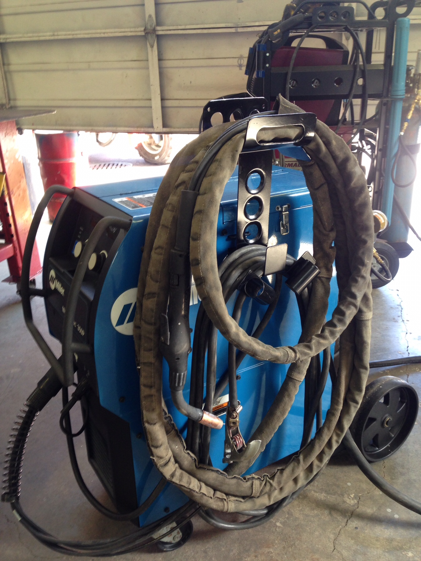

To the OP. You have a nice machine so you may as well take advantage of the capability of push/pull.
I had a Miller 350P with a Cobra push pull gun. Really nice to use compared to a spool gun which is a little unwieldy in comparison.
A good welder friend had a big aluminum job coming up so I sold it to him as I really didn’t use it much anyway.

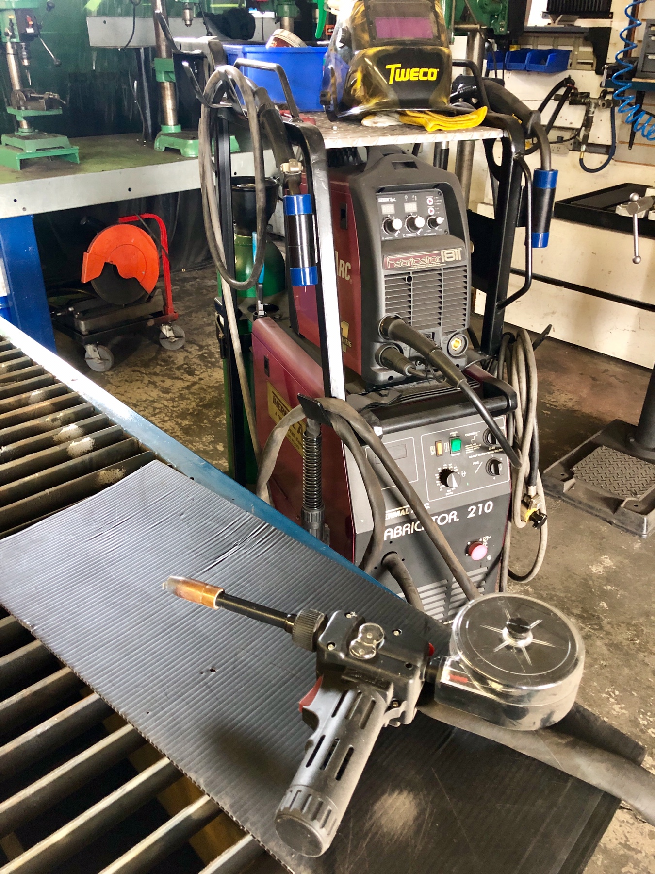

I have a push pull feeder for my Miller XMT 350 but just use my spool gun for the odd aluminum job.
This is my light duty “go to” spool gun for smaller aluminum projects I use with my Thermal Arc 181i
