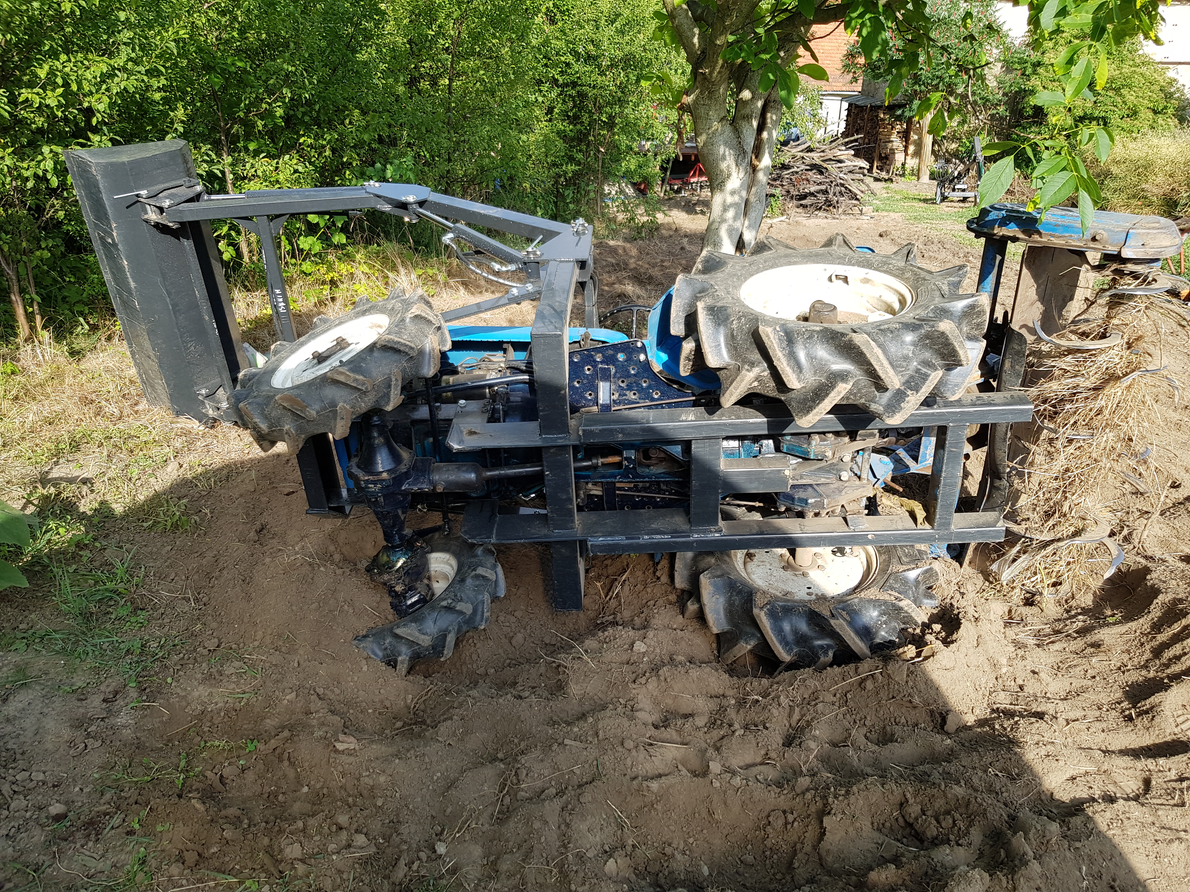

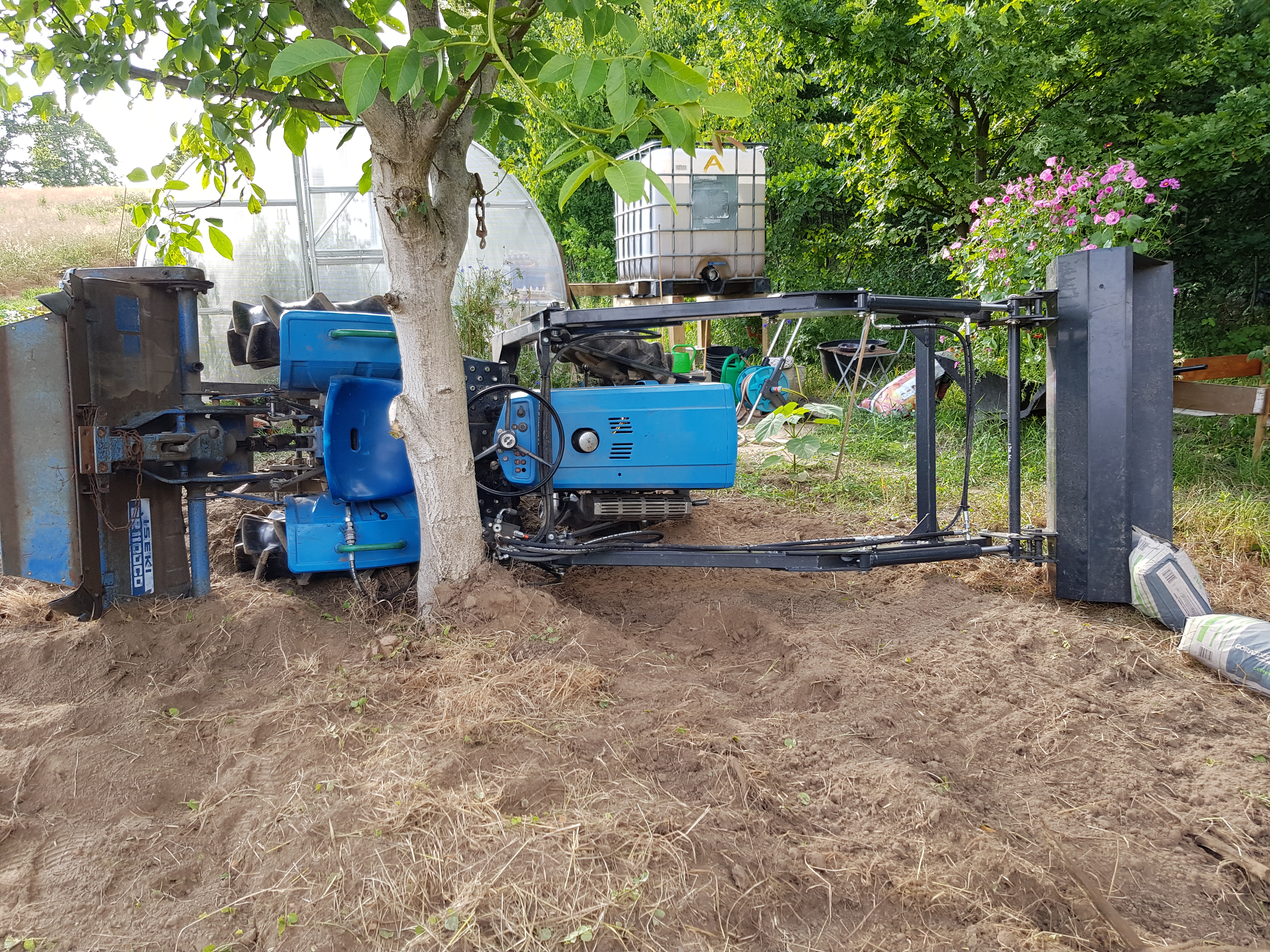

Seriously, after 6 months of tractoring i already found that danger lies in small corners. After last weekend's adventure i had to promise my beautiful wife to take things slower:
But thanks all for the consideration...
