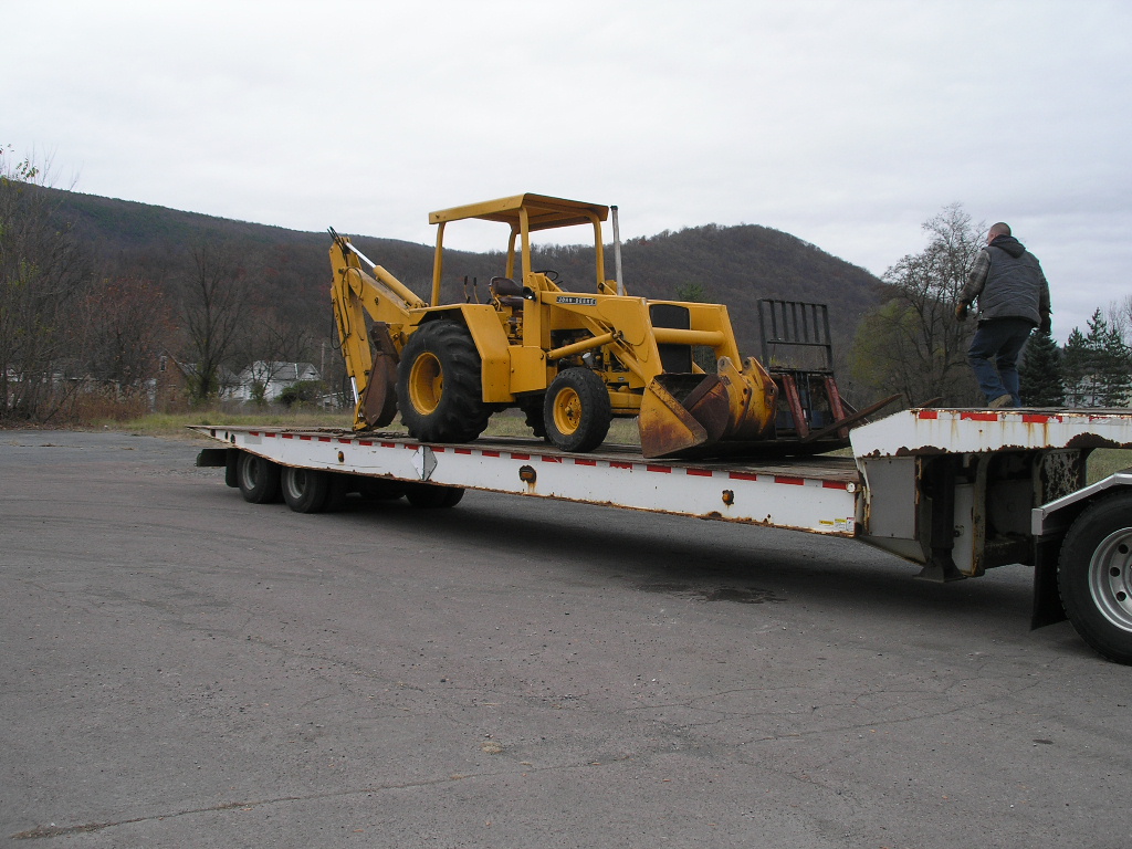

Ok, thanks. I downloaded them about 1 1/2 years ago and it seems the 4 service files are still there but I couldn't find the 2 parts manual files on my visit a few minutes ago.
