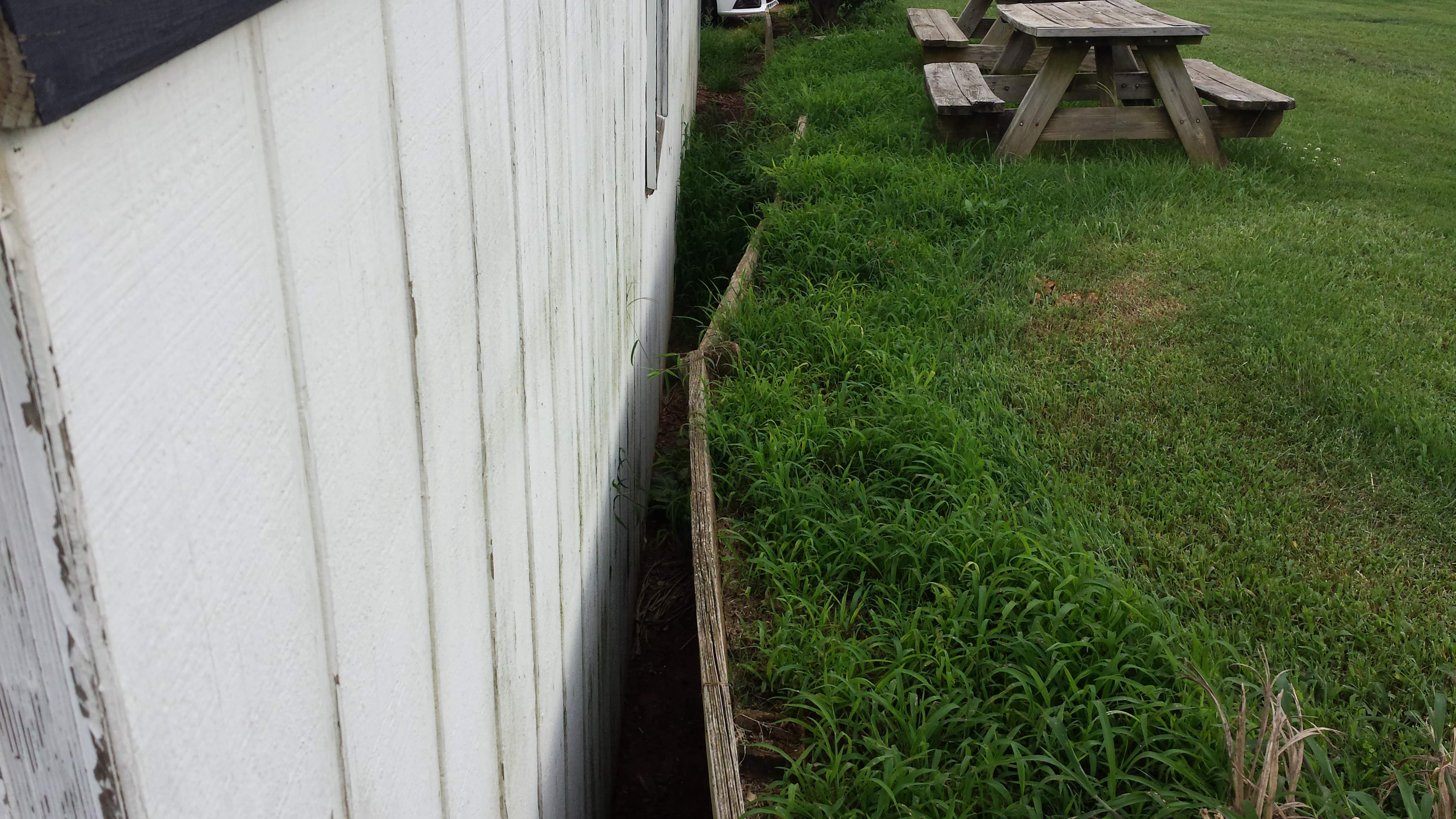

I've got a ton of projects to do on the farm so I thought it might be fun to ask opinions before I start. I'll be happy to post pics as we go, along with the finished product.
Obviously the barn needs some TLC but with all the rain we have been getting, I don't want this crashing into the wall creating a bigger mess.
Remove some dirt with a backhoe, right?
I figured I'd rent one and dig up some stumps while I had it.

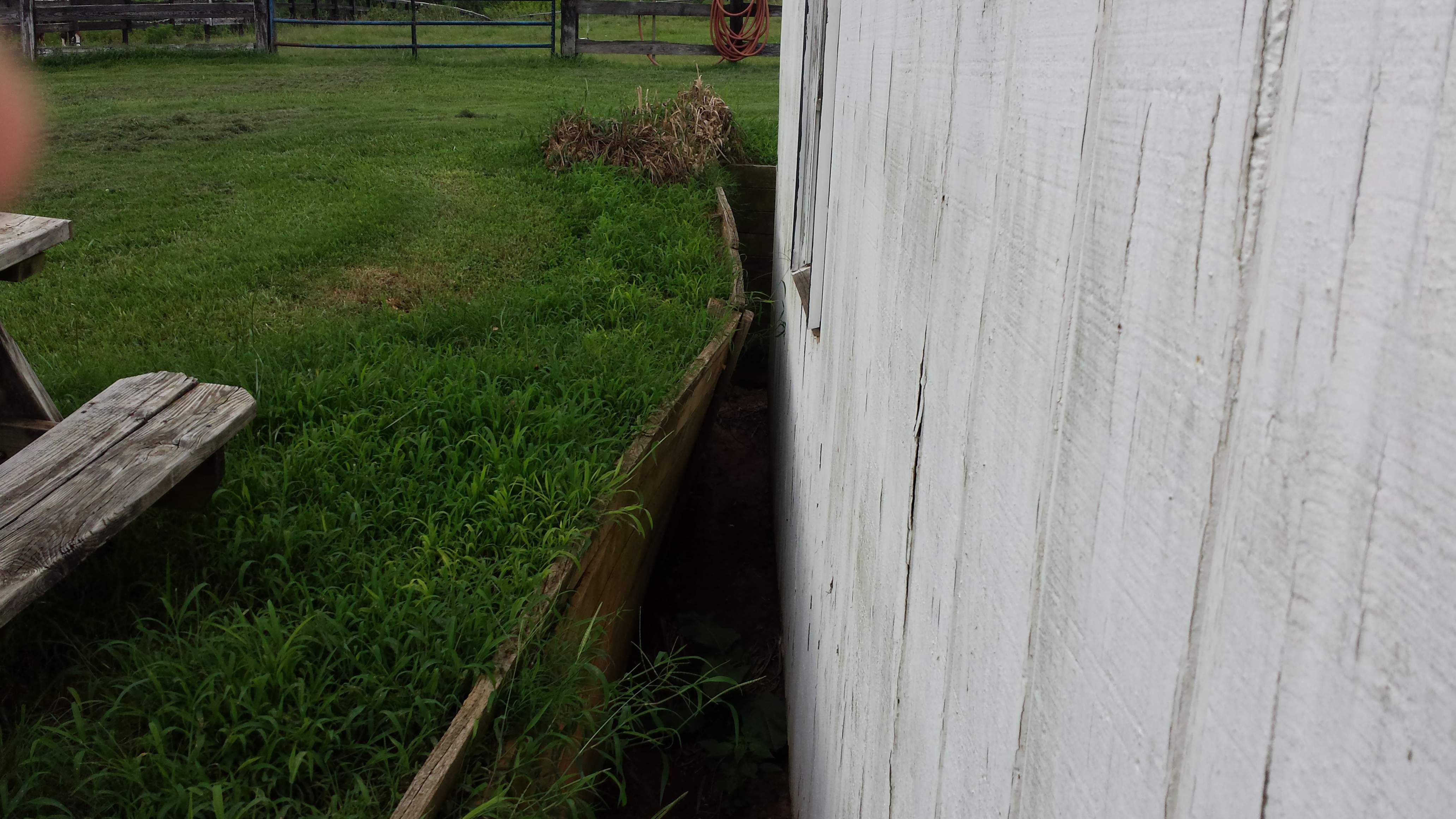

The wall is almost 5' tall if you stand next to the barn. It has 4x4 posts and 2x6 boards. I know, someone else's masterpiece here. Whats worse is that the boards are nailed to the back side of the posts.. I can't believe most haven't sprung loose. The pics don't really show it but it appears one or more of the posts came loose or it broke, and the dirt continues to settle.
I was going to dig a bit further than the failure to inspect the next 4x4 post, in each direction.
I was wondering what I might need to do to make sure this does not happen again. I've seen stronger walls, made with railroad ties and the like.
I've heard of using "dead men" to strengthen the wall.
I was thinking after the dirt is gone to concrete in about 4 new posts.
What do yall think?

No offense, but a mowing pattern obvious in the 1st pic says to me that the rain pro'ly had some help 'settling' what's behind the 'wall'. Moving the table nearer to the post later on might get you more years out of a rework if you're using one of the tractors to mow that close there. (Looks like no picnic to mow around the table either way.) That little slope towards the boards' top is scary too, if it allows runoff to collect along it. Looks like that has been 'snowballing' on you for a little while.
If digging is easily do-able, I'd start over and make sure the grade sloped away from the wall when finishing, touching up as it settled again to stay ahead of things. Looks like only the one post would need a dead-man, and that would seem to be a necessity. Any reason not to make that two posts & shorter boards if you replace them? Adding a drain tile behind the wall might be a bit much, but wouldn't have to be full depth (5') & need not be too close to it. (2'-3' & it's not a problem wet spot.)
btw: IMO, a dead-man doesn't need to be a 4x6 or heavy timber but the anchor(s) might want to be that or more, and you might want them both notched to not pull apart. An iron beam to connect anchor to post might rust to nothing someday, but might last a few decades before you dig/redo again later. Either mat'l, under a tension load might handle more force than what fastens the pieces together.
I guess I'm saying that PT wood is as good as masonry if done right. I'm sure it would run less $$, even with all new materials, but I'm way cautious and thinking of the fuss a redo in 20 yrs might be if it's needed again. Concrete & blocks stay hard, but they don't always stay exactly where you put them. ;) How long has the old wall been there & held up as well as it has??

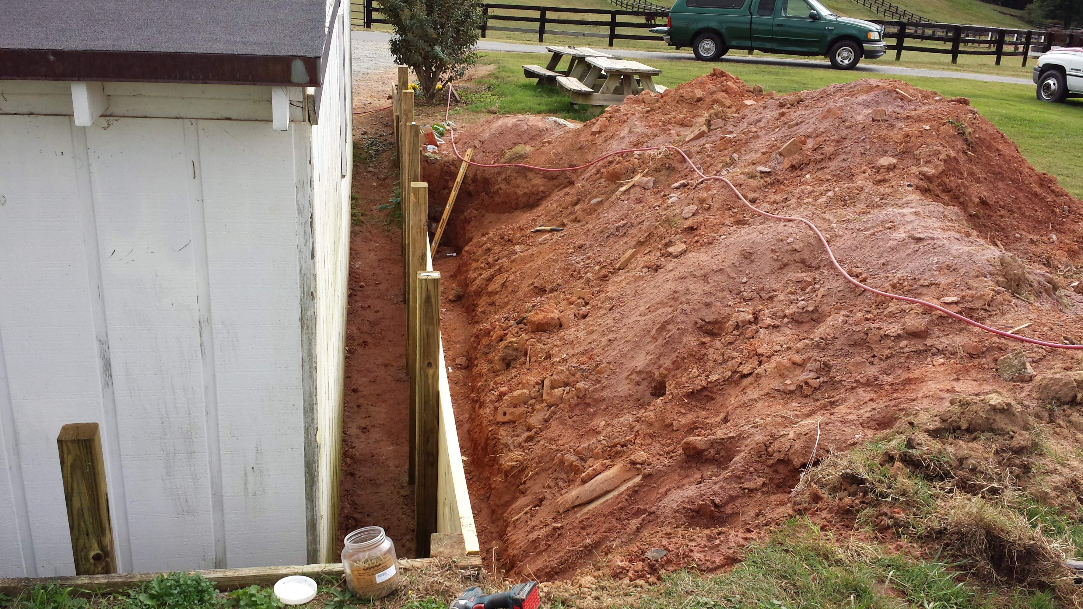

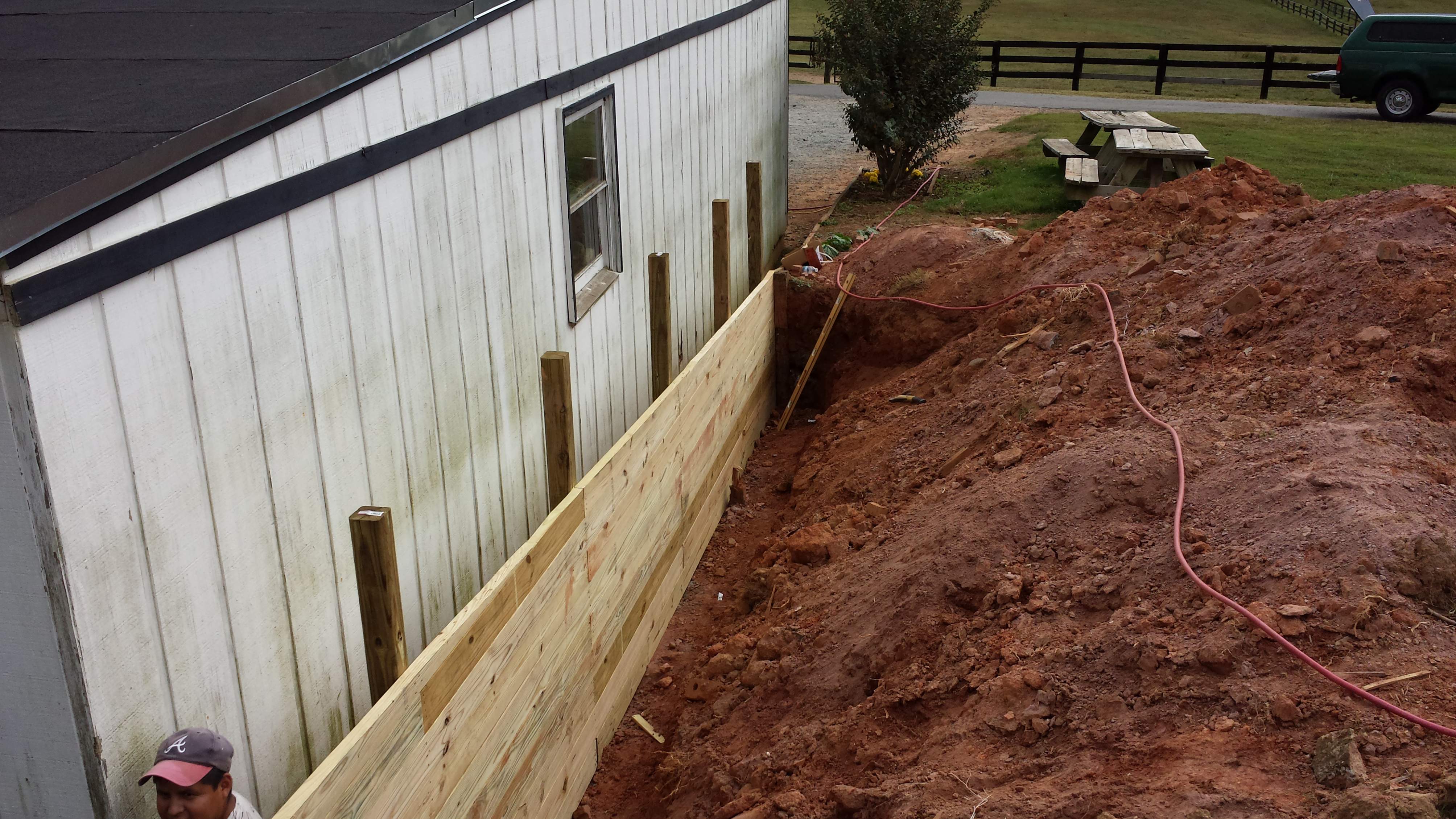

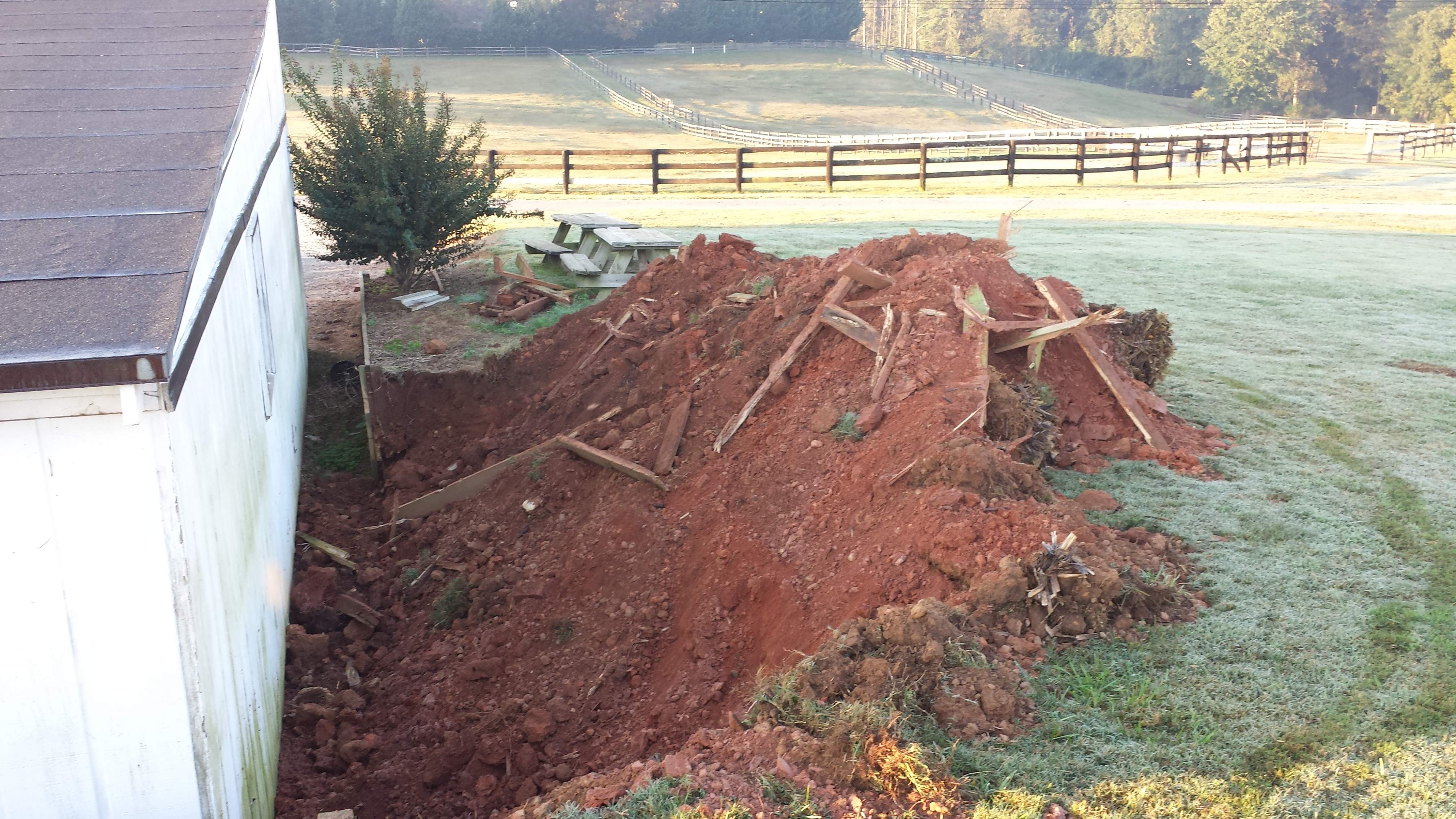

I finally got back to this!
Today I will dig in a couple deadmen and after that comes gravel and the drain.
Thanks for all the advice!
20131002_081218 - Copy.jpg20131012_084326 - Copy.jpg20131014_153427 - Copy.jpg20131014_153505 - Copy.jpg

I dug out the deadmen with the post hole digger and a Collins axe
Deadmen.. Pressure treated 4X4 with 3/8 galvanized bolts.
Detail of deadman and post.

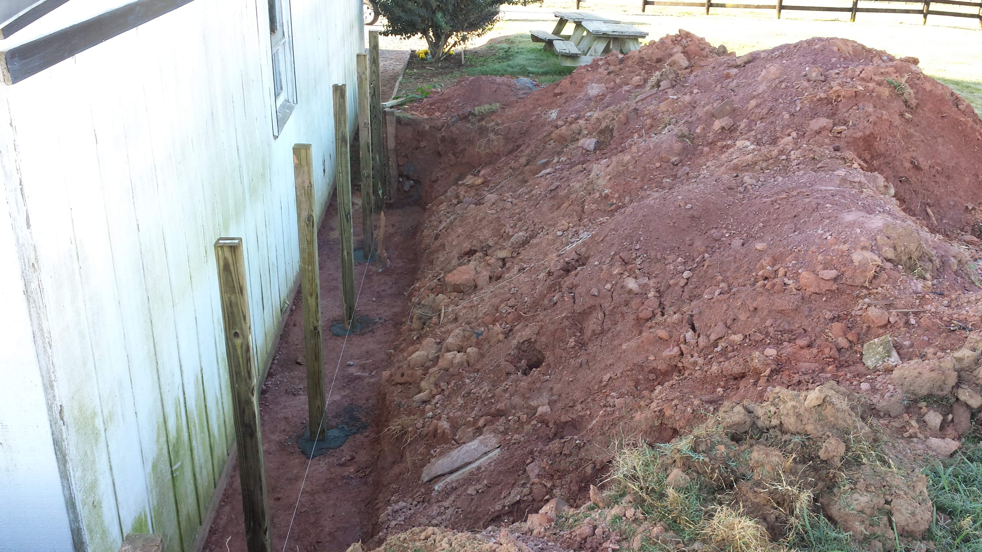

I forgot one.. This is the french drain. It's wrapped in a sock and I dumped about 20 bags of drainage rock on top of it and wrapped it in the landscape cloth. It's situated 2 inches from the wall and staked on both sides to keep the rock from spilling from the top of the drain.
I topped this completely with a shovel and compacted it with a tamper before pulling the stakes. I did the same with the deadmen and tamped them to the point of exhaustion with the back end of the Collins axe.
Then pushed the rest of the dirt with the Kioti.
I'll spread some winter rye later today and trim the posts to complete.
If anyone has criticism lets hear it so the next guy that reads this can look at all options.

I have no experience in retaining walls, but I would think your "deadmen" would have been more effective higher up. This would better help counteract the leverage the soil will have pushing on the wall.
I was thinking that there would not be enough weight on them if they were higher but perhaps they could have been buried just as deep but with the connecting arm at an upward angle, higher on the post?
I'm unsure but what little research I did showed them level and roughly at the depth I have them.
My hope is that someone that does this for a living can clear this up for the next guy that gives this a go.
/ Need to fix a retaining wall #19
Gearhead is right and your thought of angling down from the upper part to the back side of the deadman is correct too...
