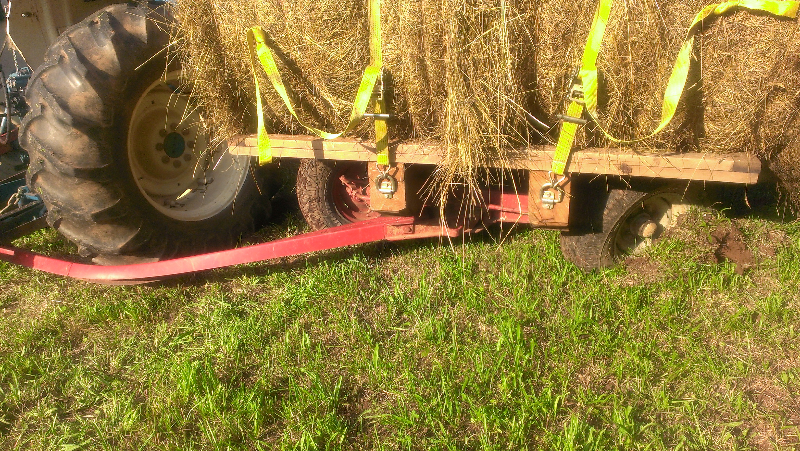

I had a similar incident happen to me this year, only I was hauling hay in from the hayfield. Where I live the terrain is uneven and hilly to say the least. I also had my larger tractor in the shop being worked on so I had decided to haul hay with my mid sized tractor. I started down a hill with 8 rolls on my hay wagon, when I suddenly felt the rear of the tractor lift and I lost all traction. The tractor jackknifed and it messed the frontend of the hay wagon up pretty good. I was lucky that it didn't flip me over. I think at times a lot of farmers get into routine that we do things many times and start to over look the dangers that can occur. ALWAYS take your time and take every measure to do things as safely as you can. And even hauling hay can be just as dangerous as operating a mower on a hillside.

Kind of curious how did a wagon which normally has a tongue that pivots up and down cause the tractor to lift in the rear? I can visualize a trailer doing that.

Even a hay wagon with the tongue that pivots up and down when comming down a hill will can create enough lift on the rear end of a tractor that the tires will lose traction. Now granted I had done this several times before with a larger tractor and I was fine. But this tractor I used here was a ford 5610 that only weighs around 7200lbs and is 2wd. As for strapping hay, I've always strapped hay, square or round. Loading hay once is enough, I certainly don't want to load it twice. Haha

The drawbar can't really generate lift on the drawbar more than a couple hundred pounds. Its just the 2wd tractor wasn't heavy enough for the unbraked load. The big problem is bumping along on a tractor a tire will unweight going over bumps and will skid when a load is pushing you. If one tire has traction while the other is unweighted you quickly start turning without steering.
You can stab the clutch and try to ride it out but you have to be careful as the clutch disc will quickly exceed the rated rpm and blow to pieces if you don't get the transmission into neutral. If you have a foot throttle you can sometimes accelerate and drive your way out of a small one before the full jackknive happens.
All stuff that an inexperienced operator or even someone not expecting it will not be able to do.
We have a very steep hill on the road coming out of our hay fields that grasses over most years. Its jackknived a lot of loads over the years. I always try to use a truck or 4wd tractor and won't let others take loads down. I've been pushed down the hill 3 or 4 times when the dew fell early on a shaded part of it without realizing it.
