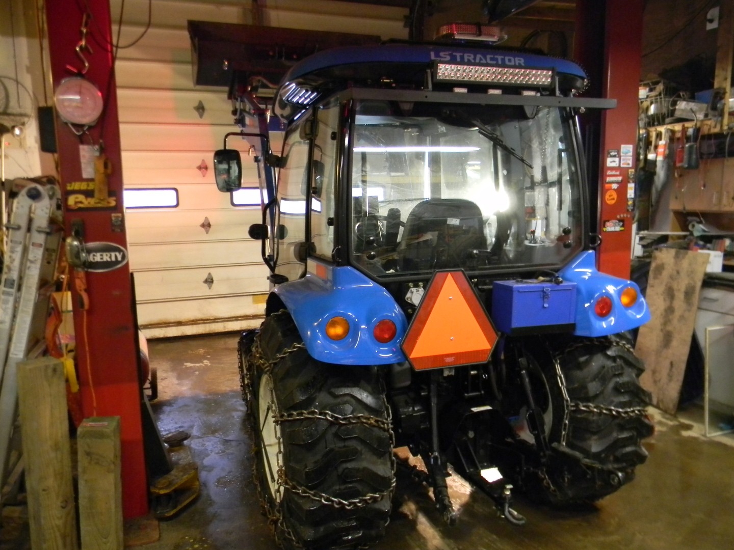

I have a 3520 series that have 15 x 19.5 R4's. I put a set of Aqualine MPC chains on it and they are almost too wide and I cut 3 links off the length.
I know it's a gamble. If you were between here and Buffalo I'd let ya try them on:)

After finding a picture of the chains when I first put them on, (last winter) it appears I've cut at least 6 side links off the chain. Apparently I took 3 off last year and then again cut 3 off this winter.
Here is a picture I took last winter and first put them on the tires. If I zoom in I can count at least 6 extra links. I have to run them skin tight, not much clearance on the inside of the tire or 3pt draft arms

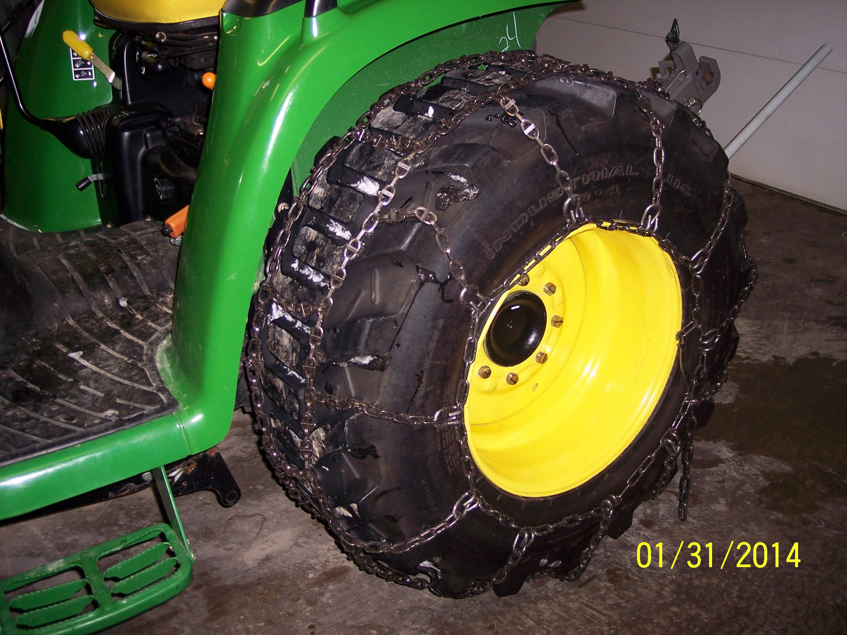

I have the same size 43x16-20 R4's. I did buy 4 link ladder chains and they work well for me. I found a set on sale at my local TSC store (new old stock). They were longer than mine so I cut off the extra length (the width is fine) and saved the extra cross links to use if needed later. The chains I have are Peerless chains made to fit 13.6x28 or 14.9x24. They will fit your tires if you can't find exact fit chains. You just have to cut off the extra with bolt cutters, torch, cutting wheel or whatever.

_MG_5482.jpg i have 2 link ladder chains on my r4's and they grip great....no issues at all.
