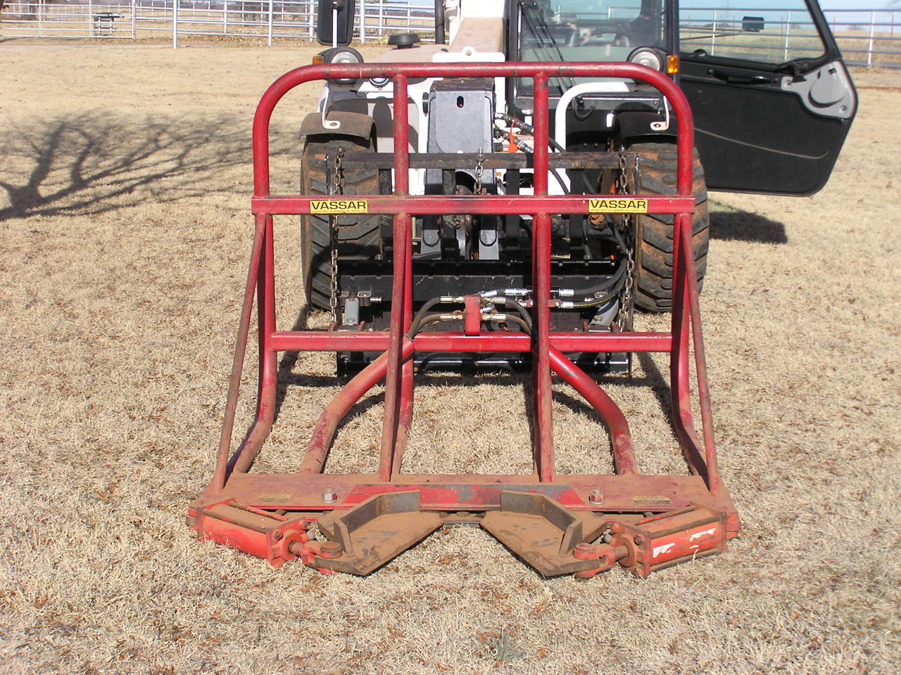

This is an old 3 point cedar tree cutter that I adapted to the SSQA plate. Cedar stumps don't grow back after being cut.

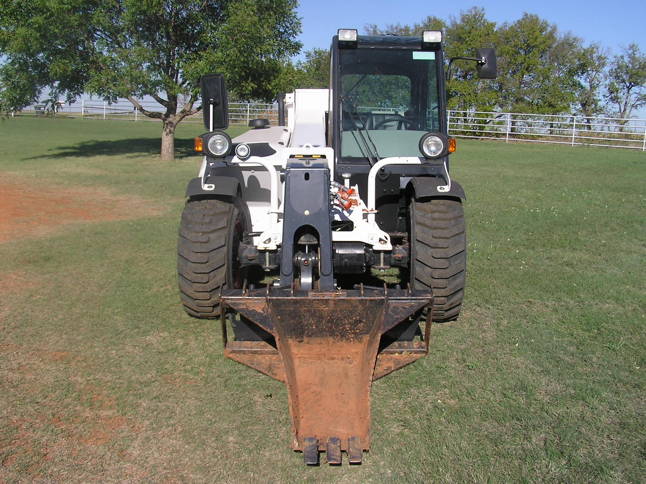

The stump bucket.

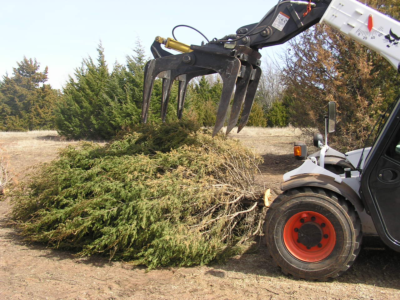

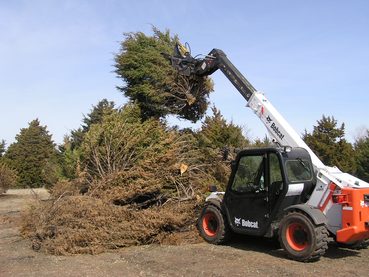

The Gorilla Grapple.

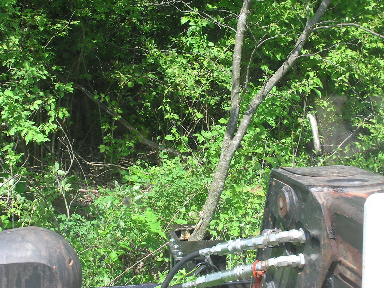

For smaller trees, up to 4", the Long Arm Tree Puller.

As I said earlier, you'll want extra hydraulics on the tractor to run all sorts of attachments as your project grows. Here's another attachment that'll pay for itself pretty quick on your new acreage. It's called a Grapple. You can search on TBN and see all sorts of variations. I built this one one a used Bobcat bucket that I bought. Again, you need 3rd function hydraulics on your loader to run things like this.
