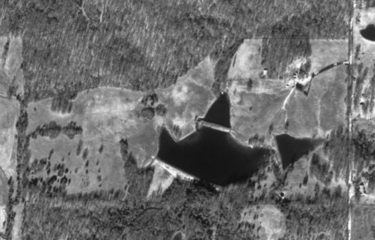

Thanks for the advice. The more I ponder my new situation, the more I believe that I will start adding some trees toward the back of the property. I love to hunt and I would think I could add some saw tooth oaks on the back of the property and plant food plots. I would like to get the land to mow down to the 25-30 acre range. I would prefer to try and limit the hard work and enjoy retirement. If I can post a picture, I will try and show my thoughts.
If you look at the picture, I want to be able to manuver the equipment in some areas that may not handle equipment that is too big. I would likely try to keep the pasture from just to the left of the lakes back towards the road open, and just worry about that for mowing and keeping cleared.
With that in mind, would you think a 40-45 HP tractor would be doable?

   / need suggestions on HP and tractors... #10
<font color="blue"> I love to hunt ...I would prefer to try and limit the hard work and enjoy retirement. </font>
Around here, a ton of alfalfa from the east side of the state runs about $165. Average is 3-4 ton per acre per season.
I'd be willing to bet you could find someone in your area willing to plant that acreage for you, tend it, cut it, and give you a few dollars for the privilage.
Now I've watched alfalfa fields at dusk and it's pretty much "ducks on a pond" for deer and turkey. With those ponds and fields of alfalfa...what was that location again... /forums/images/graemlins/grin.gif
