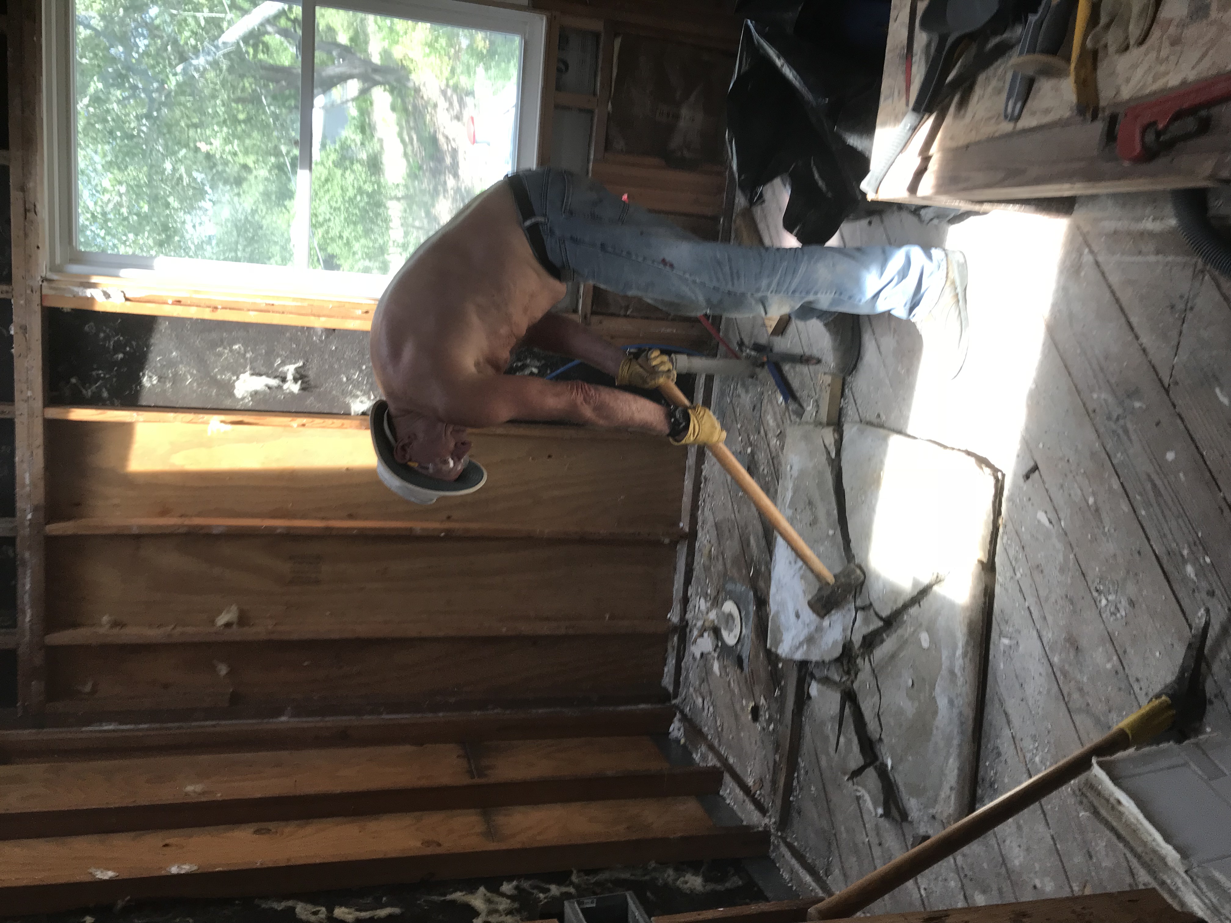

Here is a look at it, I just pulled the shower pan and am breaking it up, but you can see the subfloor...
