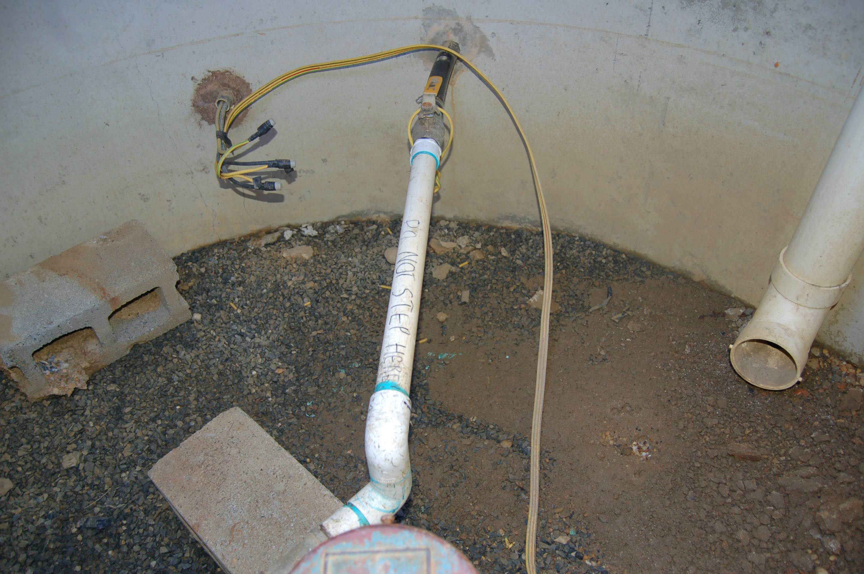

I have a well that is strictly for filling up our pond and Im getting very little water out of it. The well itself is located in a well pit about 30 feet from the pond. The water comes up directly from the well casing into a tee. The one end is capped and the other end goes towards the pond. I turned the valve off (pond side) and opened the cap. It took about 3 minutes to fill a 5 gallon bucket. The pump itself is only a year old (1/2 hp grundfos) and I am getting full voltage at the pump. Also the water coming from the pump is crystal clear. What do you guys think the problem could be? Id like to have a bit of knowledge about it before I call for repairs.

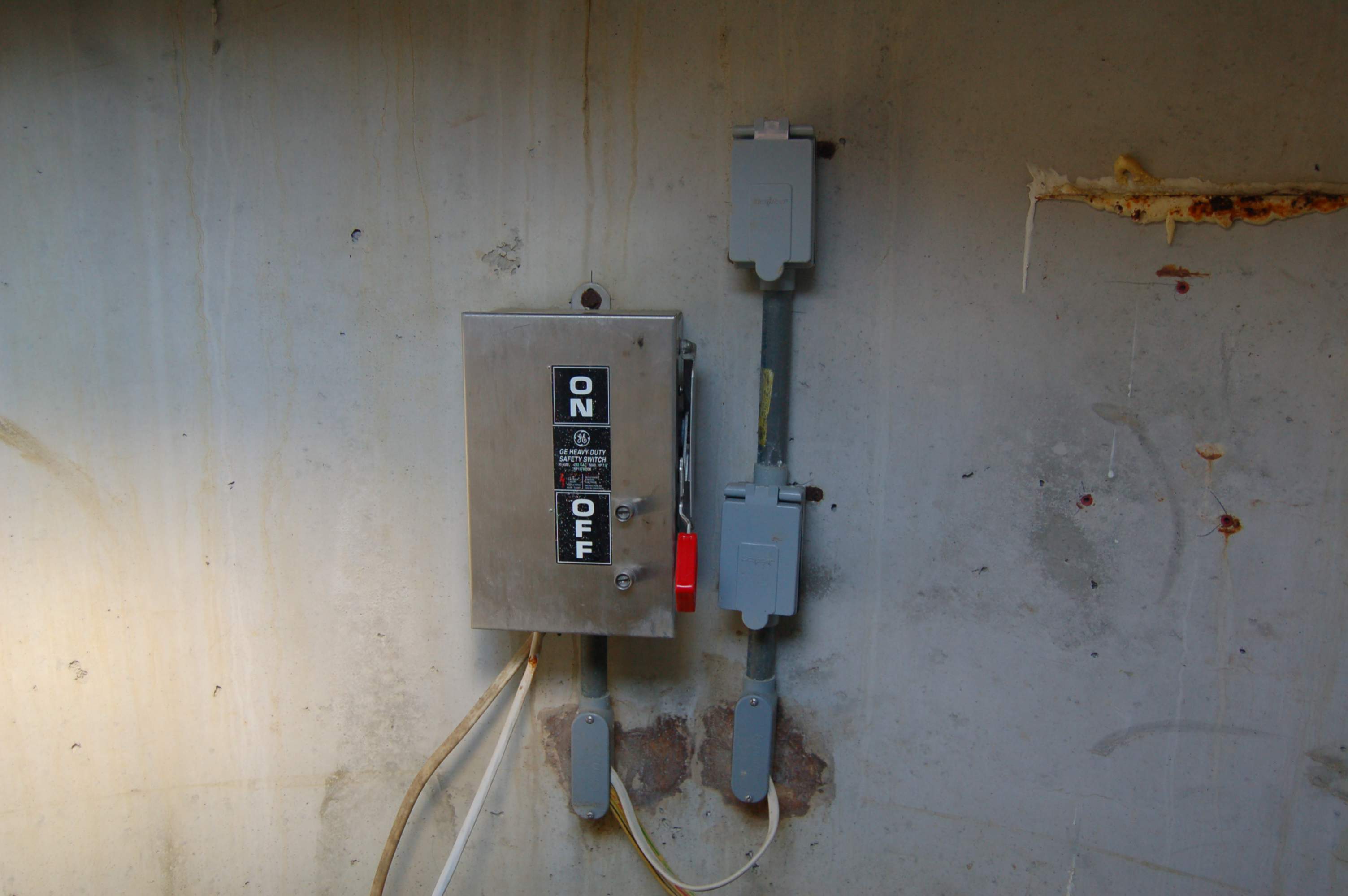

The well is in a pit (upside down septic tank) and the piping is inside. I meant that the water comes up through black abs, then goes through the casing to a tee fitting. One end is capped and the other heads to the pond. The well used to be run with a pressure tank and switch but that has been removed. The well company told me that the pump would fill up the tank and then shut off. Once the tank was empty it would kick on again. Obviously that caused alot of wear and tear on the pump. Now I turn the pump on with an on/off switch in the pit. It takes a day or so to bring the water level up when it is working. The pond holds around a million gallons or so. Ill take a picture of the setup tomorrow.

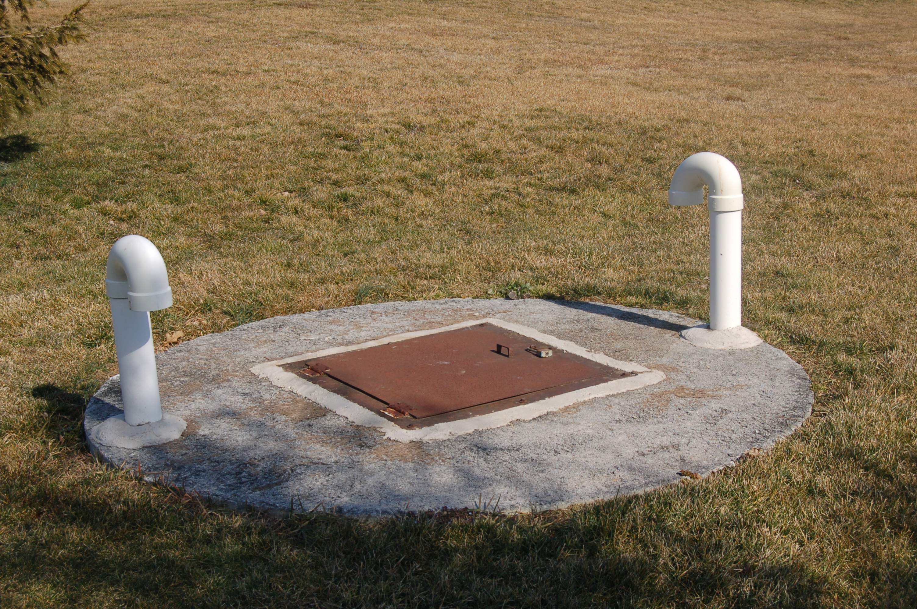

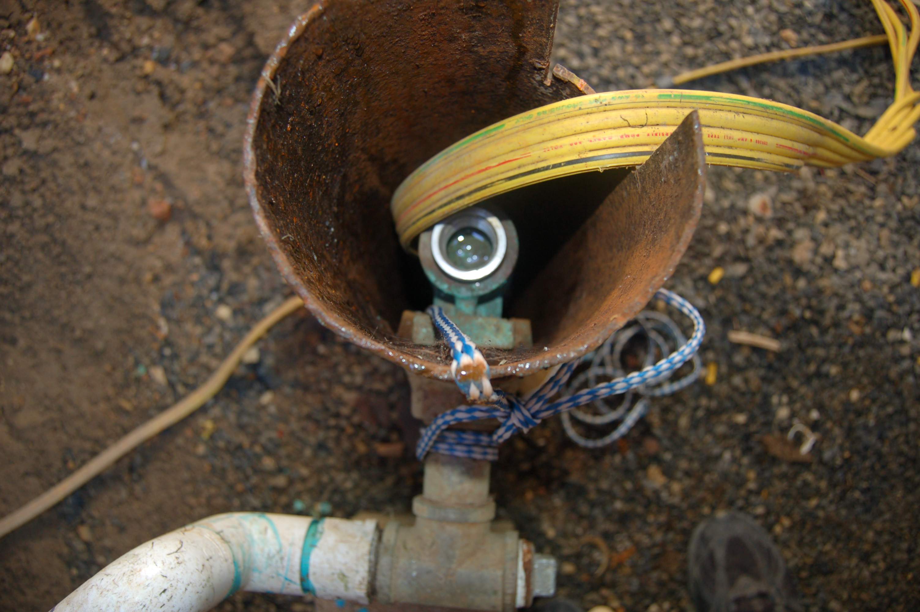

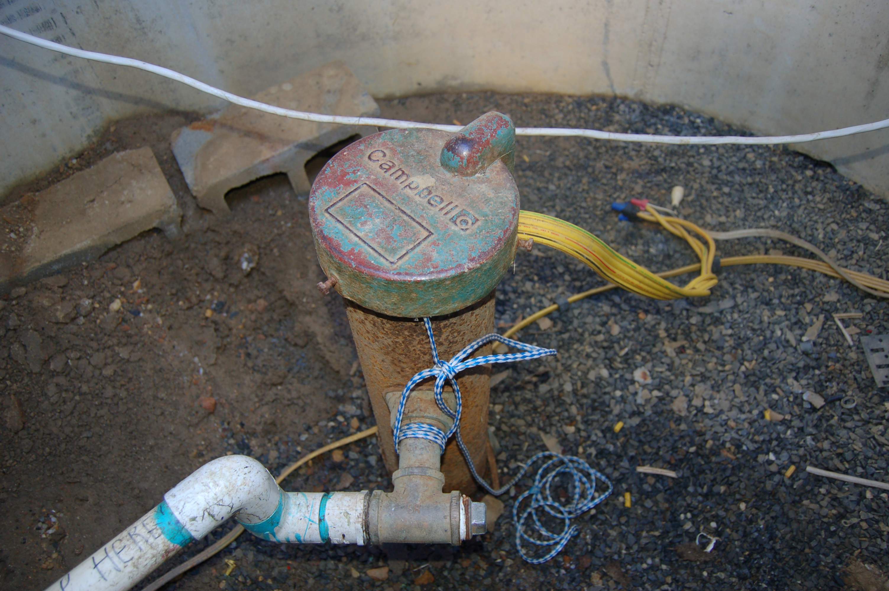

For now here are a few pictures. Meanwhile Im trying to find the paperwork related to the well. The pump should still be under warranty and it sounds like it needs to be pulled.

If the casing has any holes in it, no matter how small, it will affect the ability of the pump to bring up the water.
/ Need some help with a well #14
Suggest checking the electrical cable where it contacts the casing for abrasion. That area should be protected as well as the rope.:)
If the casing has any holes in it,/QUOTE]
Maybe tubing?
/ Need some help with a well #15
I just seen the pictures, you have a deep well with the pump inside the casing, so I deleted the info I gave for a shallow pump set up.

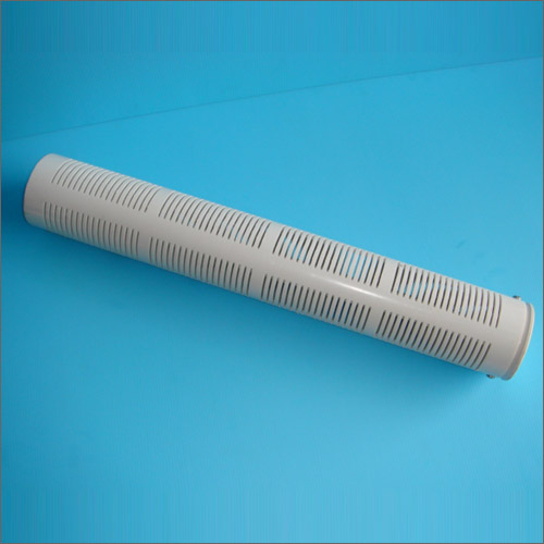

Welp it's working again :thumbsup: The well guy came today as he had an opening. First we checked the water level and it was at 72' and then after the pump turned on it went down to 95'. So we got his t-handle thing and pulled the well up a foot, and sat the pitless adaptor piece on the casing, and tryed it again. It started working again but, the water was very red and murky. Then after running for around 20 minutes it started to clear up.
He then thought it would be a good idea to pull it while he was there so we did. It turns out that the filter sleeve was partially clogged so we cleaned it. After sticking it back in it has been running for around an hour now and the water level is at 77'.
The main problem is that the pump isn't run often enough. He believes that the iron in the well was clogging the filter and preventing the water from entering the well.
#18
This is what the screen looked like except mine is around 5' long...
