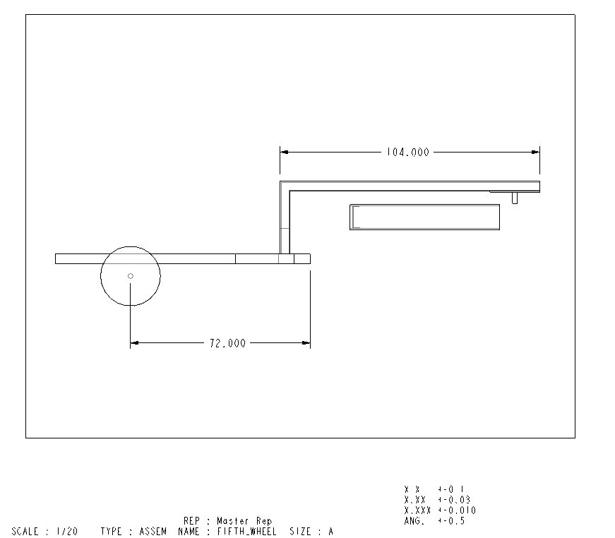

My concern was that from the crossmember I'll be attaching to the top flange of the frame rails I'll be coming back around 18" then coming down about 30" to the ball mount all without any lateral support whatsoever. That just seemed like a long way for 2" tube stock to go with no lateral support.
I agree that Reese uses the same stock but I don't think they go anywhere near that distance with it. As to speedbumps, etc., I think the ball and coupler will more than handle that. I want the fifth wheel hitch assembly to be as stable as possible.
I'm sure I'll get some good input and CAD diagrams on this yet. I'm hoping WHarv can give me something definitive on the material I need (hint, hint /w3tcompact/icons/smile.gif ). Thanks a bunch for all the help thus far everyone. You'll likely never really know how much I really appreciate it. /w3tcompact/icons/smile.gif

I talked with a manufacturer of a dolly who told me the main structure onto which the wheels are mounted is 4" x 4" x 1/4" steel tubing. Armed with that knowledge, the latest incarnation of this plan is to see if I can get them to build me one using that material as stock for the tongue as well. The standard tongue has two bends in it which would need to be replicated. One brings the tongue up from under the front bumper of the towed vehicle up to hitch height and the other goes from that angled section forward to the coupler level parallel with the ground. I'd have to accomplish those two angles by cutting and welding the tube stock.
The stock weighs approximately 1.1 lbs. per linear inch. I'll be adding approximately sixty pounds to the weight of the bare tongue this way. I'd also want to add 12"-18" upright piece near the coupler over which my fifth wheel tongue will attach. That would bring the additional weight to around eighty pounds higher. With that much of a weight addition I'll add a trailer jack.
I'm thinking the 'removable' portion might have to be in as many as three pieces because of the weight. One would come up from the fixed upright on the dolly tongue and include the 90 degree corner and gussets there. Another would have the kingpin and plate for the fifth wheel while a third would be a straight piece connecting the other two and by which length adjustments could be made. I might be able to eliminate this piece and just lengthen the other two if they don't get too heavy.
While I agree I may not want to breakdown/set up the fifth wheel tongue, I don't see how I'll have much of a choice. I can't have the driver tow the dolly with the fifth wheel tongue and kingpin/plate above the car so it has to be able to be turned around to allow it to be towed to the truck. Even if it would be high enough to clear the car top turning a corner would put the kingpin in the other lane (and possibly into someone else's windshield or through their grille). /w3tcompact/icons/hmm.gif
Assuming I've explained the above well enough, please give me your opinion or any other ideas on the plans. Thanks. /w3tcompact/icons/smile.gif

I think you may be able to tow it with the rotating tongue & not hit other cars. See attached pictures. I made some assumptions on dimensions, please correct me if they are wrong.
Dolley w/ tongue in stowed position
   / Need some design help #60
Dolley w/ tongue in towing position.
Here's the procedure for hooking up the semi tractor.
Park dolley in accessable area.
Jack up with tongue jack
Swing fifth wheel tongue around.
Back semi trailer under tongue
lower tongue jack.
