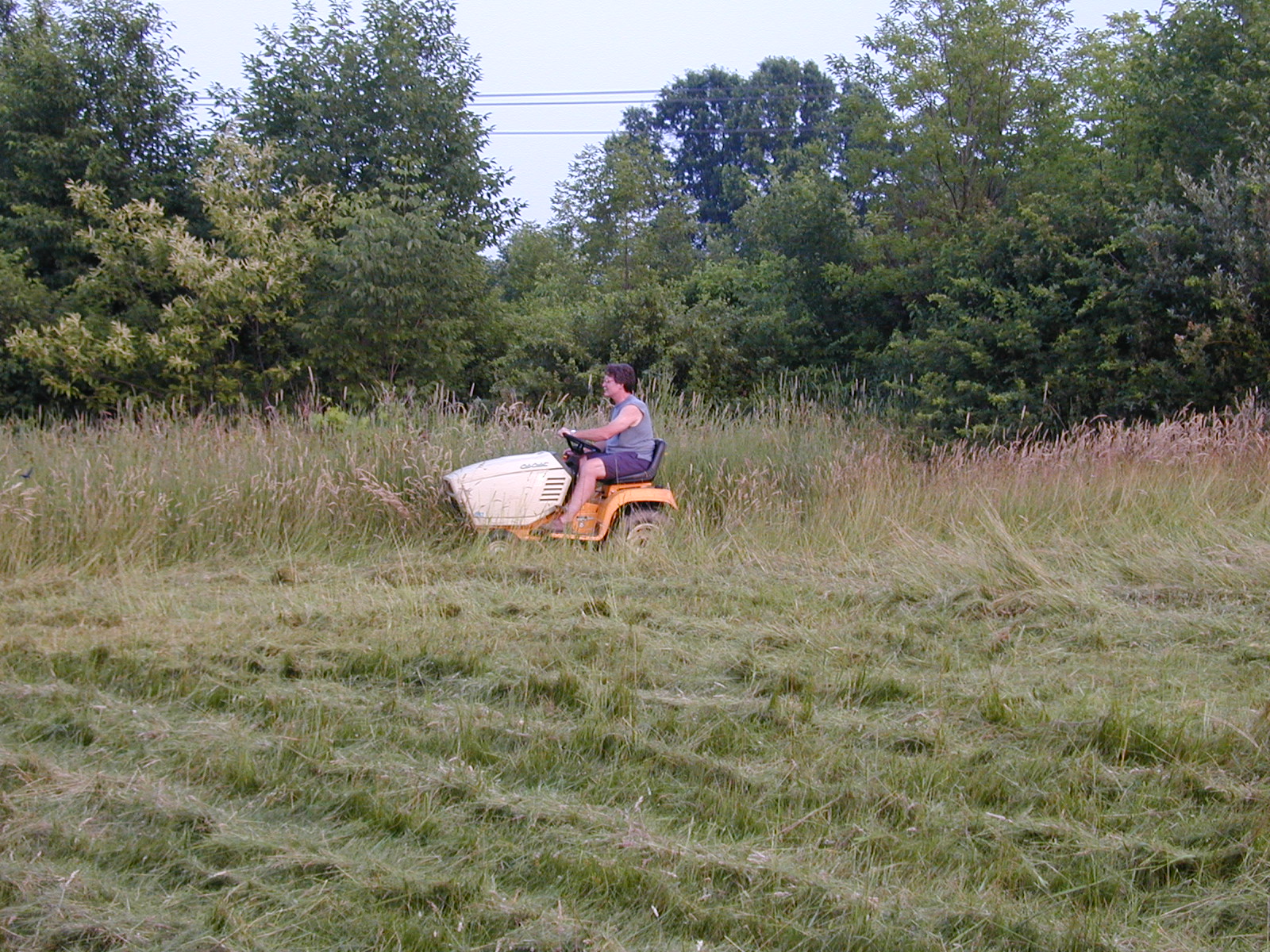

I've done grass that tall with a Cub, if you can just minimize the cut, say 15 to 20 inches width and discharge toward the cleared side, you can regulate the speed with the hydro so it doesn't load too much.
You go back and cut it a few days later to start mulching it up, you can get that done. But an acre and a half, depends on your patience?
Here's a pic of me mowin some pretty tall stuff with an 1862 I owned at one time. I only cleard maybe 1/4 acre, but it worked out just fine.
