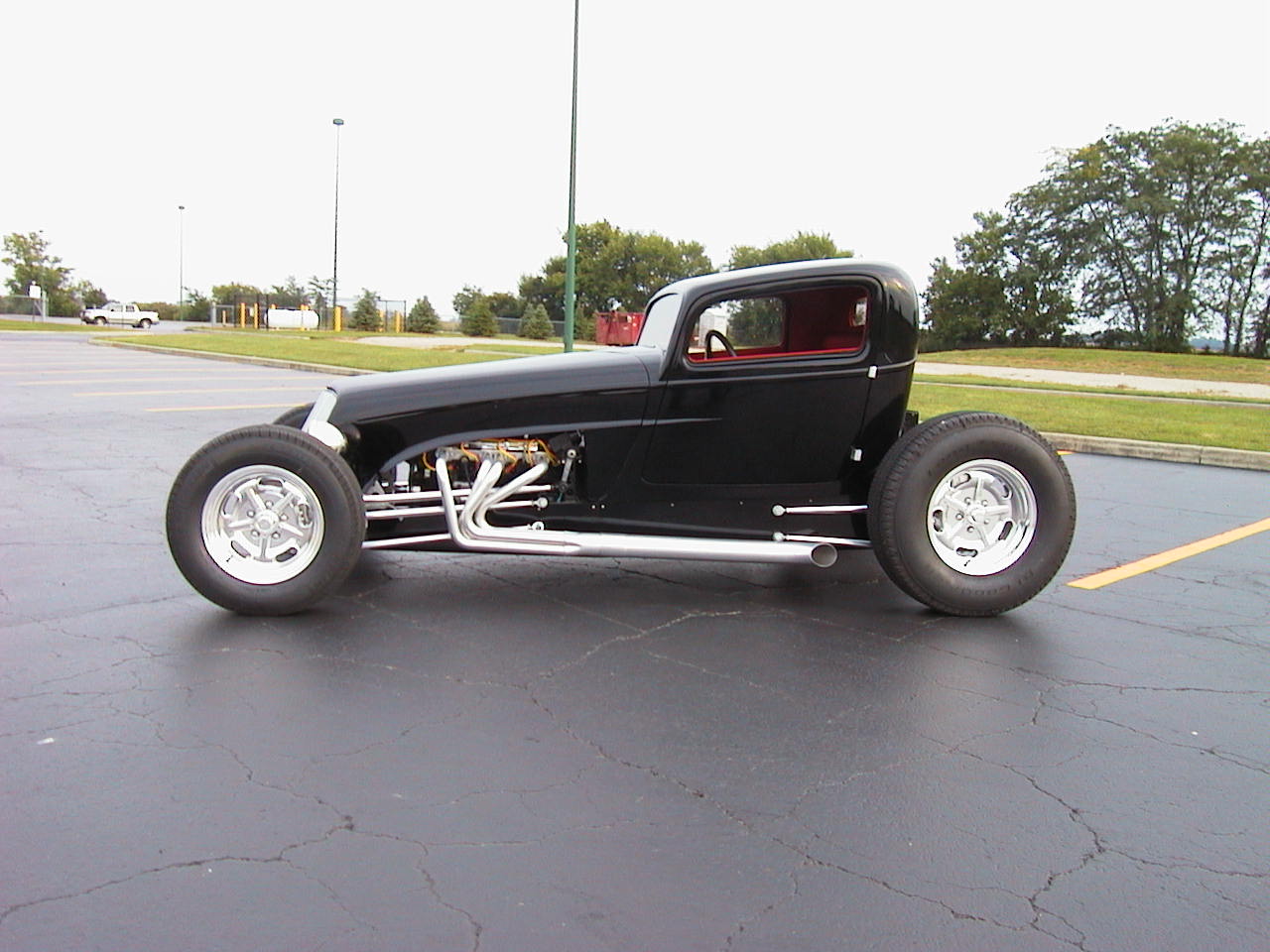

Bill--There is a difference between the largest diameter grease gun head and what is now called the standard head but there used to be a very small diameter slip-on adapter that fit, now tht I remember, between the yokes of a u-joint when tilted and hard to access. I am going to call Lincoln today.
Since you are a car guy, this is for a street rod I just finished and the front king pin grease fittings are recessed just a bit and difficult to access. I am first a tractor guy but here is the car photo...it came out better than I expected. A small head adapter would have many tractor and equipment applications as well.
