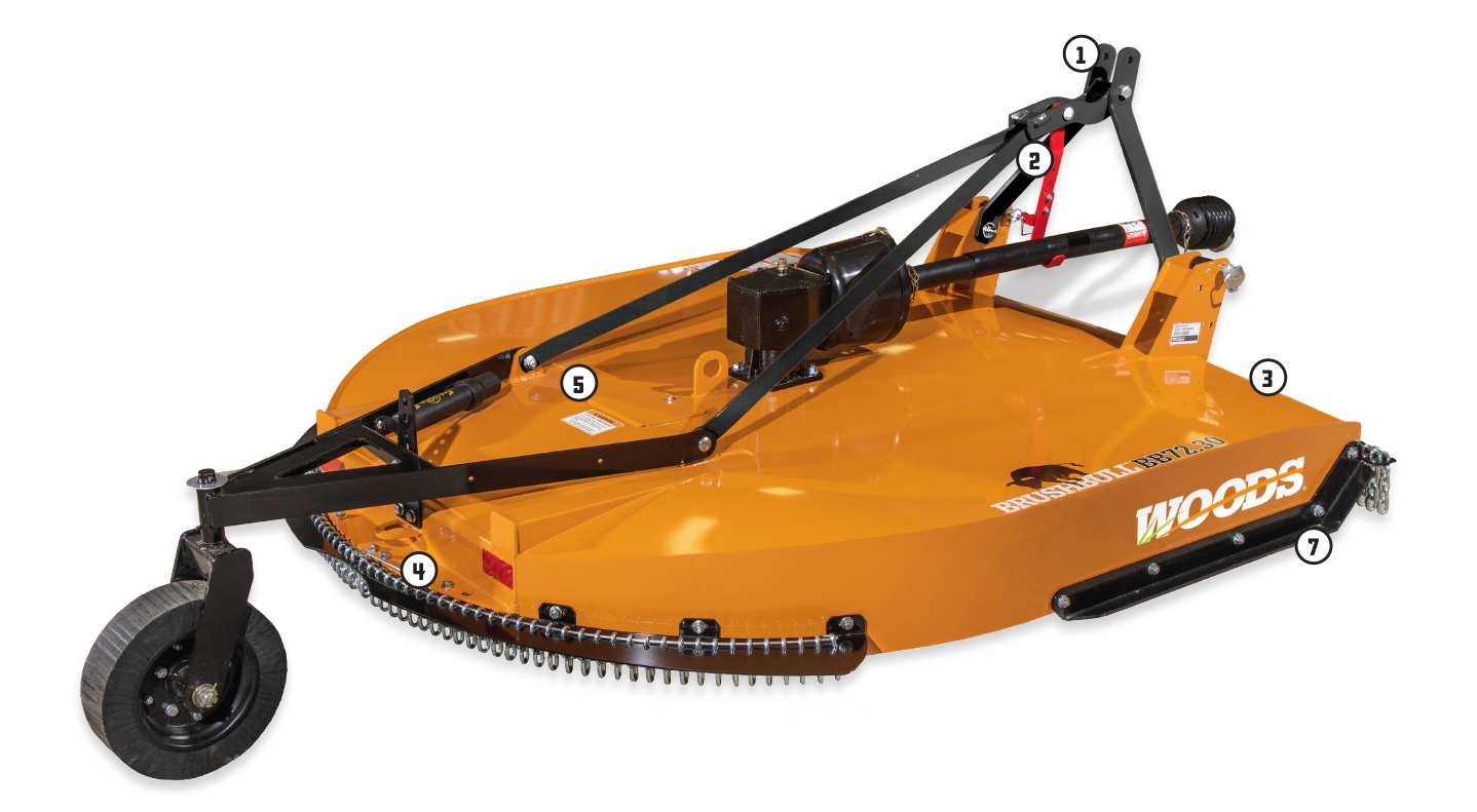

This is a pic of woods brush hog:72 inch
