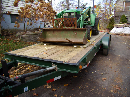

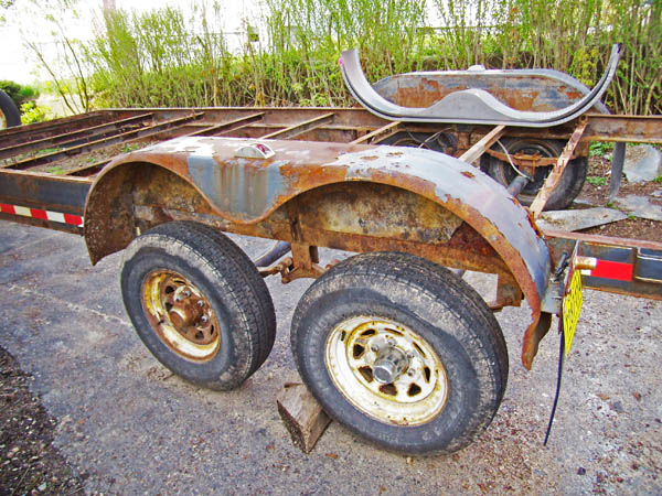

Please note my knowledge of painting is very limited. Mostly Advice of others has been followed. The procedures I followed may/may not be correct.
Last summer I repainted my badly rusted trailer. Used a needle scaler and chipping hammer as well as wire brush to get clean.
Then painted with a solution that contained phosphoric acid and wire brushed clean after dry. Painted with acid and then followed by spray painting two coats of rustoleum paint. Undersides were then sprayed with a mixture of roofing tar and paint thinner. [This part is very messy]
I could not find Phosphoric acid as such but used a Dairy Line cleaning product that did contain phosphoric acid. Twenty dollars for a four liter jug purchased at a Farm Supply Store.
Some pictures attached of before, after Phosphoric acid and painted.
As I am having access problems I'll post and attaqch pictures later.
http://www.tractorbynet.com/forums/trailers-transportation/157838-refurbishing-trailer.html
This thread goes into the trailer and has the pictures.
