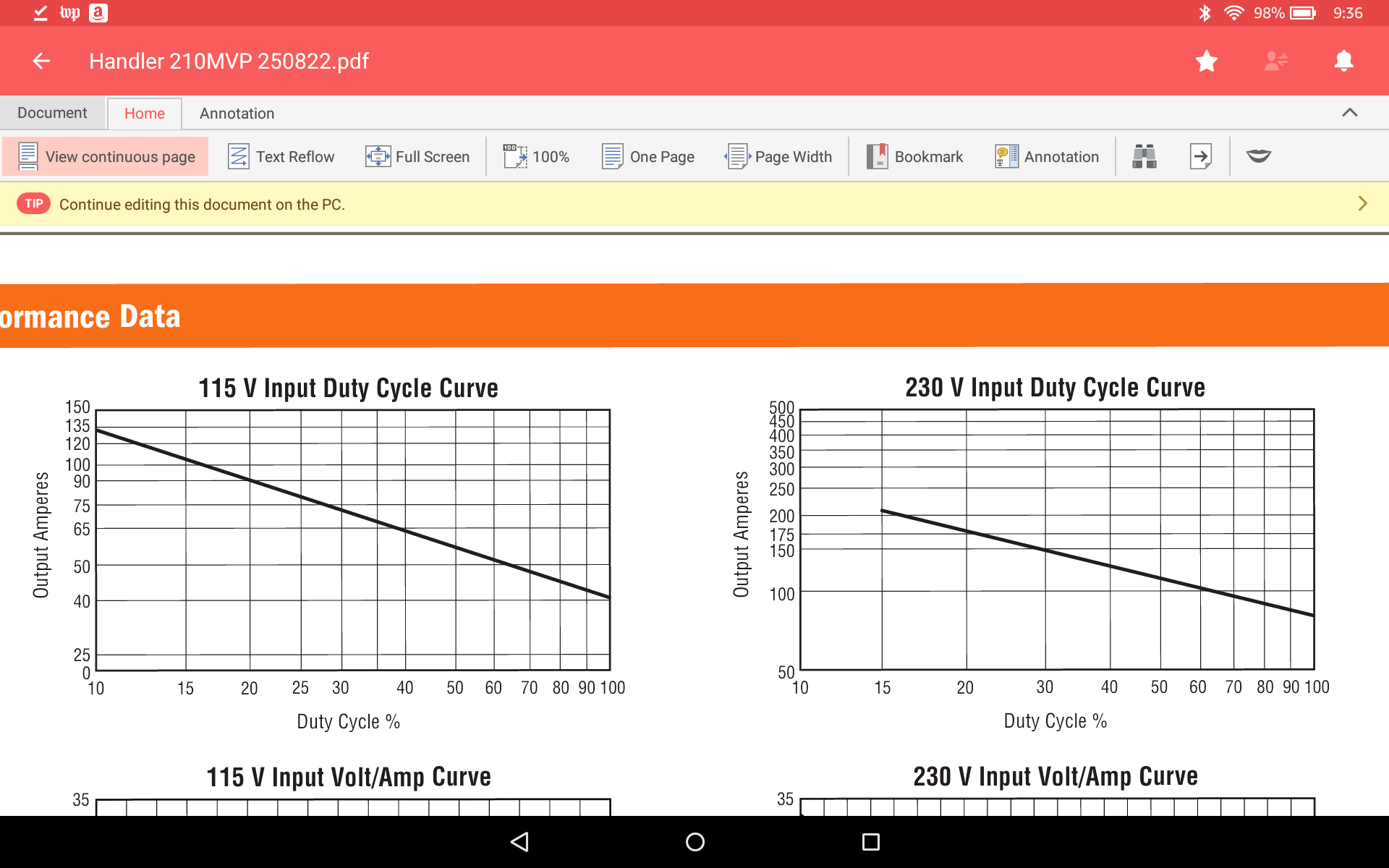

I have a Clarke 130EN mig welder and it has been a great machine for the last 15 + years. But now Im looking for a upgrade. I started thinking I wanted a multiprocess welder, but the prices and reviews werent that good. I have now been thinking for my price range and my needs, a Hobart 210mvp would be good. Anyone have any experience and thoughts about this model? Thanks

Hmm. I thought the prices and reviews on the multiprocess units were all good. Note: The 210 Mvp is really only 150 amps output at 23v. If I were you and wanted a true upgrade, i'd look for a 250amp of some sort. Good Luck in your hunt.
   / Need Mig Upgrade #3
Respectfully, that is misleading.
Although they provided a rating at 150 Amps 30% duty cycle, the max is still 210 amps at 15% duty cycle.
Those numbers are normally at 40°c or 104°f and will be better as the ambient temp decreases.
   / Need Mig Upgrade #4
Lower priced multi-process and multi-voltage units can have the kid in candy store effect on buyers. They do more procceses or run on multi-volts but non as well as single volt input and dedicated process machine. The specs say 20% duty cycle @ 90a on 120v and 30% duty cycle @ 150a on 230v. 90amps isn't going to weld much,esp @ 20% duty. I queston if it's worth being able to run off 120 volts when that's all the power available. And that's on a 20 amp outlet so even less on a 15 amp. For less money you can buy a 190 Handler that come's close or for a little more than the 210MVP,you can have an Ironman which is a hoss. Do you not have 220 available most of the time?

A friend bought a MVP about a month ago with spool gun and cart. We hooked it up and ran .030, 035 and 035 Aluminum on 230v & 50 amp breaker. We put DC tongs on the ground cable and we could only get 151 amps output. that's what I based my post on. I don't think there is an issue with the machine.. Not exactly sure why we couldn't get to the 200 amp output.
