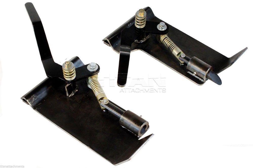

Hello,
I am gathering all the parts to build a Skid Steer Quick Attach for the loader on my McCormick GX45. I found the latch parts (latch handles, locking pins, springs) in my price range and purchased them. The parts are for Bush Hog SSQA's that fit Bush Hog models M246, M346, M446, M546, and M300 loaders. What I need is the measurements for the pivot pin that the latching handles pivot on, so that I can weld the pivot on my adapter in the correct location. I would need the distance from the center of the pivot down to the bottom of the adapter, where it would contact an implement. Any pictures would also be appreciated.
Thanks,
Mark
   / Need measurement on Bush Hog Loader SSQA models M246, M346, M446, M556, or M300 #2
Is this what you are building? https://store.germanbliss.com/bush-...teer-quick-attach-assembly-p-n-50100767-parts
The important thing is that the rod pushing down on the latch pin goes over center, when the handle is all the way down.
Read this thread: http://www.tractorbynet.com/forums/attachments/270316-quick-attach-conversion-kit-need-2.html
