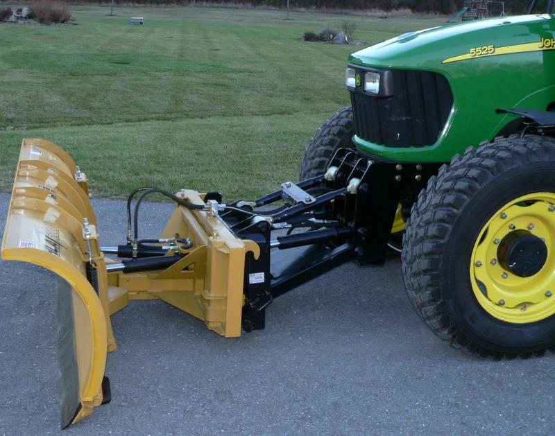

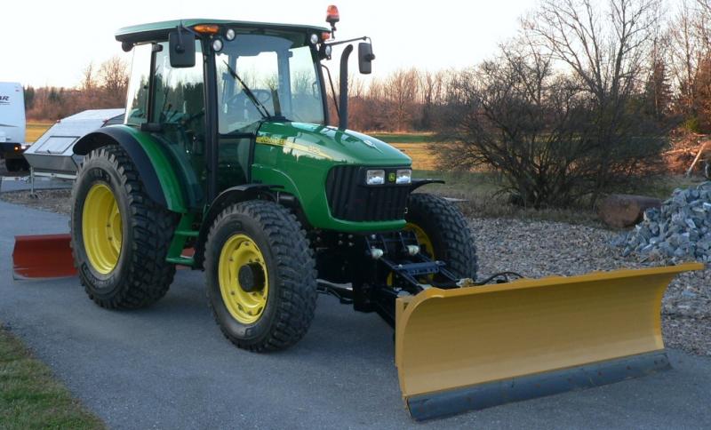

I have a M5400, (50Hp with a 8' modified fisher plow on the front) Email me for additional photos. I welded two 3 hole brackets to the fork lift frame (the mating pair to the fisher setup) and I pull the forks off in the winter and add the plow. The biggest cost was the hydraulic lines to control the plow. I can plow the snow 10' high at the end of the driveway with this setup. The tractor is just heavy enough at full tilt to no slide with a 8' blade.
i have done 16" wet snowfalls in NH with no issues.
Plow $50
Hydraulics (~$250)
Welding free
Paint ~$25
-Design

/ Need input on snowplow #26
Additional photo
