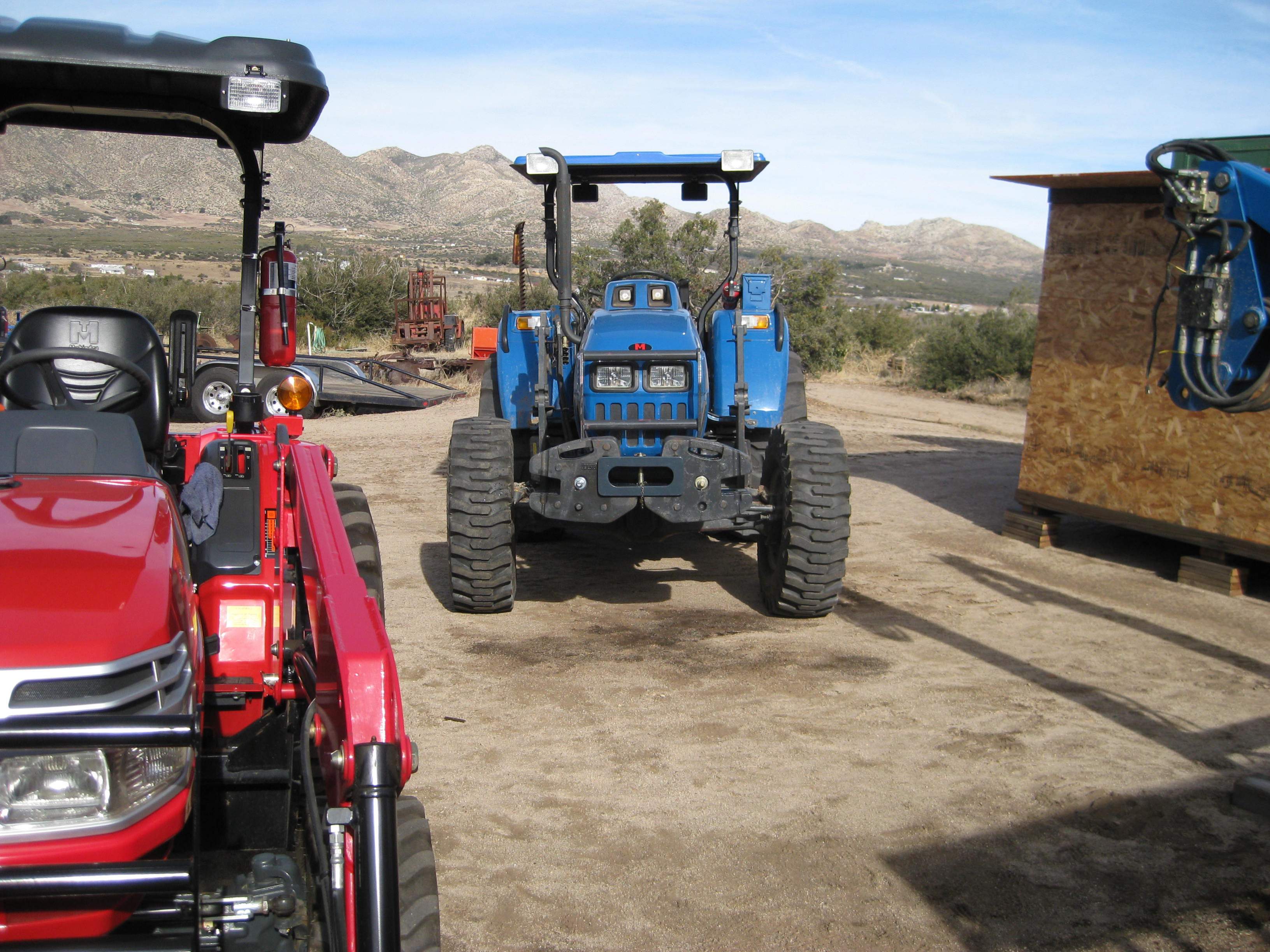

I just have to weigh in here. I feel that there is a big difference with how these tractors ride. I have a 12,000lb 75hp tractor and a 5000lb 32hp tractor. It was huge difference, day and night IMO after I filled the tires, all 4 tires of each tractor. While both tractors ride relatively good IMO, the ride of the larger tractor is by far better than the smaller one.
One other thing, again just my opinion, out in the open field my larger tractor is FAR more comfortable to operate with the loader off of the tractor. I can't say about the smaller unit, I don't use it out on the field.
Just my :2cents: based on what I have and do with them.

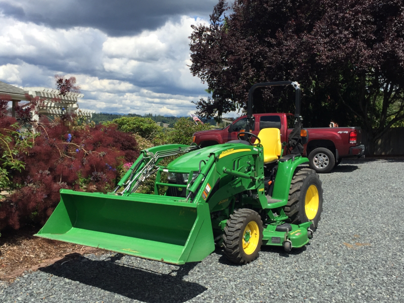

Well, based on this thread and a couple of test drives on a dealer lot, I added a used 3039r. About a 100 hours Love it. Ride is better and the power handles a 6' hog well. It is more stable than the 2305, which I kept for the yard near the house
