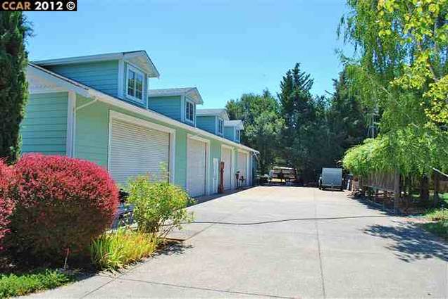

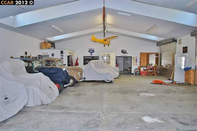

Back in 2012 I posted pictures of a place I had made an offer on...
Nothing before or since has come close to checking all the boxes for me...
A huge part of that aside from location was the 40 x 96 finished shop...
Since then... this is the size I have been fixated on...
