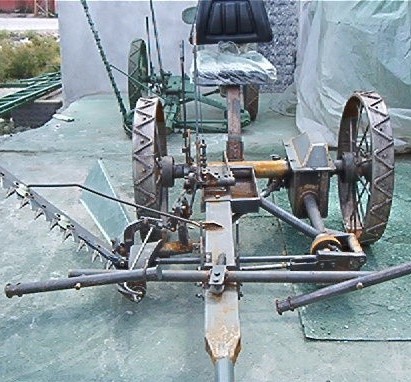

I have finally found a John Deere 350 sickle bar mower 7ft it is in outstanding shape. Asking price is $1200. Help needed. Is this sickle bar mower too large for my B7800 4wd 30HP kubota? I am unable to locate any information on the mower from John Deere such as wait and recommended HP. All posting will be appreciated. Need to know what you think soon for it will not last. [/list]

Don't know if this will help you, but I have a Haban Sickle Bar mower on my Bolens Garden Tractor that is 54" and the tractor weighs less than 1200 pounds and is a 20 HP Gas job. I think that if you can modify it to fit, it will work... the sickle bar mowers aren't that heavy..... if not, if the price is good, then you can always resell it. I have learned that if you hesitate too long, you can repent in liesure......
   / Need Help #3
Ah, finally I have something I know about:
Many Many years ago, I had a JD model M that came with a 7' sickle mower. It was all the tractor could do to run it, especially in grass.
What I did was cut 12" off the end of the sickle bar, and cut the sickle to match. Easy to do with a torch. Remounted the "end pieces". Had to drill a couple of holes as I recall, but that was a nothing.
Ended up with a 6' mower that worked great! If you get a good deal on the 7', try it; worst case you can make a 6'!
Enjoy,
Ron

Fisherman, you were asking for info on KD101 at Agri-Supply a week ago or two. What happened? Have you got any info on it? If I'm not wrong, this KD101 a 6 ft mower and it has a hydraulic lift (optional) and I guess it looks like this (see picture attached.) This 6 ft mower I own works with 30 HP without any problem. So, I am almost sure that you will have no problem with that JD 7' mower. If you still face any problem, just remove some knive to reduce it to 6 ft. So, I say go for it 7 ft mower - you may buy a bigger tractor in the future, who knows.

By the way, I just wanted to show you another sickle mower. (see attachment) - A reproduction. New!!. Really. lol

I think it is to big!!! those were built for the older 30,40 to fifty plus horsepower tractors that weighed a lot more then your tractor.

By the way, an interesting thing you mentioned. If this old horse driven sickle bar mower can be pulled by 2 Horses (by 2 HP as you said), why 30 HP is required to pull a tractor driven sickle bar mower with almost same sickle bar length? Here is a contradiction or not? One requires 2 HP and the similar one requires 30 HP!!
