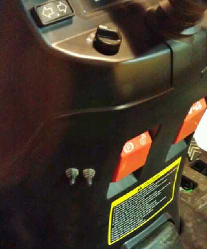

In the hopes this will give you some other ideas, here's where I put mine. The location has worked well and I've never hit them by accident with my left leg or when getting on or off.
Both switches are DPDT with center off. One gives me high and low power of the LED warning lights when I plow snow or transport on the road. (The LEDs are far too bright on the high setting for use at night and are blinding.) The other turns on the front upper ROPS light when bucket loading, and the front and rear when plowing. Both of these are also extremely bright LED fixtures.
FWIW, I initially wanted to use JD's rear lighting wiring that's being discussed. But it only operated in certain switch modes, so I wired and fused separate circuits the way I wanted.
